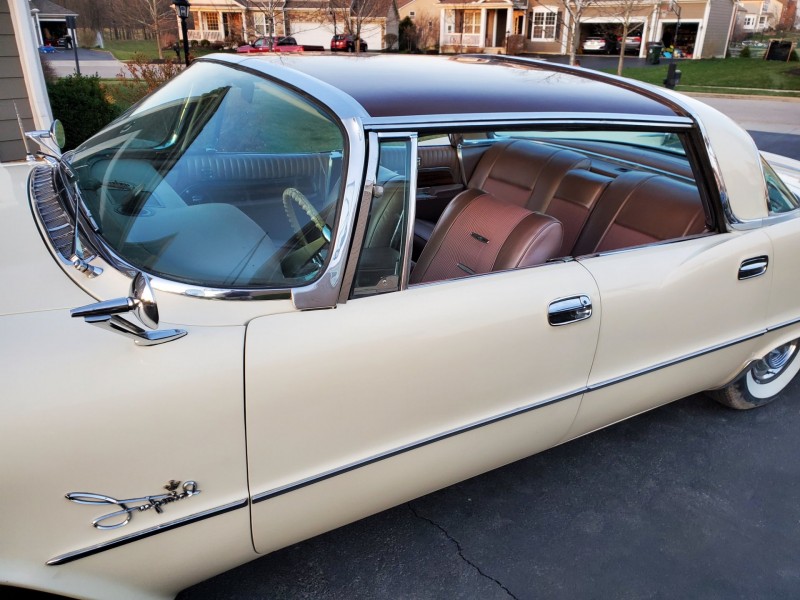

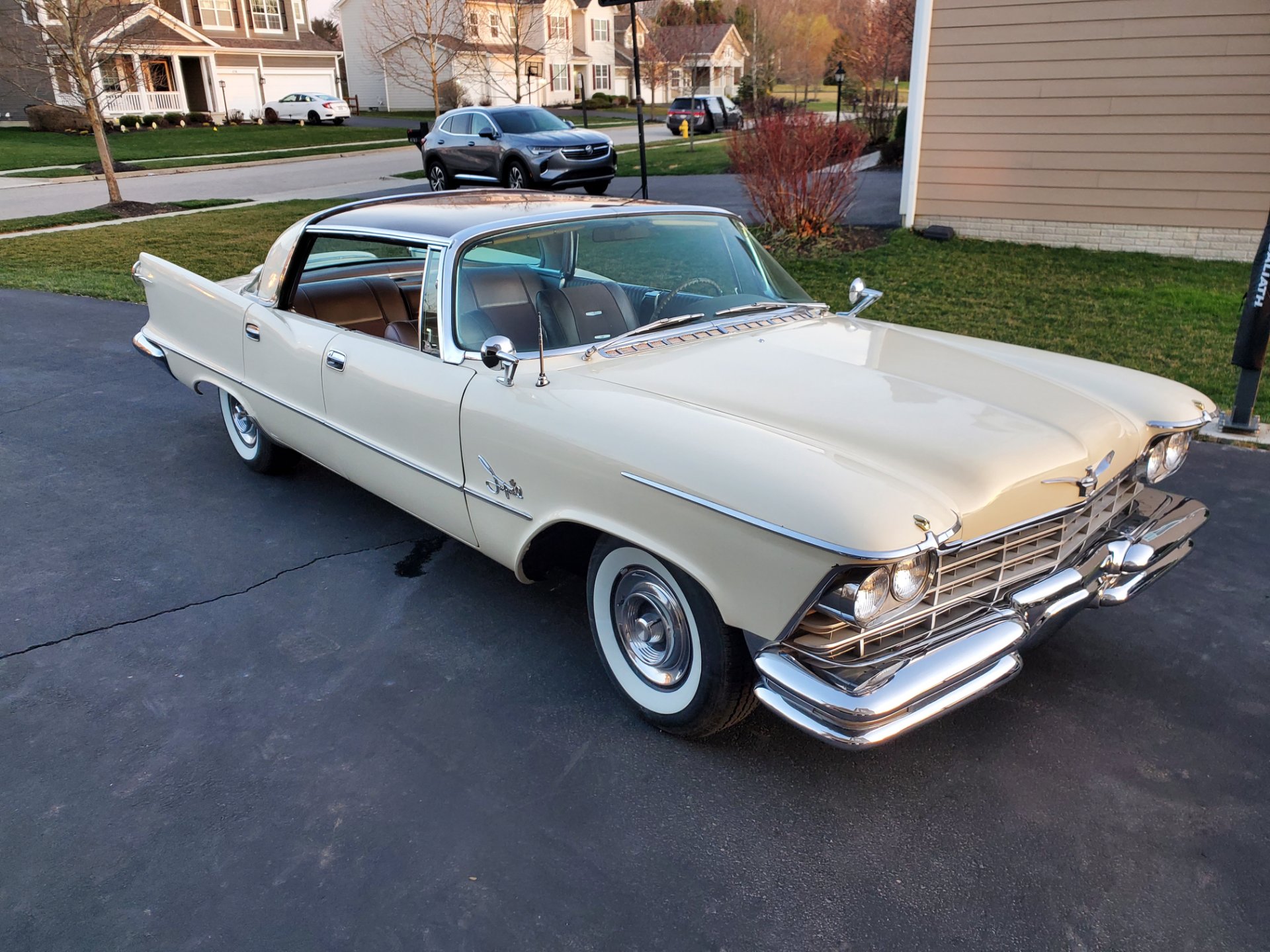

Got her outside and washed down. Still need a good wax, but the two years worth of crud is off of it now. Just seeing it again all cleaned up brings a smile to my face again. :)

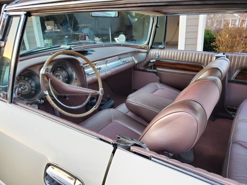

very nice , like the interior
