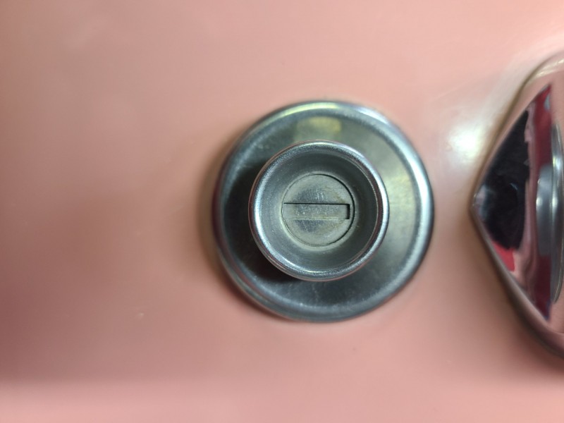

If anyone has access to a 1956 I would appreciate some help. My newest one arrived with no keys and a trunk that seems stuck down. The key slot is VERTICAL and acts like it is unlocking but the lid does not budge. I THINK the rubber has stick it to the body and needs only some help. However I do not want to bust the lock or such, and I THINK when locked the key slot is horizontal. Can anyone confirm this for me?

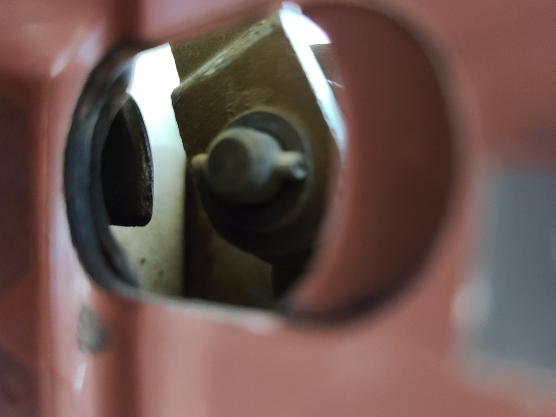

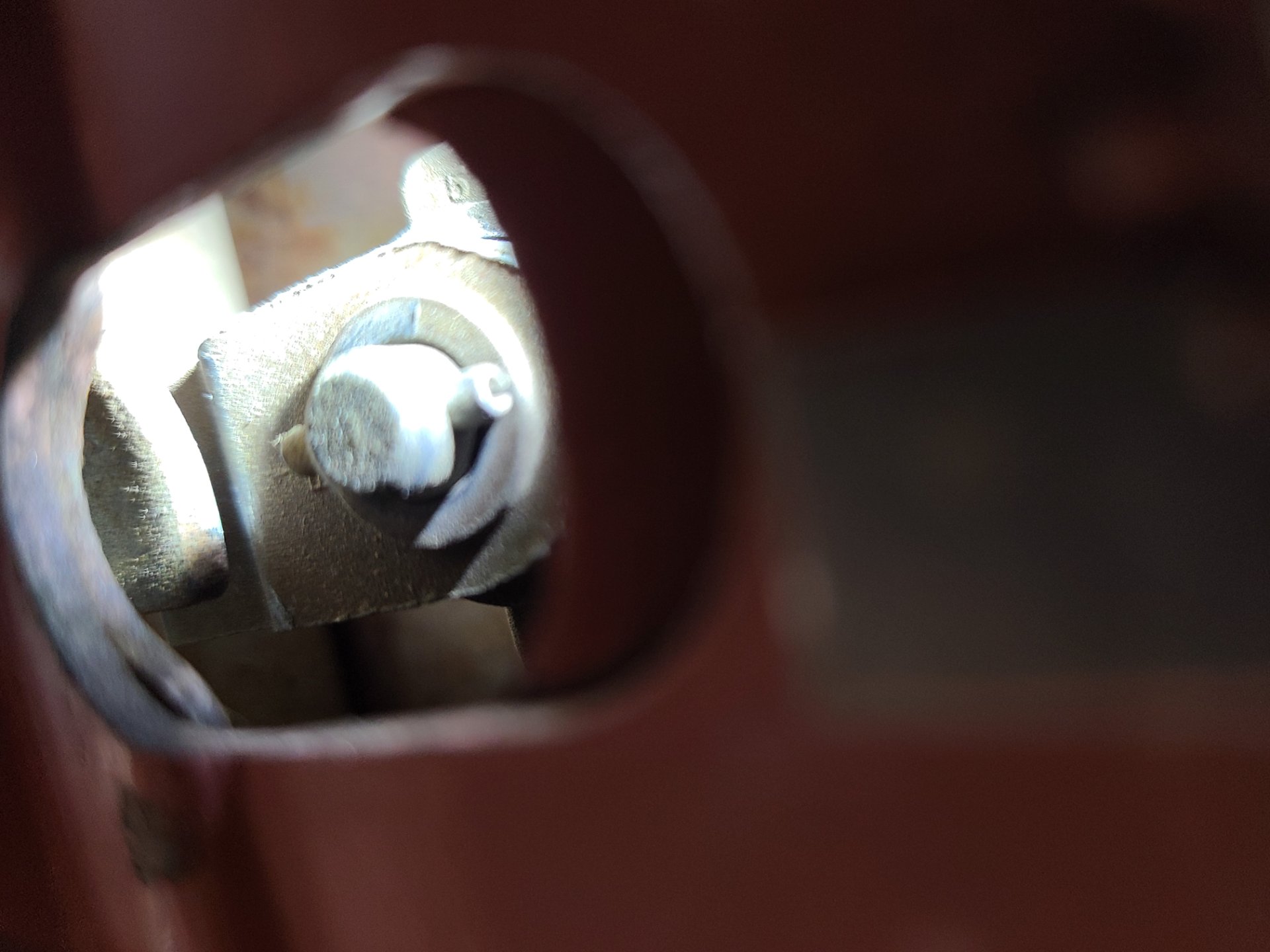

Re: Help Needed
Hey Don. Sorry I didn't see your post earlier. The key slot is always vertical and the button can be pushed at any time. If it is locked, the key has to turn clockwise 360 degrees to unlock the latch. The button has a tab that pushes on another tab on the latch to open the trunk. The key just moves the tab to a position where it will miss the tab on the latch when the button is pushed. I'll attach some pictures. Kinda hard to get a good shot in there. I guess all my pictures are going to be sideways because I'm not smart enough to know how to fix it, sorry. The bottom of the picture is on the left.
Re: Help Needed
Wow that is most helpful!! I would have not figured that out even with a key! To turn 360 degrees to lock or unlock is indeed strange! I have the glove compartment lock at a locksmith making a key that will fit the trunk, should work.

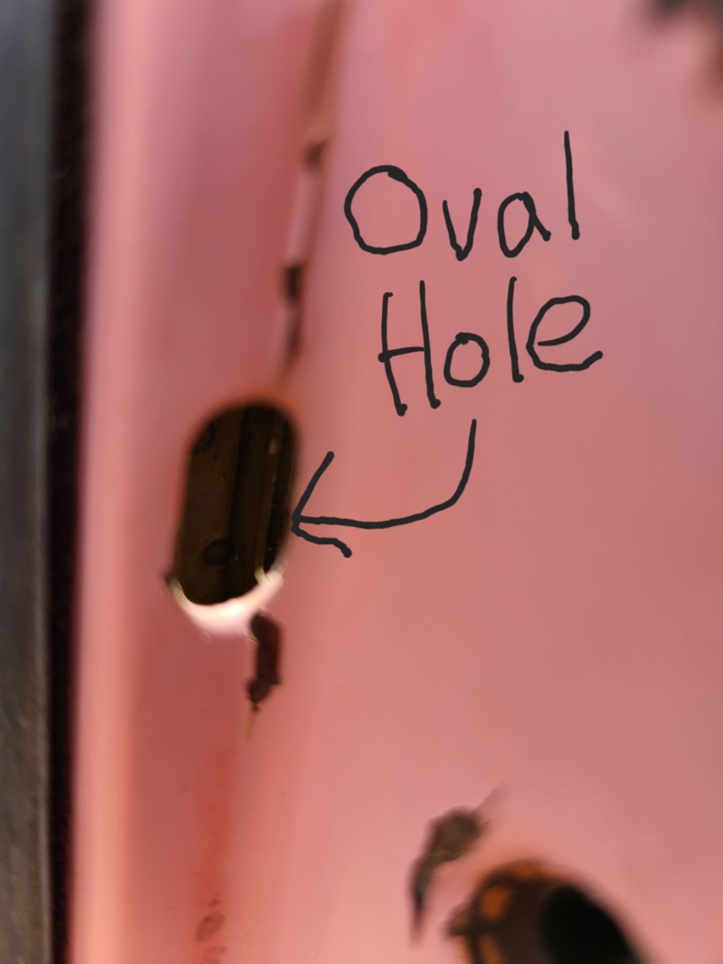

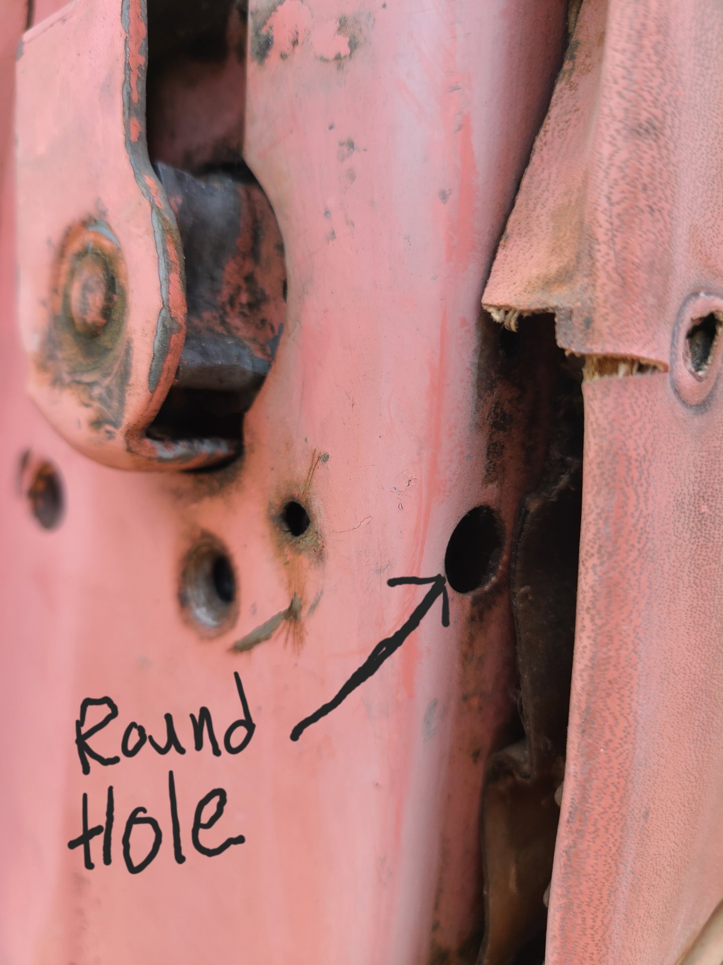

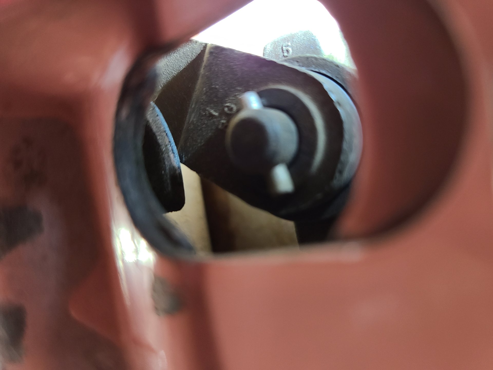

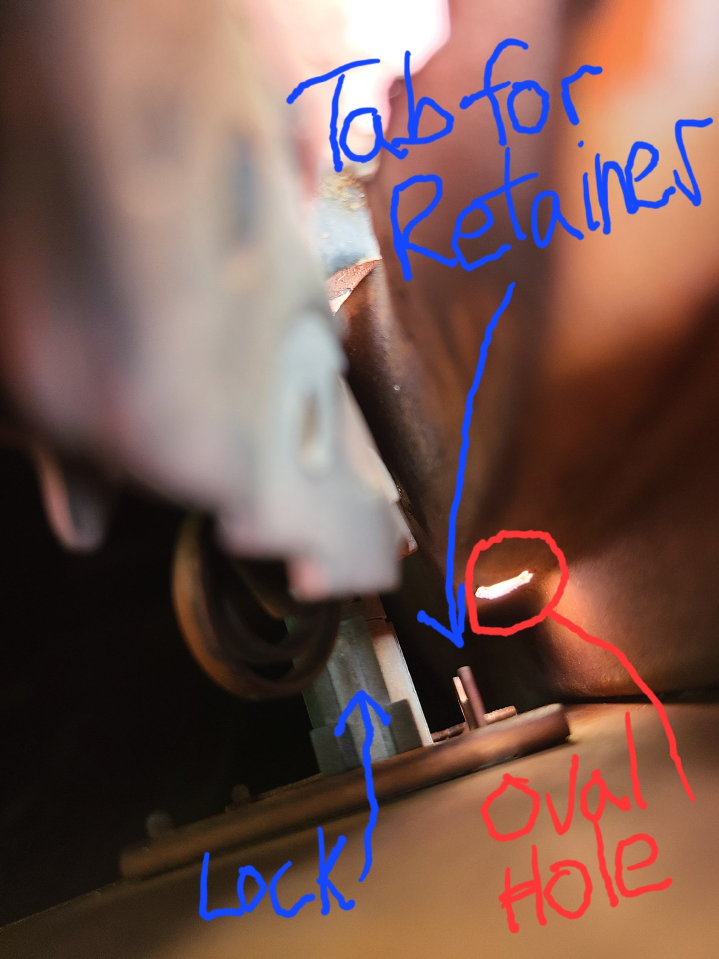

Re: Help Needed
There is an oval hole in the door near the weather strip, at the same height as the lock. If you can get a screwdriver in there at a pretty good angle to the front of the door you can catch the lip on the retainer for the lock. It would probably help if the tool had a hook on it but I didn't have anything like that with me. The retainer is probably stuck after all these years but it will need to move towards the rear edge of the door and the lock should come right out. Getting it back in, a person needs to access the round hole in the door straight in from the lock. Then a scribe or something similar can be used to guide the lock rod back into the correct spot. Sounds easy but it can be a bit of a character building experience. I have a couple pictures but I'm now realizing they aren't as good as I initially thought. I also marked them up a bit, I'm not very artistic but hopefully it will help explain what is going on. The outside door handle is missing so one picture was taken looking down through that hole. I will attach them though. Thinking of door handles, there is a special tool for removing the inside door handle. I don't have one but managed to get a very thin bottle opener in there to get the handle to come off. Not the greatest deal but it worked. Hopefully this helps. I'm mowing at another property in another county most of the weekend but will check back when I can to see how you came out. I also have a gas tank story when I have some time to post it. Getting a good radiator and time to get it all back together is holding me up now.
