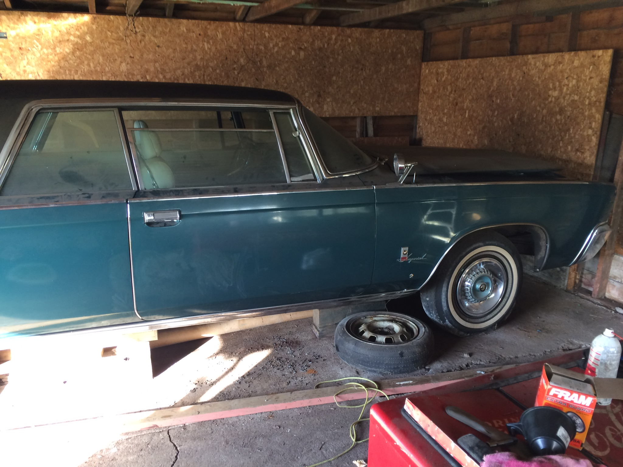

I Think I had the same color combo on a '66 I once owned. Is it Royal Turquoise ?

I do believe it is Royal Turquoise. This is basically the condition that the car came to me in, minus a lot of dust.
To my amazement after some precaution it fired right up. Now it is just a matter of fine tuning and replacing a few rusted pieces “exhaust and breaks”.

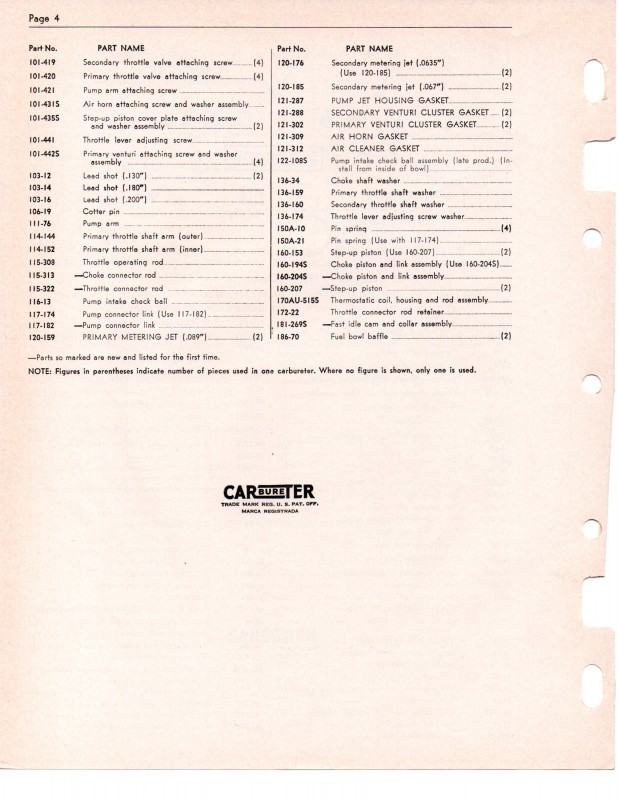

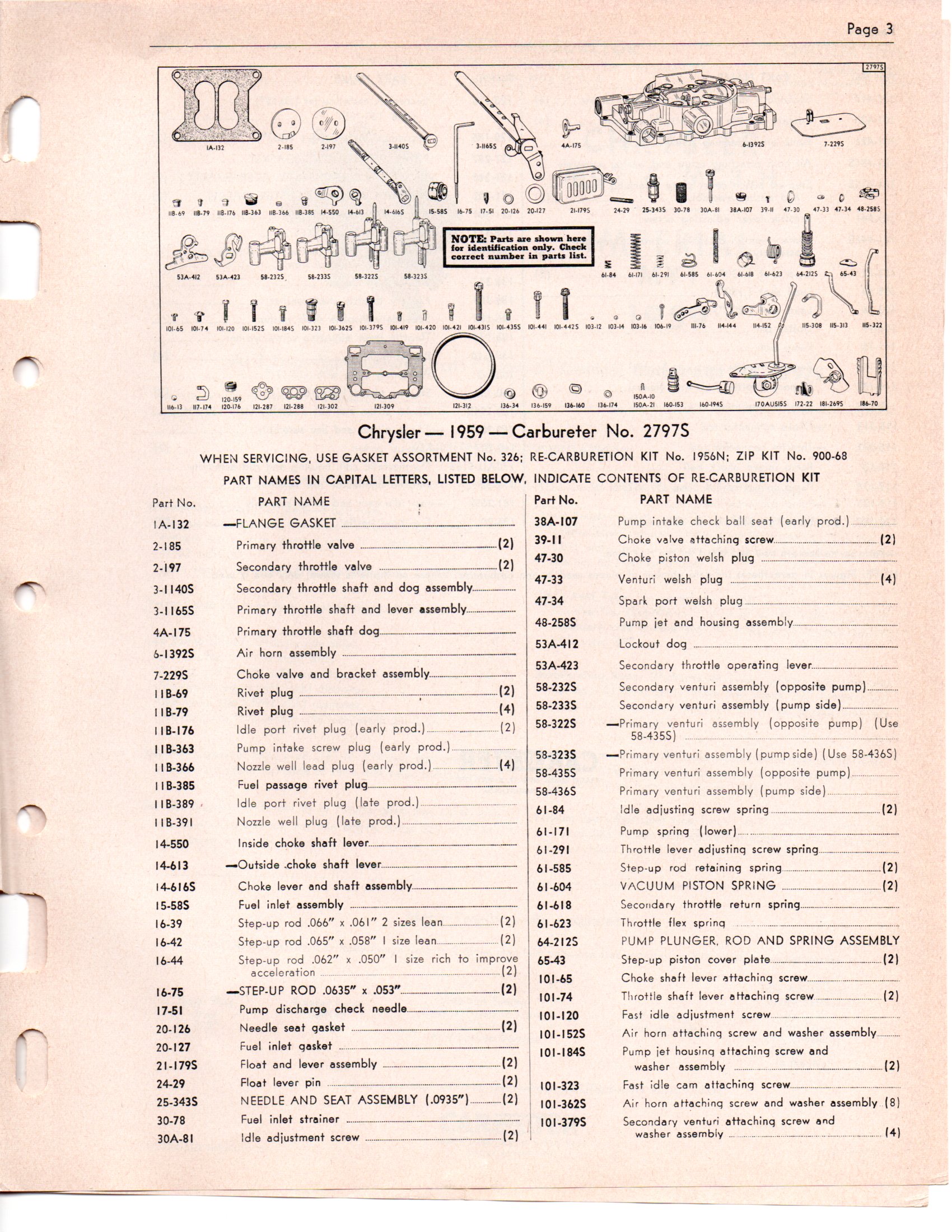

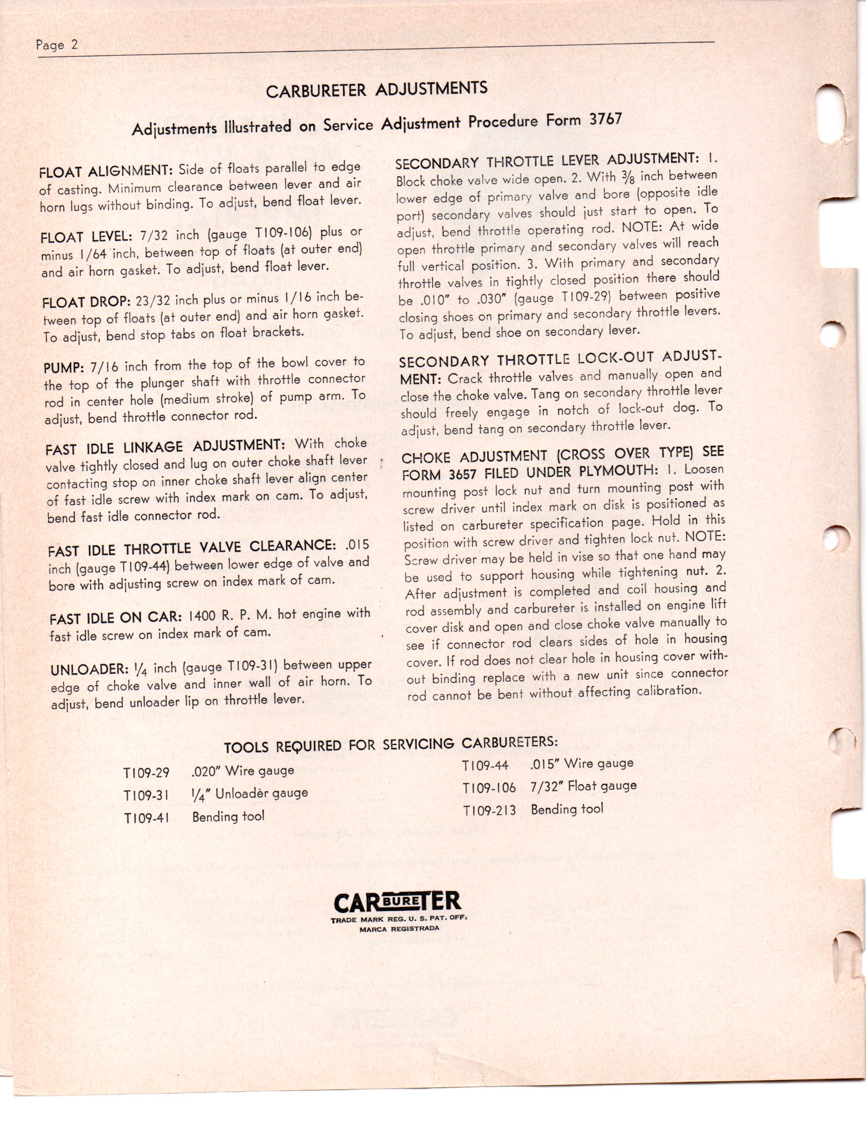

For what it is worth, attached is the manual for my 1959 Carter AFB.

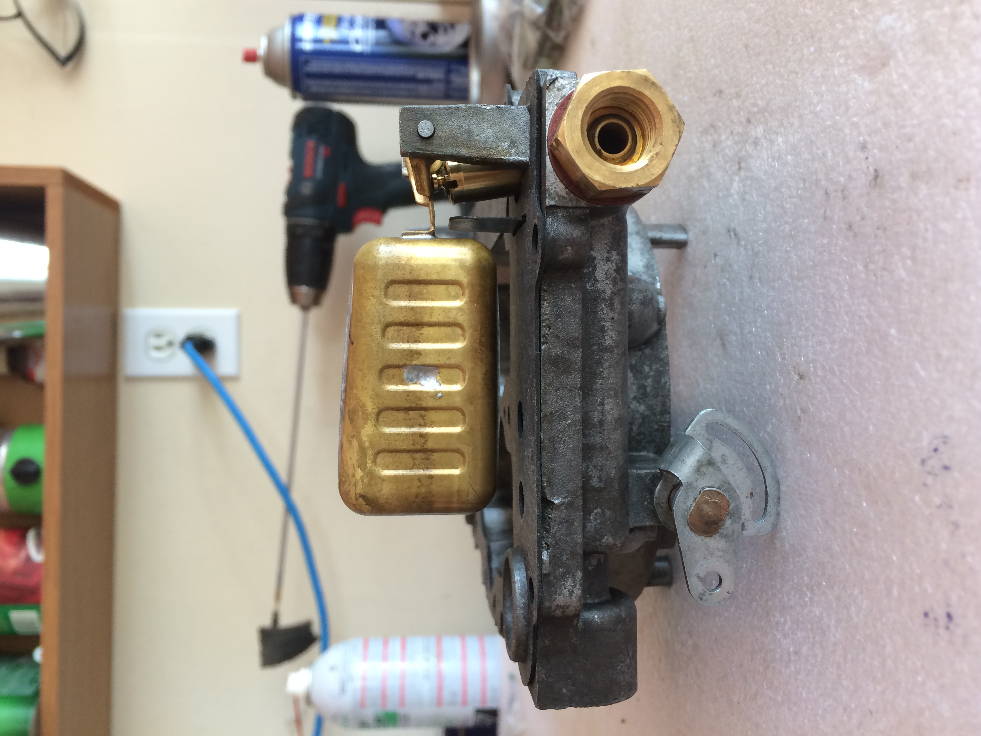

So I set 7/32 on one side and 7/16 on the other .
The 7/32 looks almost parallel with the air horn housing.
Thanks gents for all the help so far. This is great!

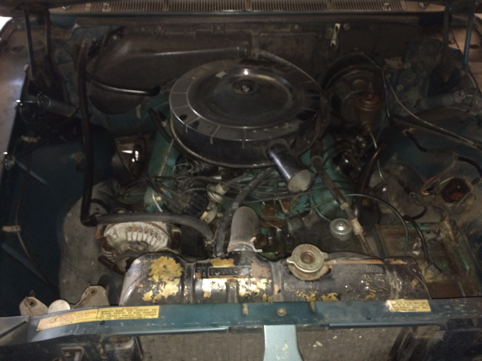

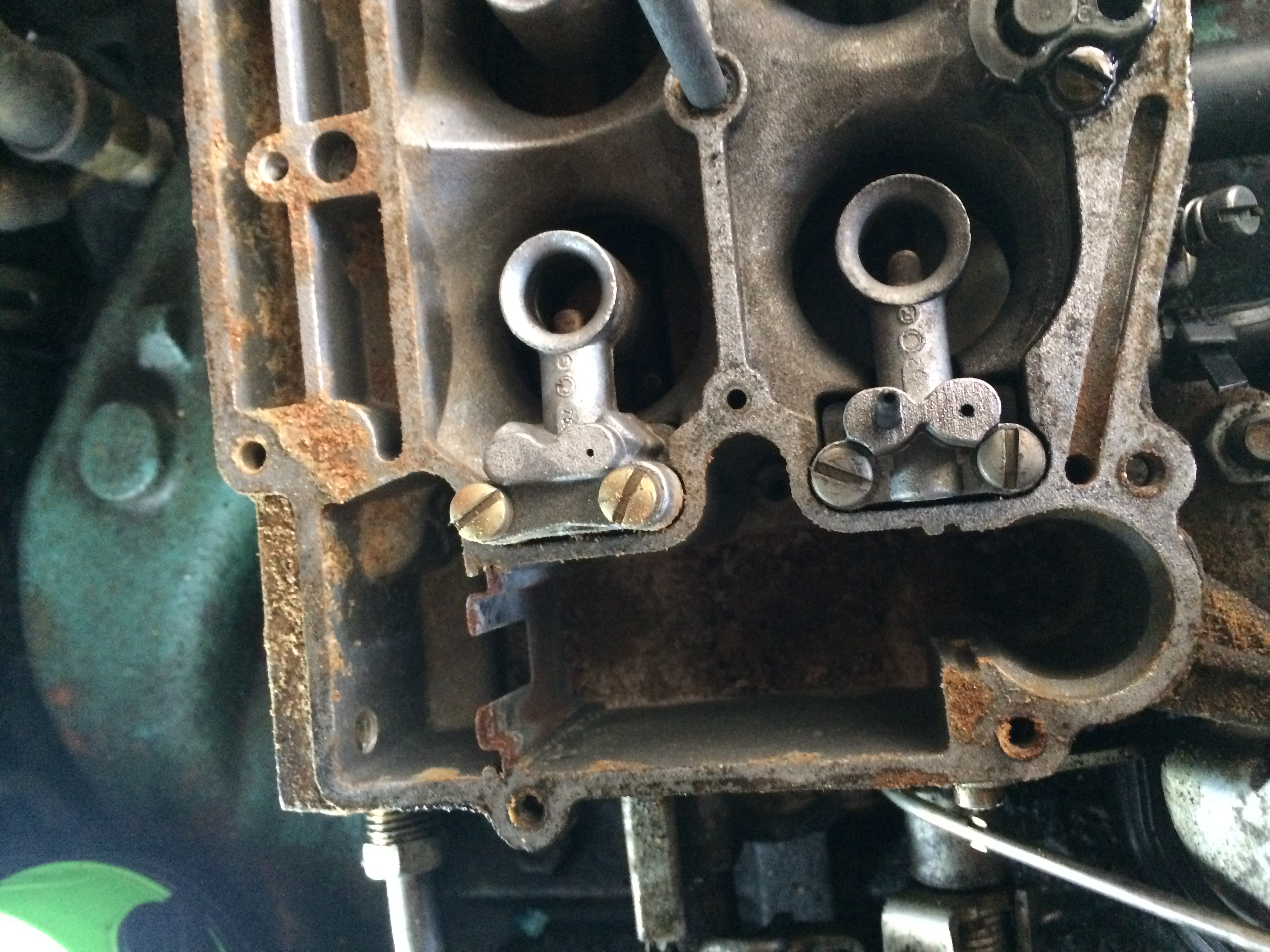

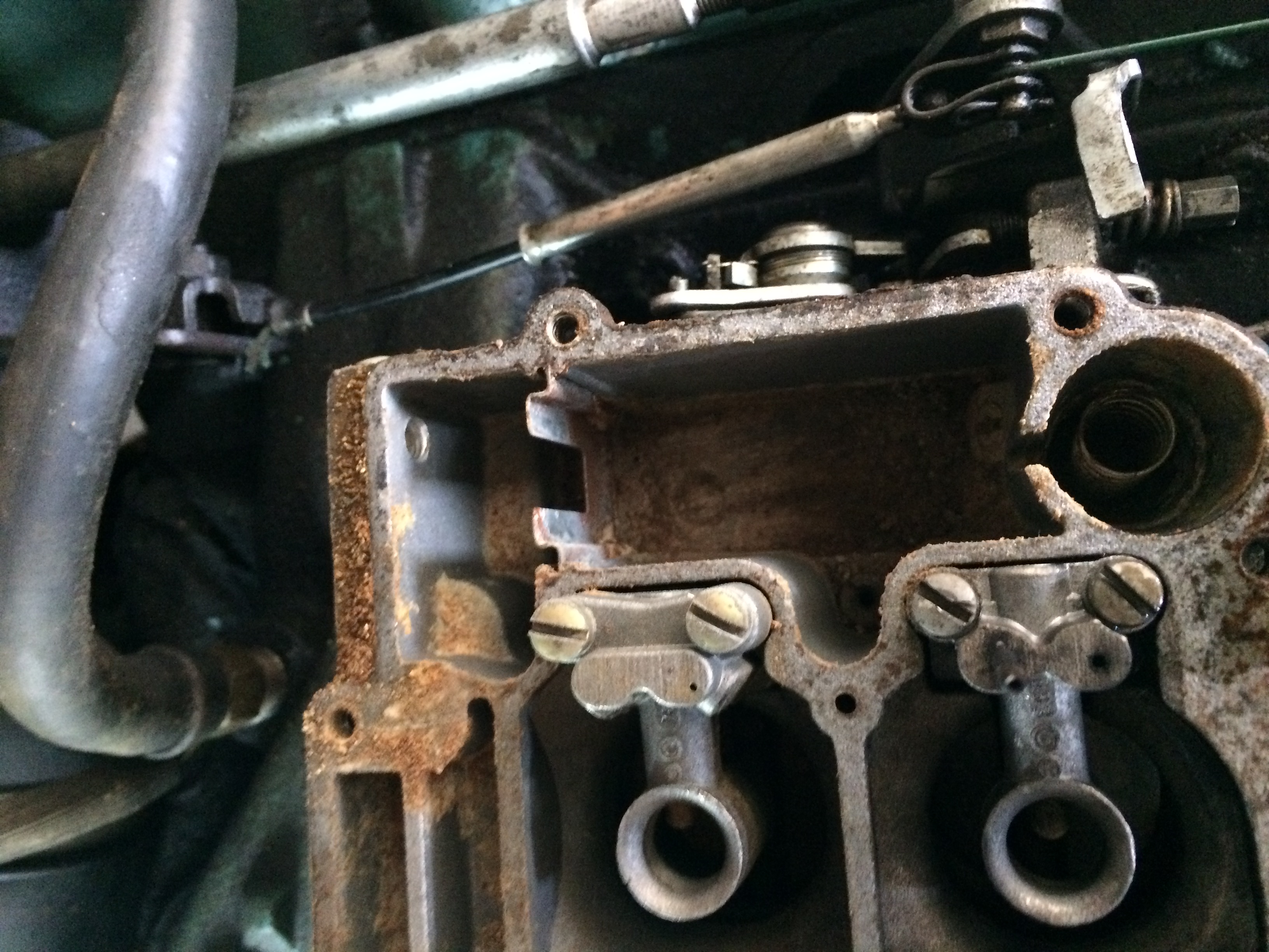

Here is a pic of the inside of it as I pulled it off the car. And it had been running alright up to that point.
The car only has 46,000 miles on it.

A couple of cautions. My car had sat for 45 years and the ONLY thing that had been disturbed was the ol AFB. I had overhauled them in the past, but this one was taken apart by a teenager who know nothing about carbs. He had lost some of the linkages and I did not know what else. I sent it to a company that rebuilds them, dynos them, etc. They also found he had switched the jets around as well as other things. I got it back looking like new, bolted it on and it ran like a new one.
After a few days it would not start without being primed or cranking long time. Since I had replaced the fuel tank, fuel pump, and carb I did not expect that. This carb has cross drilled fuel passages, and uses plugs. They apparently did not get some plugs in tight, now it drains all the fuel from the bowl into the crankcase. Takes a few days, then it is prime it again. They warranted it and all I have to do is send it back, but right now I need the car mobile for a paint job. Be especially careful of those plugs (aluminum rivets if I recall correctly). That might be one in the float bowl area, see the small round thing?
