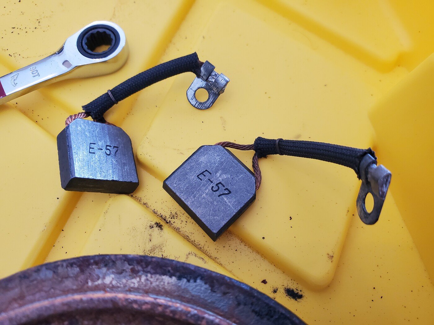

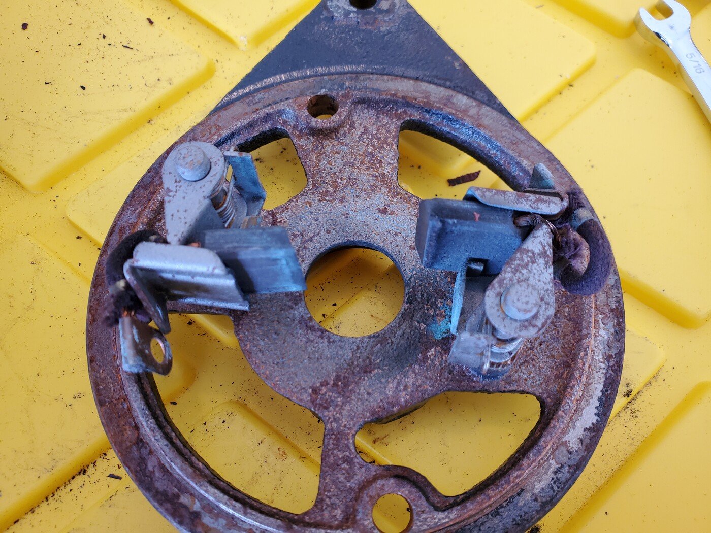

Once you get the back side off, you can start replacing the brushes. They were very easy to replace, just take a look and you'll see how it fit. They are set in a little spring container that push the brushes toward the commutator. Just pay close attention to the angle the brushes are set to ensure you put the new ones in the right way.

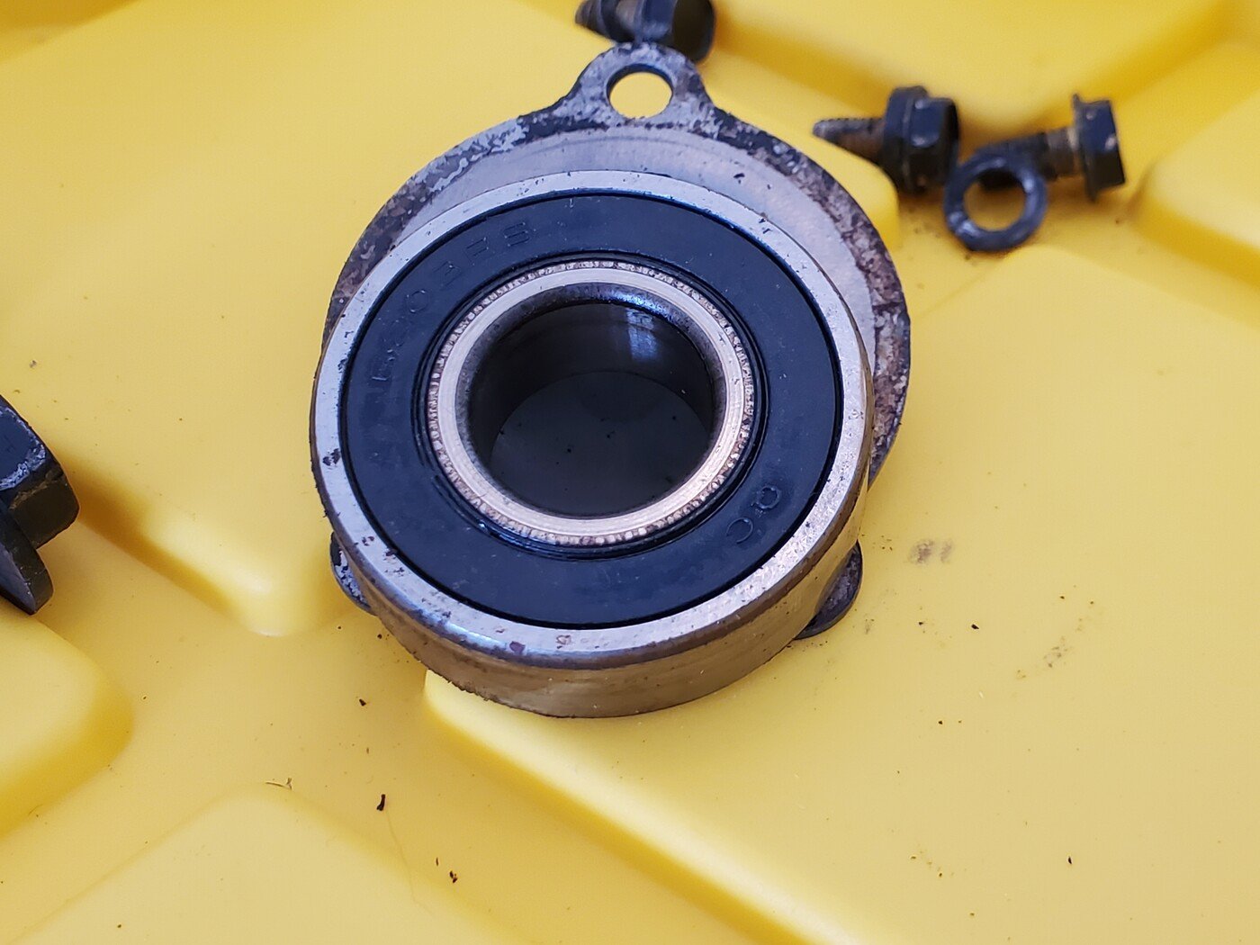

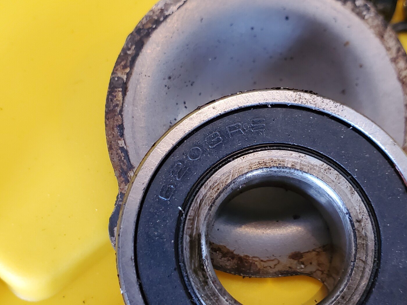

While in there, you should check your bearing on the generator. If it's grinding at all, or doesn't feel smooth, then you should definitely replace it. If unsure, just replace it anyway for peace of mind.

When putting the side with the brushes back in, be sure to push the brushes out so they can properly slide over the commutator end.
