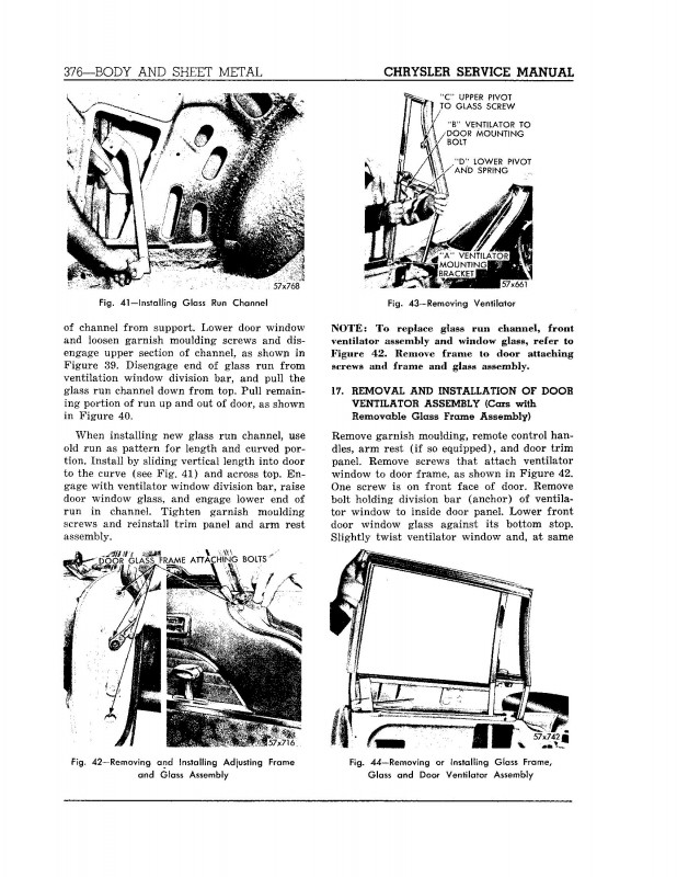

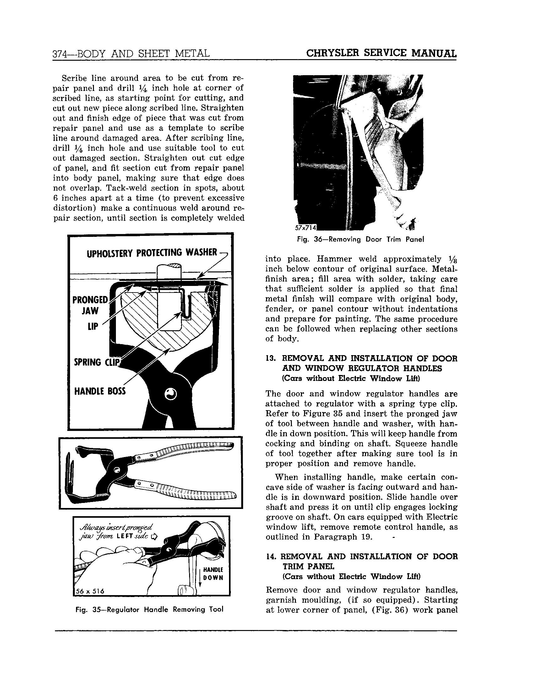

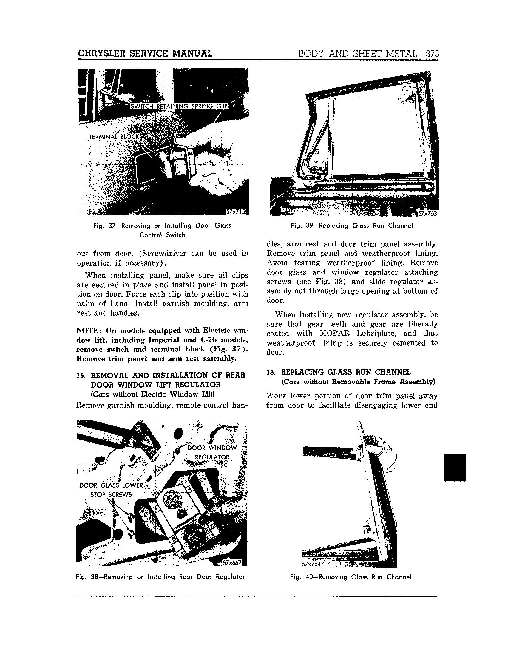

Don - I don't have the 59 service manual, but I think my 57 is likely close enough. Here's the pages that describe that for the 57 model year.
Re: 1959 Imperial Crown Southampton Restoration
THANKS!!! I guess the company decided that after two years of taking them off, they did not need it to be included in the 58 or 59 manuals that I have.

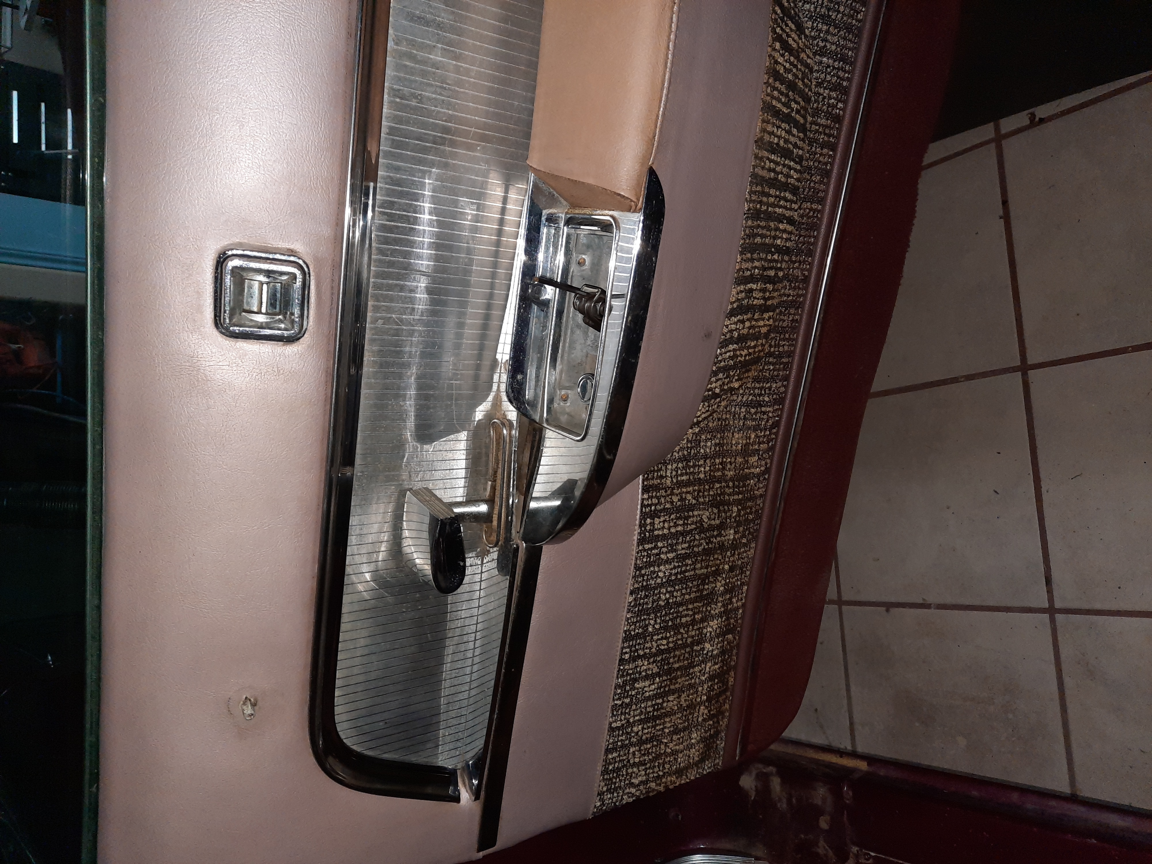

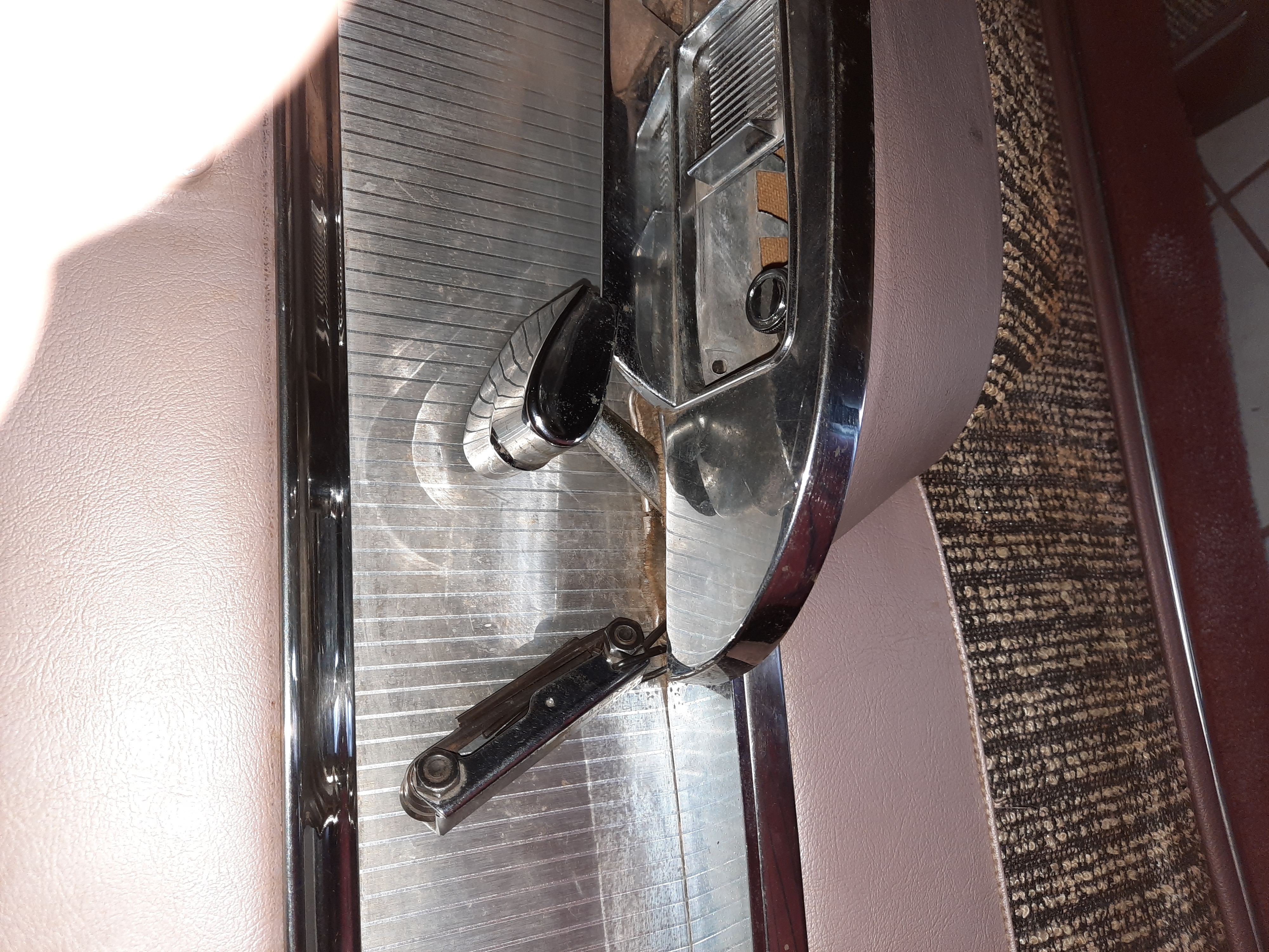

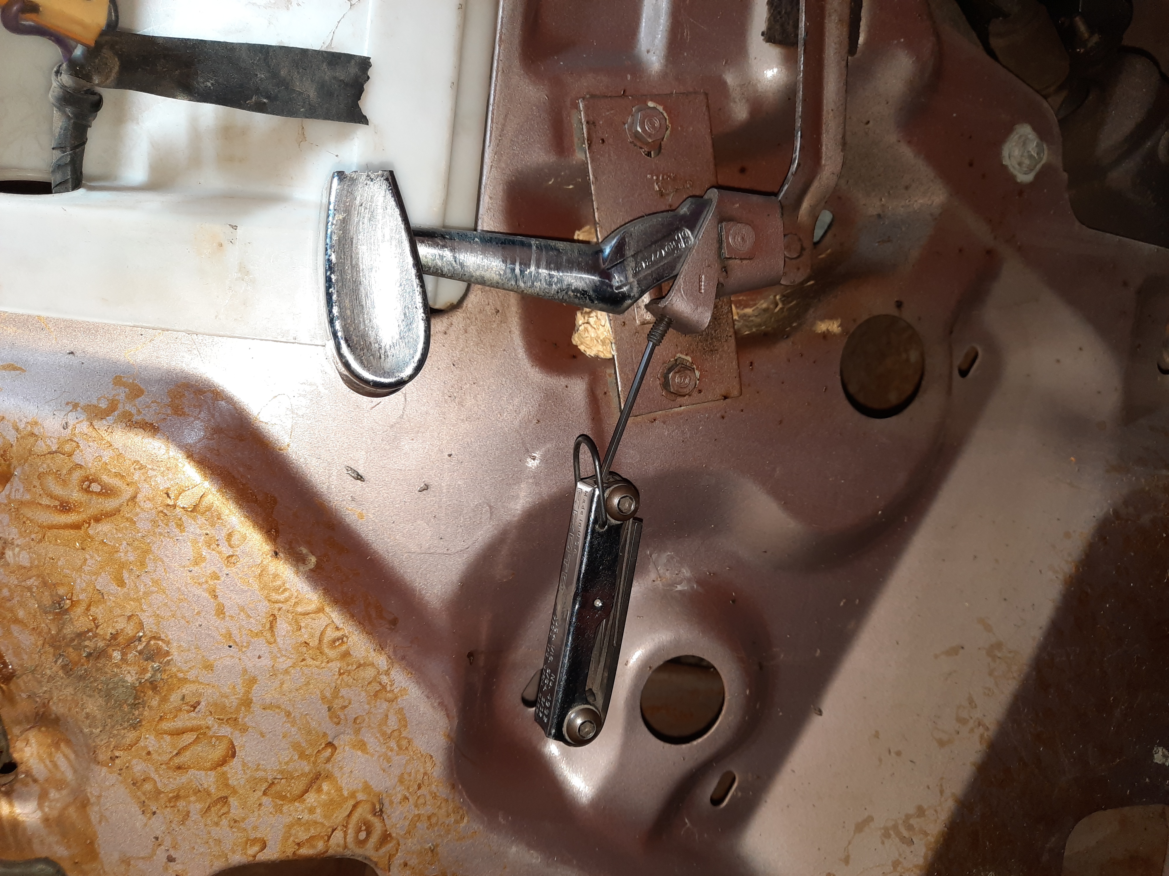

59 has a different handle, not covered in 1957. This is the one fighting me now:
Looks just like my 57 door handle. Never done it, but my guess is you would loosen the trim piece that is around the door handle, then detach the door handle - I think these are held in with a screw not too far down. Once you do that, the rest of the door panel should just pop off I would assume. Going entirely off assumption here and what I remember as my 57 is still in the shop.
Finally found it. One must put an allen wrench down along side of that handle and unscrew a retaining lock screw, then it pulls right out! Feeling smart right now, I did not break anything decoding it.

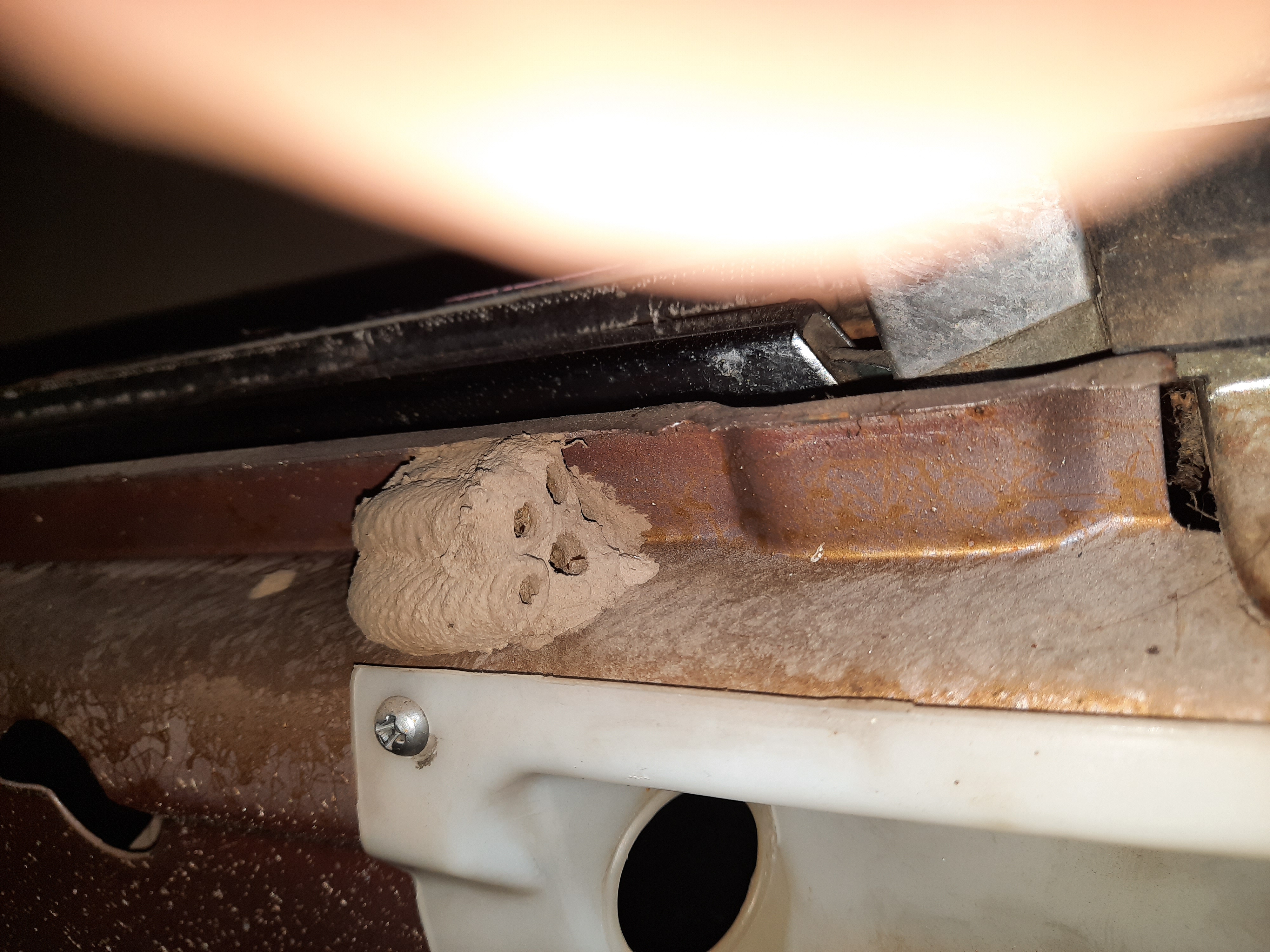

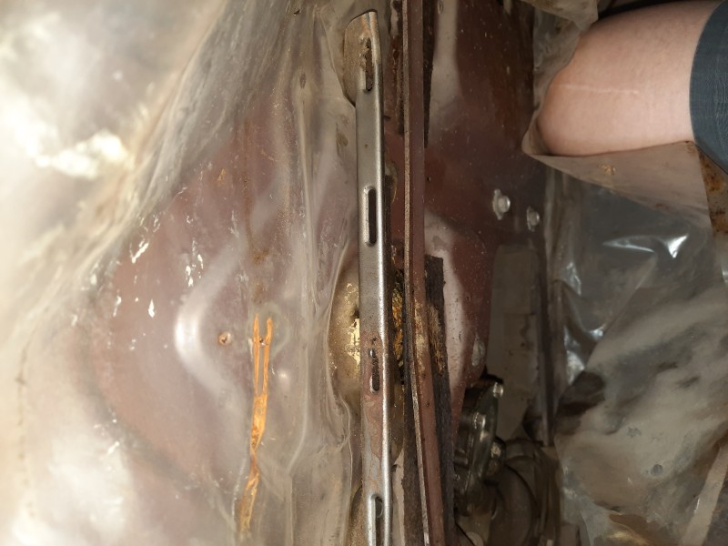

For anyone with a similar door panel, here are some photos of what one is dealing with. The only screws you can see, are not holding on trim, but actually screwed to a bracket in the door frame so when you use the armrest it is attached directly to the door frame. The funny thing with four holes in it, first photo, does not appear in the parts manual.
