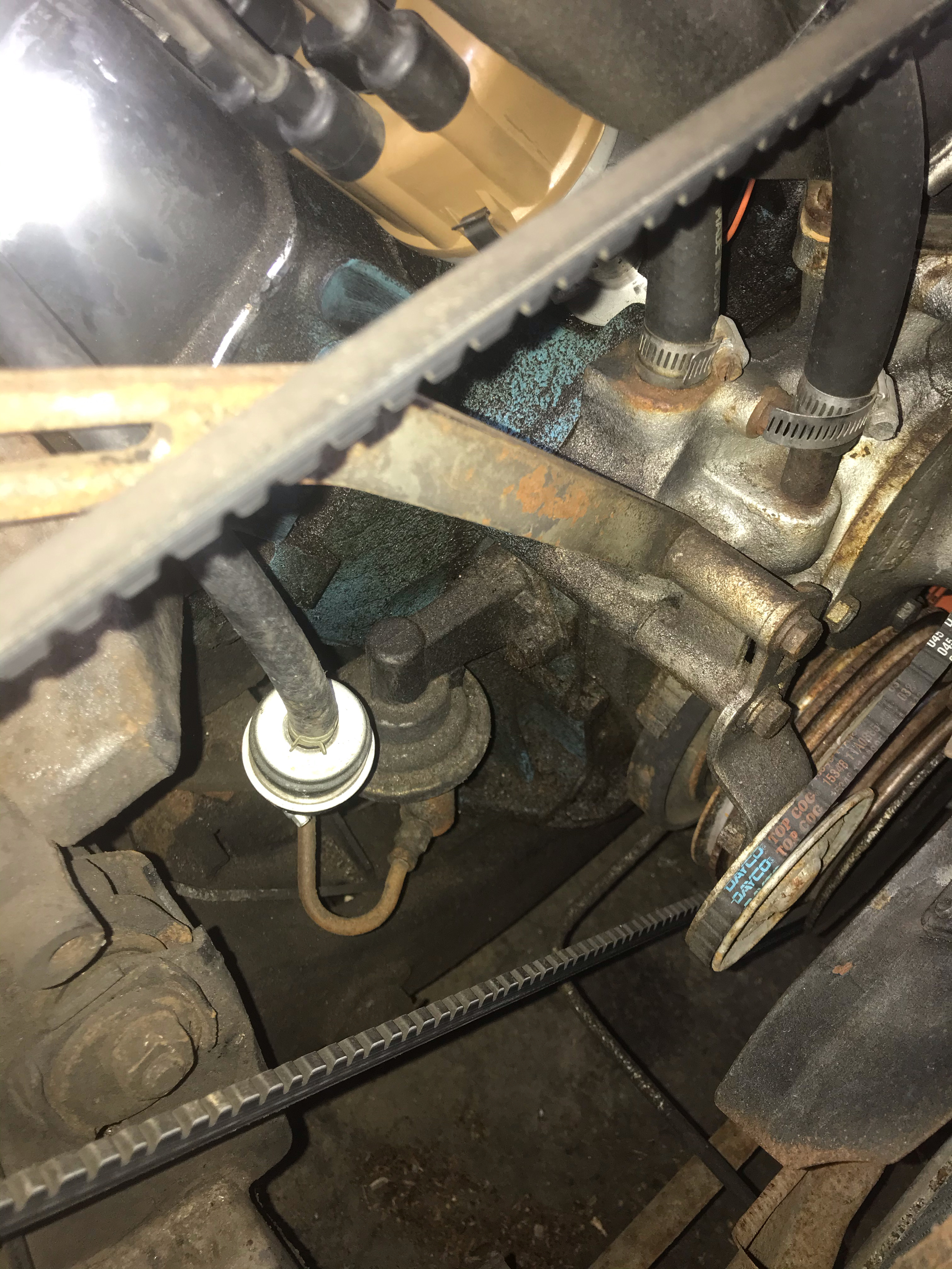

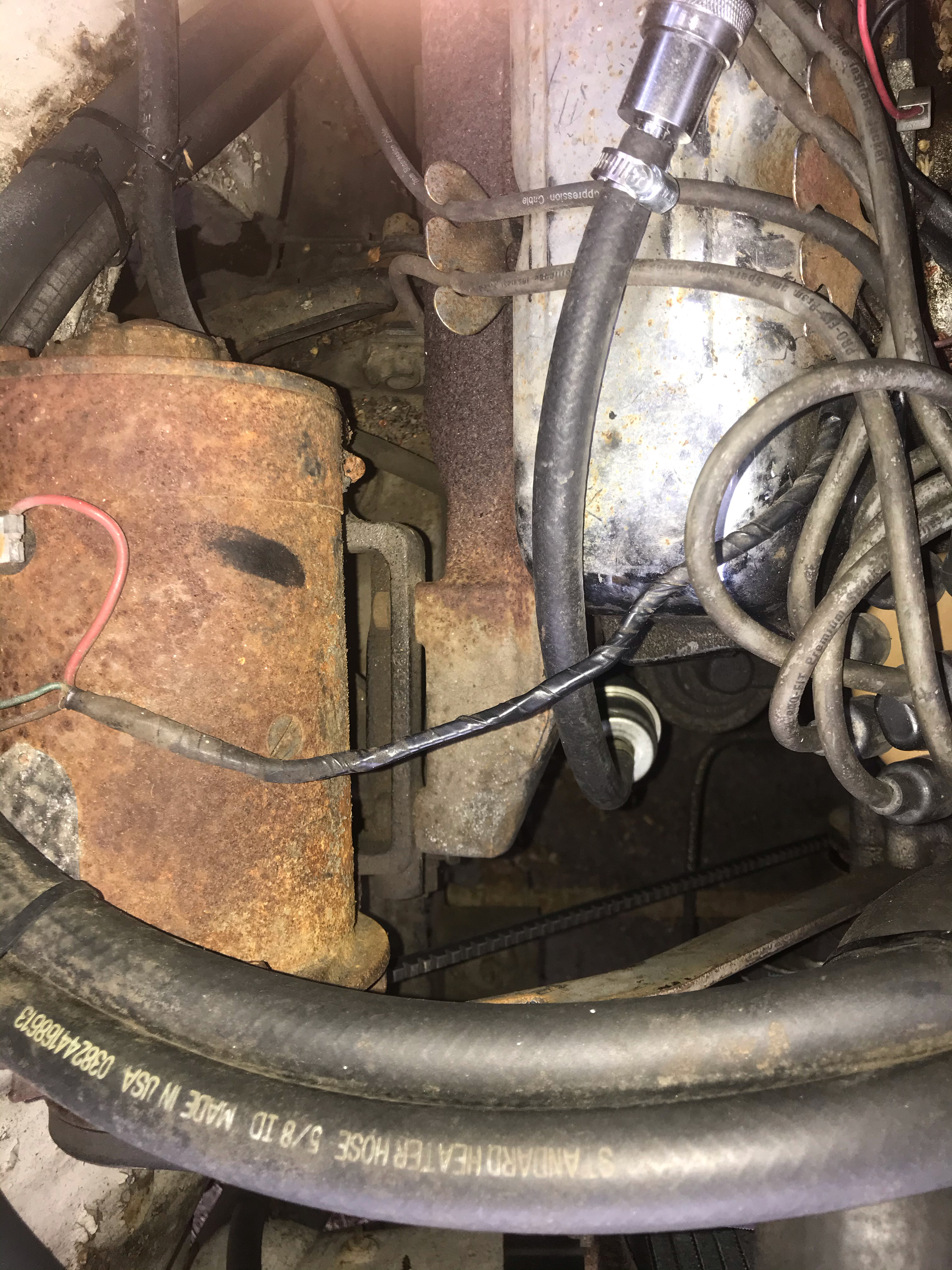

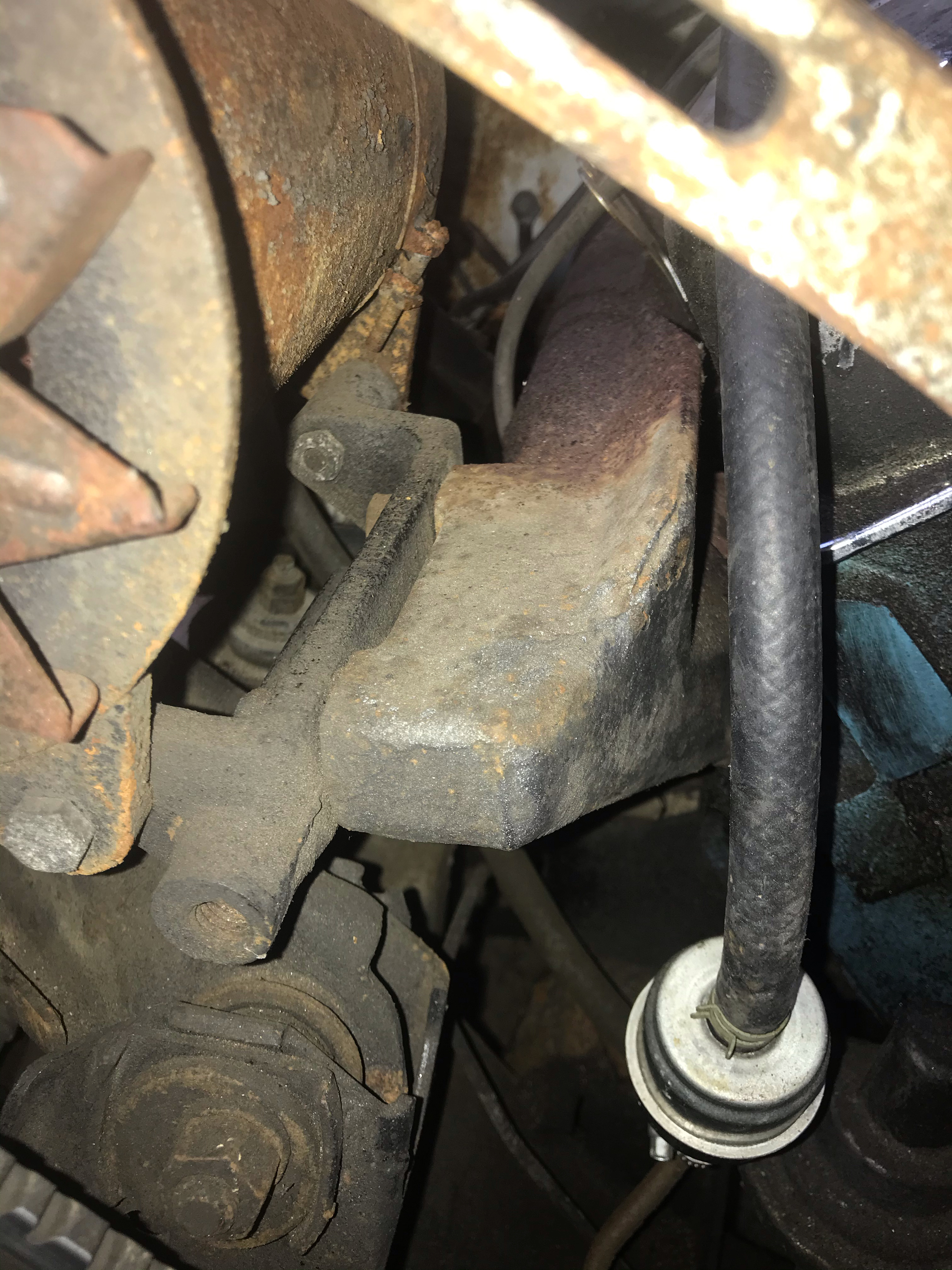

I am hoping someone can possibly take a couple pics of their 60-63 imperial alternator bracket for me. Here is what I have on my generator.

Re: 18 volts charging battery 1960 Imp
Posted: Wed Jul 01, 2020 2:51 pm
by ImperialAtom
I see what you mean now. The top bracket should be fine... if it's not you can always get one custom made without too much effort.
As for the lower bracket, my initial thought is that it will not fit directly to the alternator because that generator is so long compared to the alternator. The alternator is like 2/3 or less the depth. You may need to track down a bracket for it.
You might get lucky and the alternator will bolt up on the lower bracket between the bolt holes rather than the outside of them. Won't know until it shows up and you give it a shot. Let us know how it goes.

If it's not too far off from the lower bracket in one way or another, you could always put in some spacers to make it fit. An extra long bolt with the right sized spacer should be fine. Not talking about 100's of lbs of pressure here, just need to get it stable where it won't move as the belt is jerking on the pulley.
