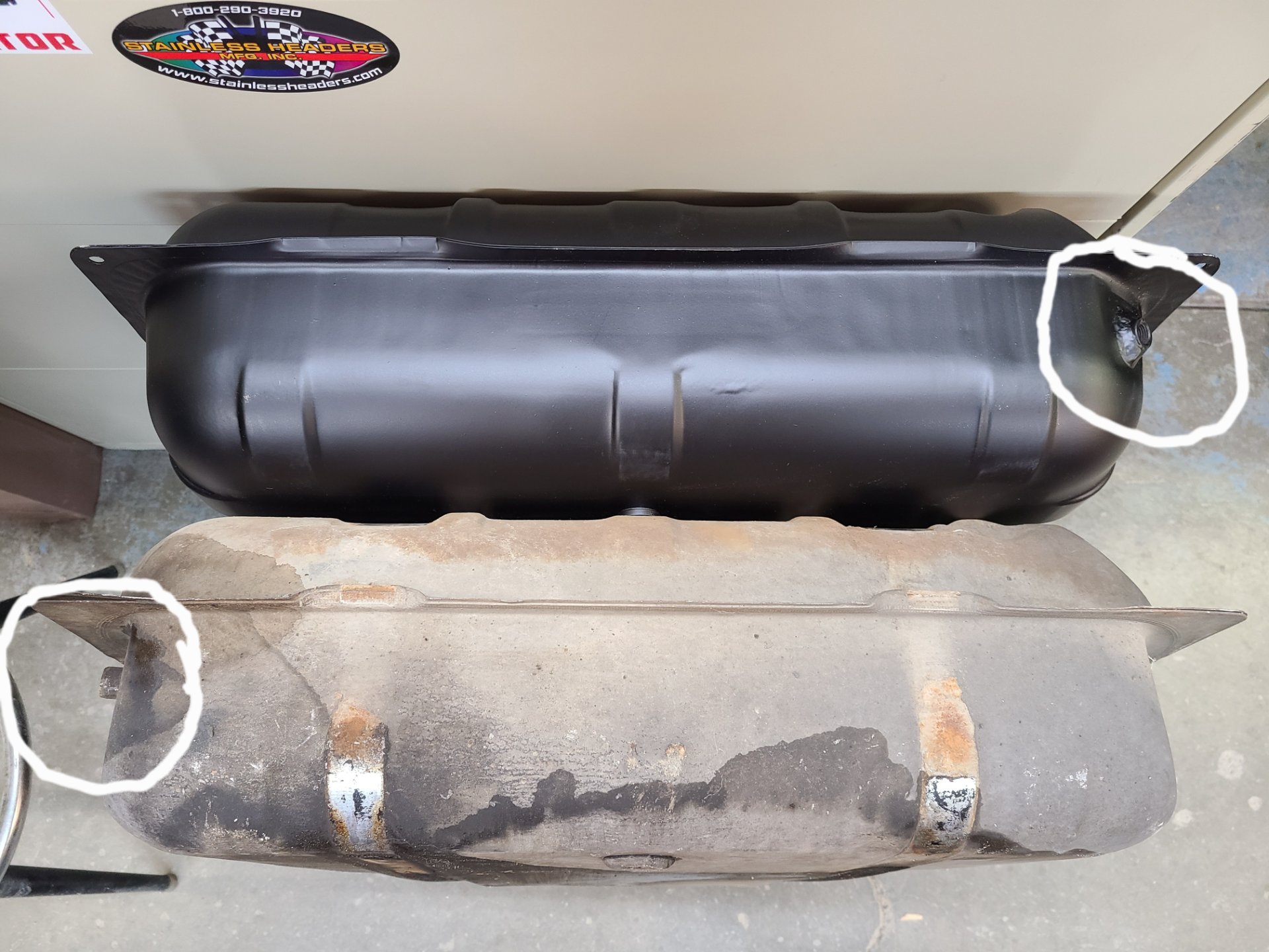

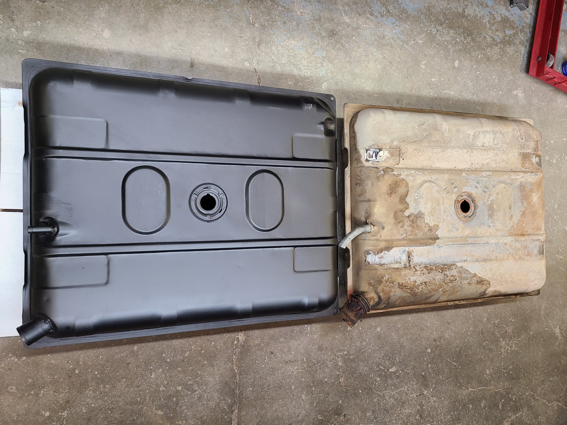

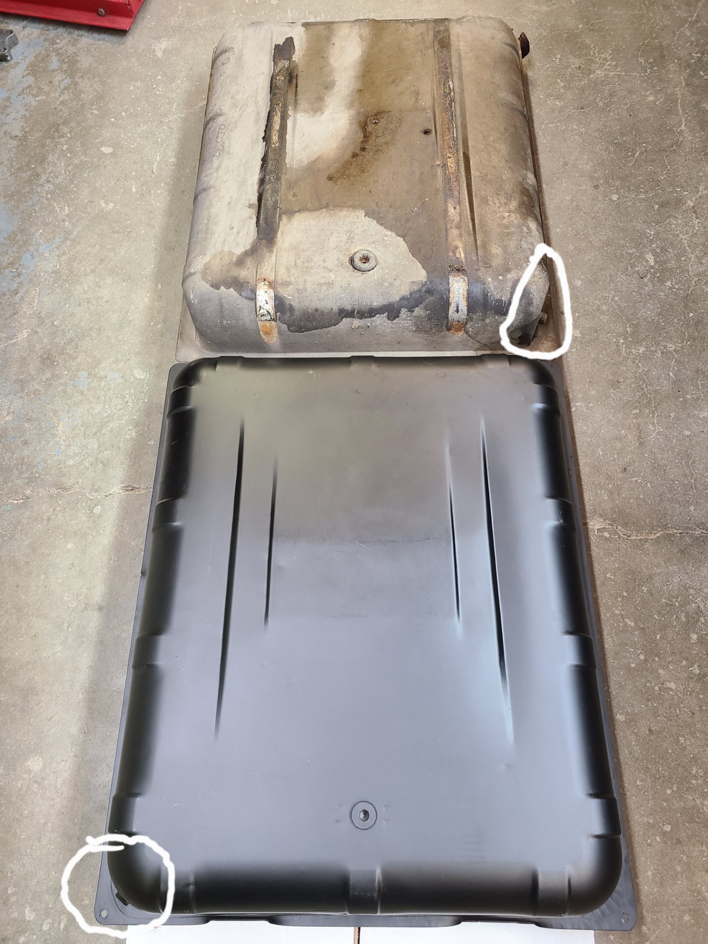

Tried to get some good pictures of these tanks. The '56 Chrysler has the exact same tank as the '56 Imperial. The '55 Plymouth I looked at today does have the fuel line on the left side of the car. Maybe the '55 Imperial does too. I usually see one at a car show over the summer so I may check it out. I'm going to make the new tank work but it would've been real simple for the vendor to make a note of the difference so a person knows what to expect. The email he sent me started off with "let's get one thing straight" & he proceeded to tell me how bad my tank is & it couldn't have been fixed for the price he charges for a tank. At no point in my initial email did I show that I was unhappy with the tank. I was just trying to bring something up that maybe he didn't know about. It sounds like you've had good luck with Vans & that's where I'll be going for any future purchases.
Front of the tanks. The fuel line connection is circled.
Bottom of the tanks. Fuel line connection is circled. The drain plug goes to the front of the car.
Top of the tanks. The fuel filler & vent are at the right rear corner when it is mounted in the car.
