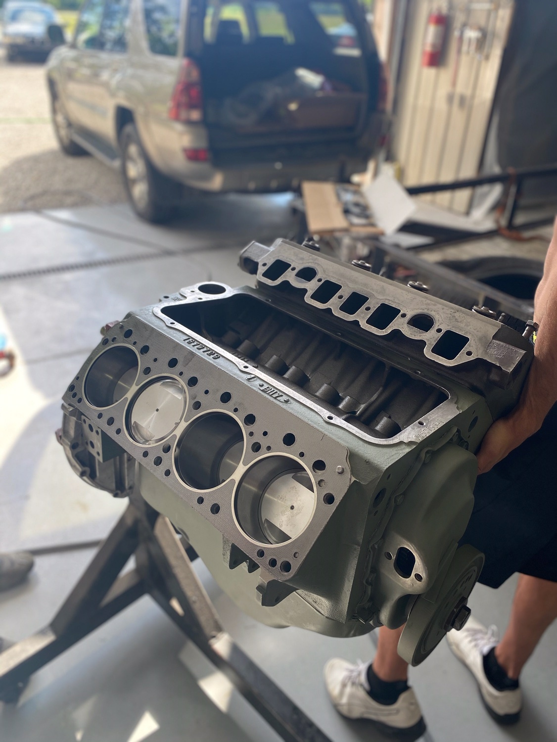

Here's the pics of the finished block and a few more as the other parts get put on.
