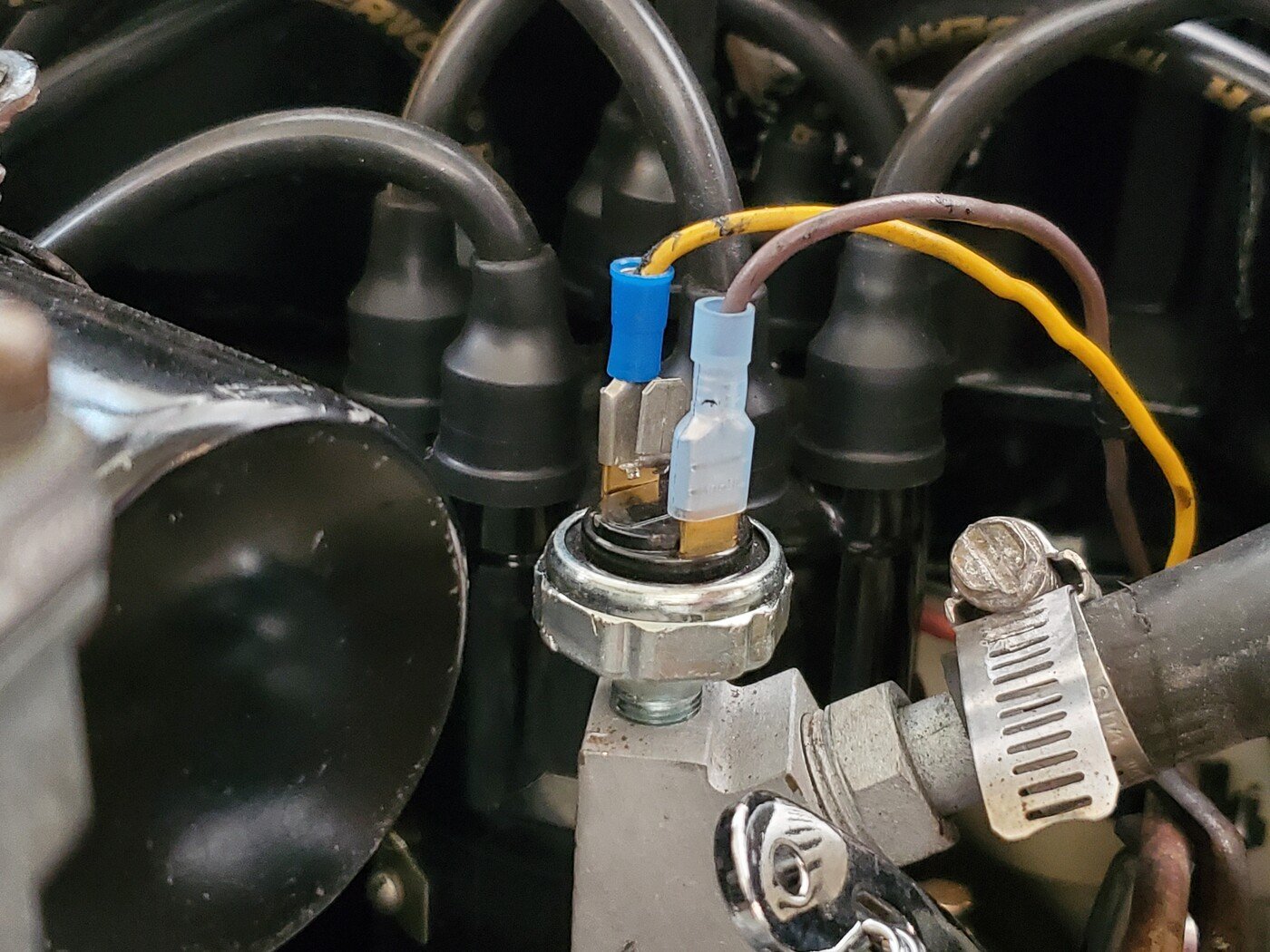

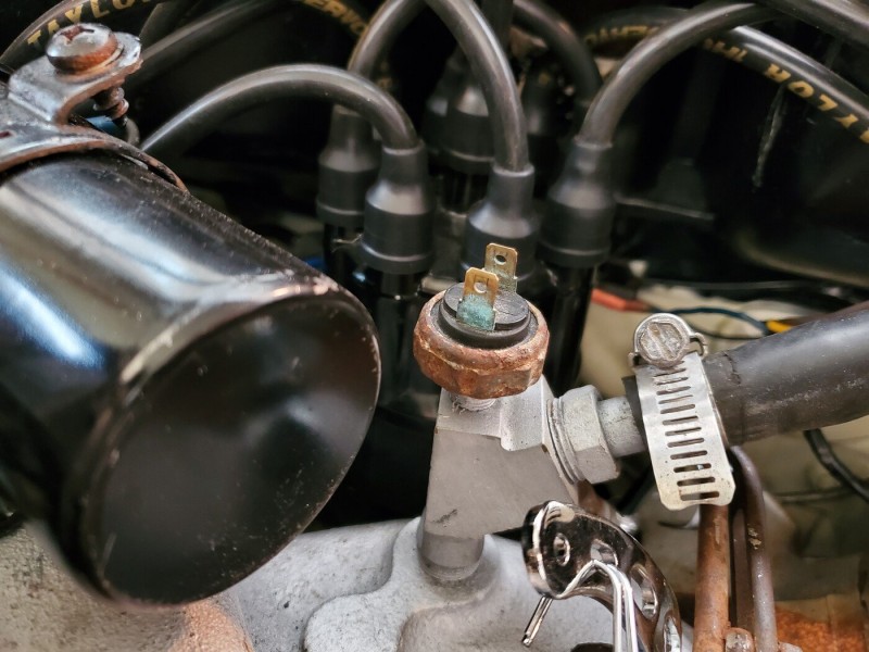

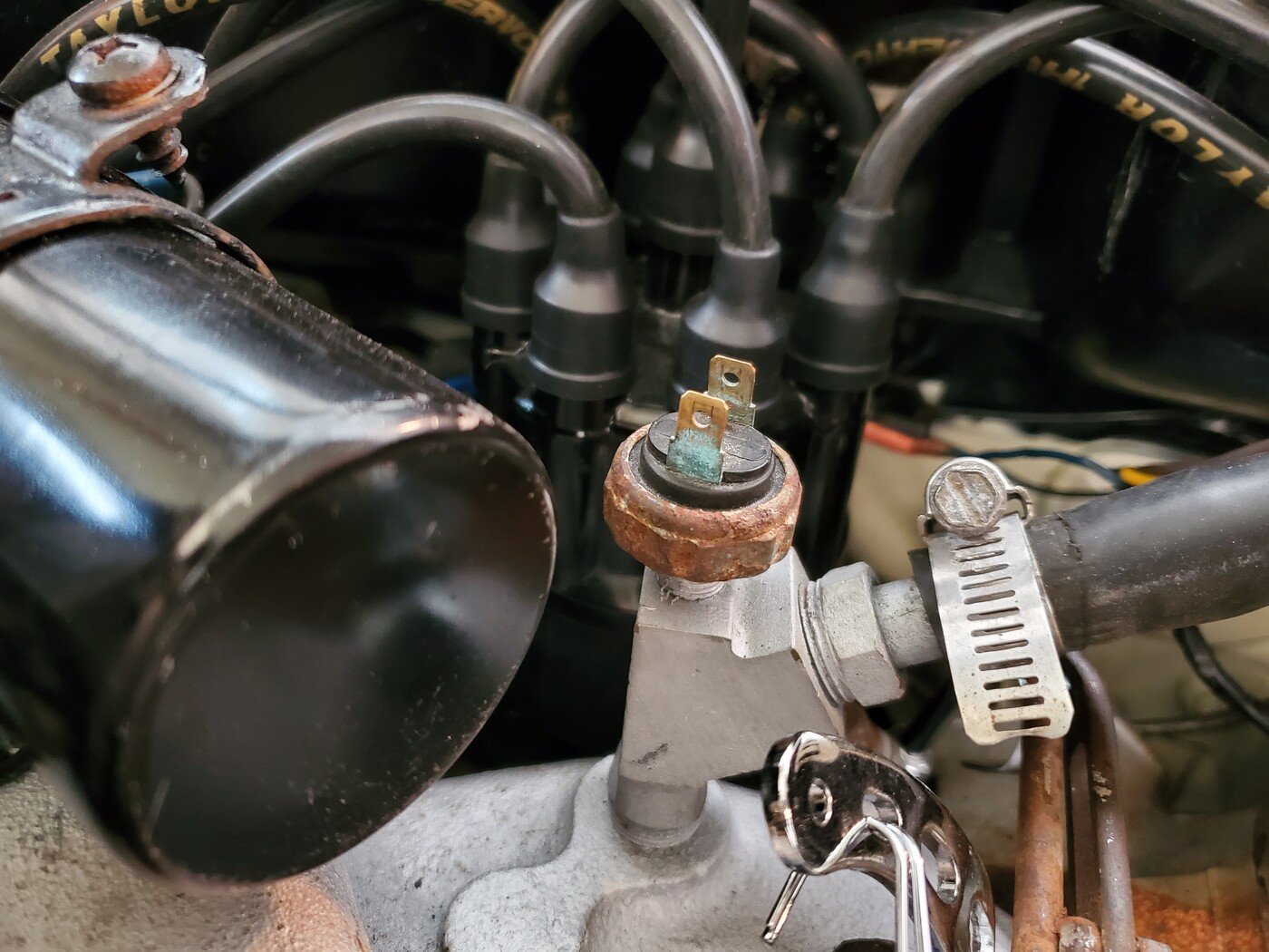

My neutral safety switch was no longer working. I was able to find a replacement on ebay searching for part number 1770093. This appears to be the same for most late 50's Chrysler cars.
Here's the before and after pictures. It was very easy to change out, just make sure it is nice and tight to avoid a vacuum leak, and it should work great. It is located on the back of the engine near the distributor.
