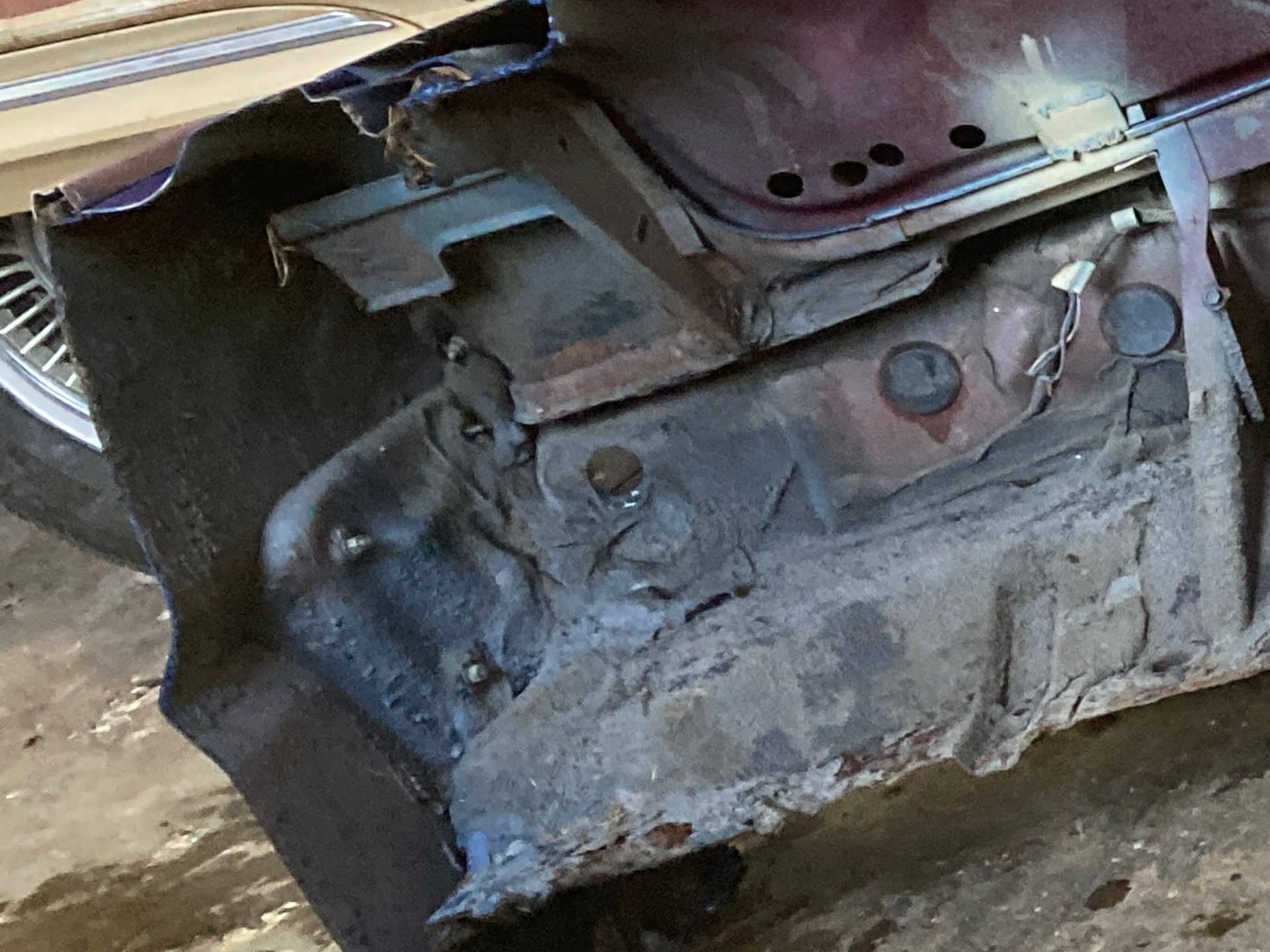

66 IMPERIAL REAR QUARTER BUMPER ESCUT.
Re: 66 IMPERIAL REAR QUARTER BUMPER ESCUT.
Yes I would say bumper has to come off and there are 3 nuts from inside the trunk.
Posts: 91
Post by watchfatha1 »
i would have guessed that too, but No. I have the bumper off of my 66 LeBaron parts car and the screw heads are nowhere to be found. Looks like you have to pry up the inner fender well to get to it.
This is a cutaway from a ‘64. You can see the mounting studs.
Posts: 91
thanks. Will take another look but they were not visible nor palpable on my 66-covered by the inner fender.
Posts: 91
thanks. Will take another look but they were not visible nor palpable on my 66-covered by the inner fender. Eureka! I did not check the trunk.
