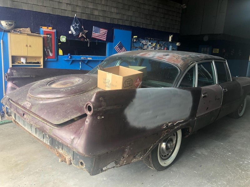

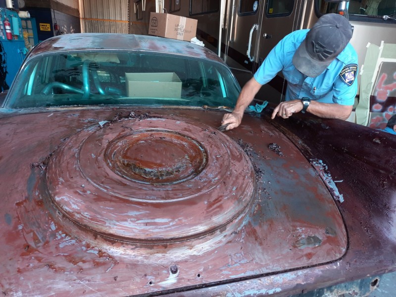

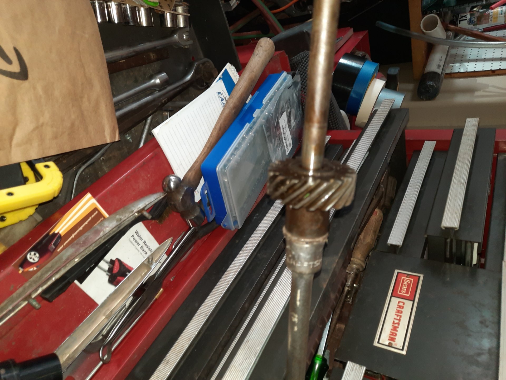

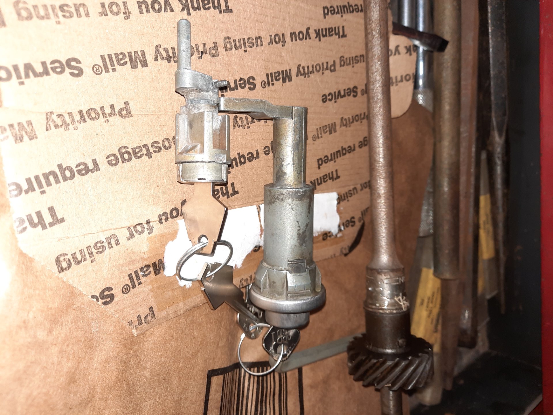

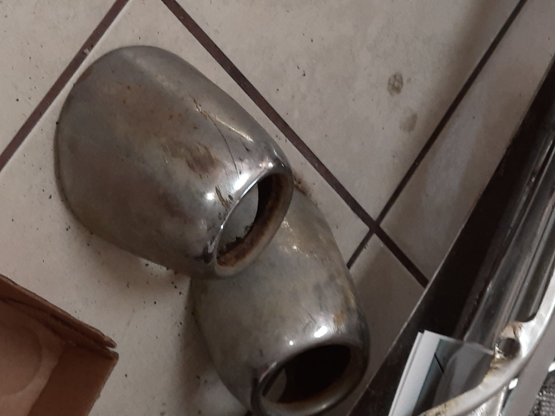

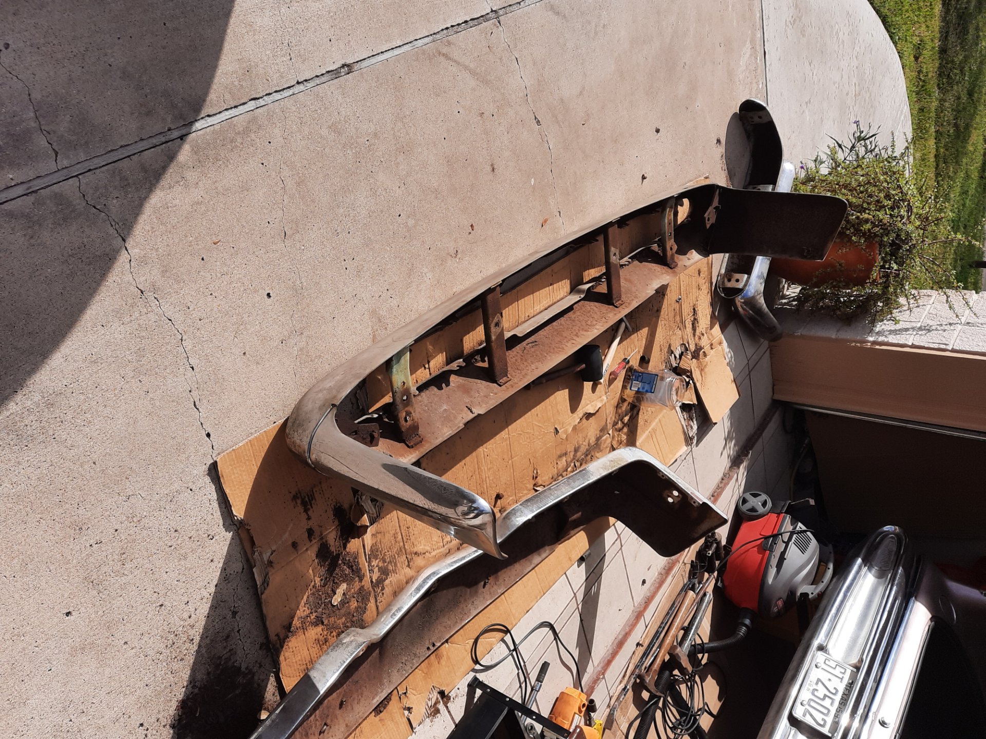

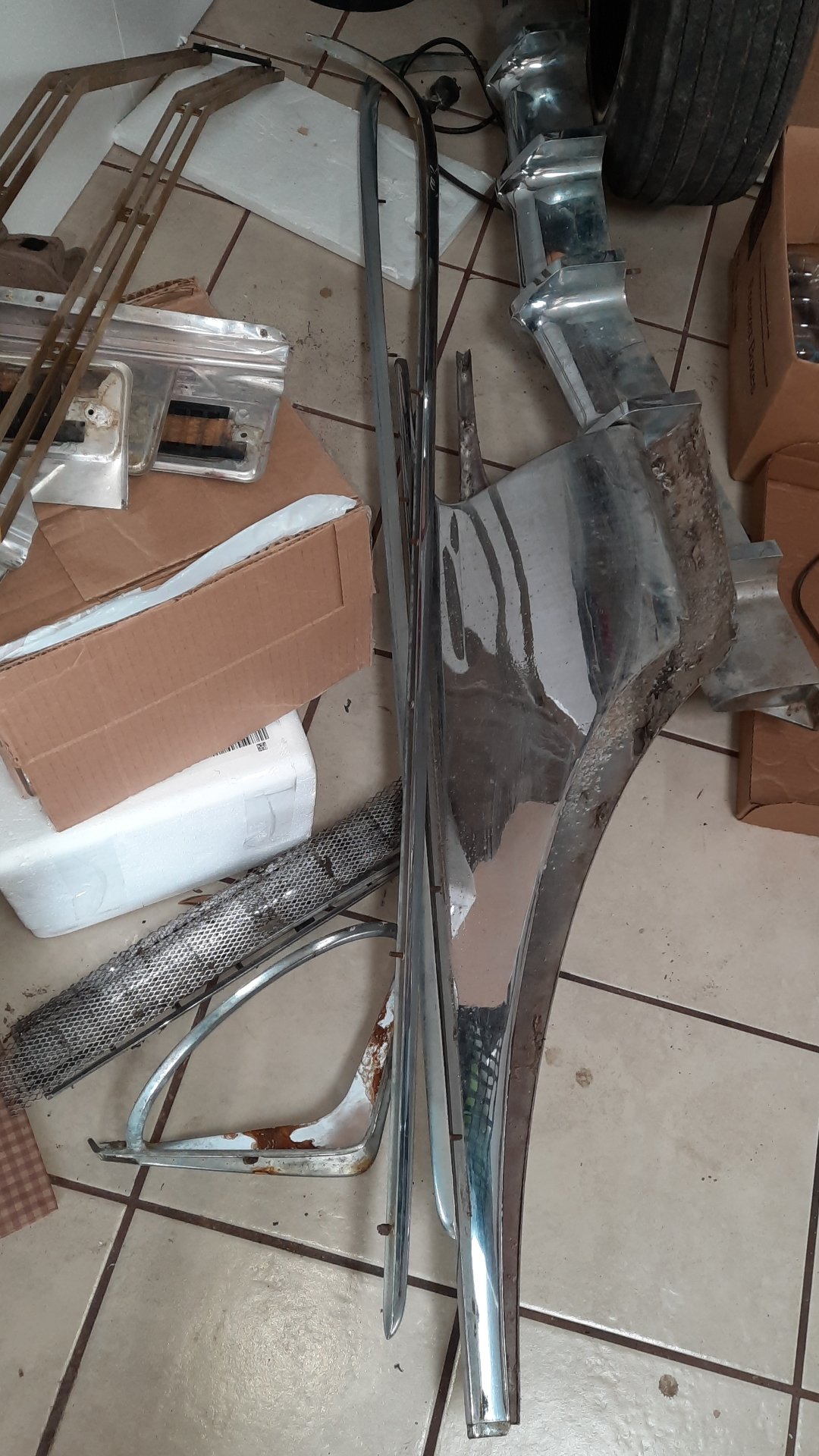

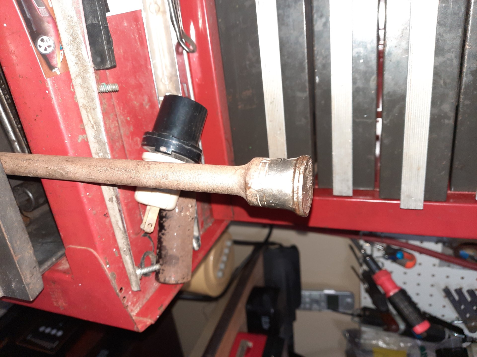

I just got started on my third 59 Crown restoration, lots of work to do yet. Someone had glued a vinyl top on it, so all that dried glue has to be removed before painting. I have lots of the chrome off and in Mexico for chrome plating. The engine had a total overhaul many years ago and I was not sure how much oil remained on new parts, so I wanted to re prime the oil system before starting. I devised a tool to remove the oil pump drive gear, and now I can put an allen wrench on a battery powered drill and get oil everywhere before starting, priming the pump as well as filling the oil filter etc. Someone had lost the keys long ago as well, and taking out the ignition switch is a real pain, so I removed a door lock and trunk cylinders and had keys made for them, much easier tasks. I have stripped a lot of the chrome and it is in Mexico getting chrome plated. Here are some photos of all that:

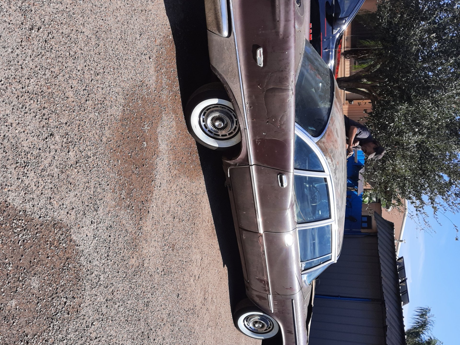

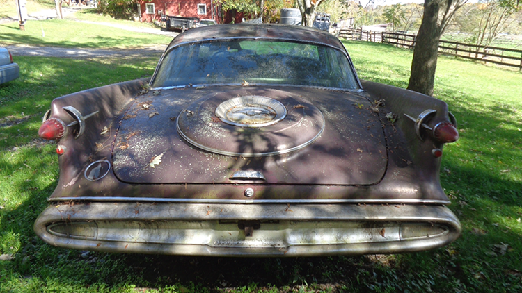

She (Ruby) has come a long ways since she was found, this only a couple of months ago:

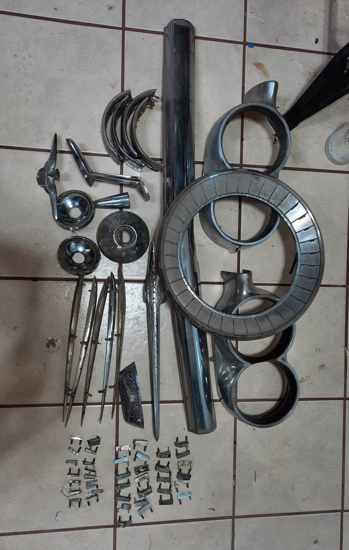

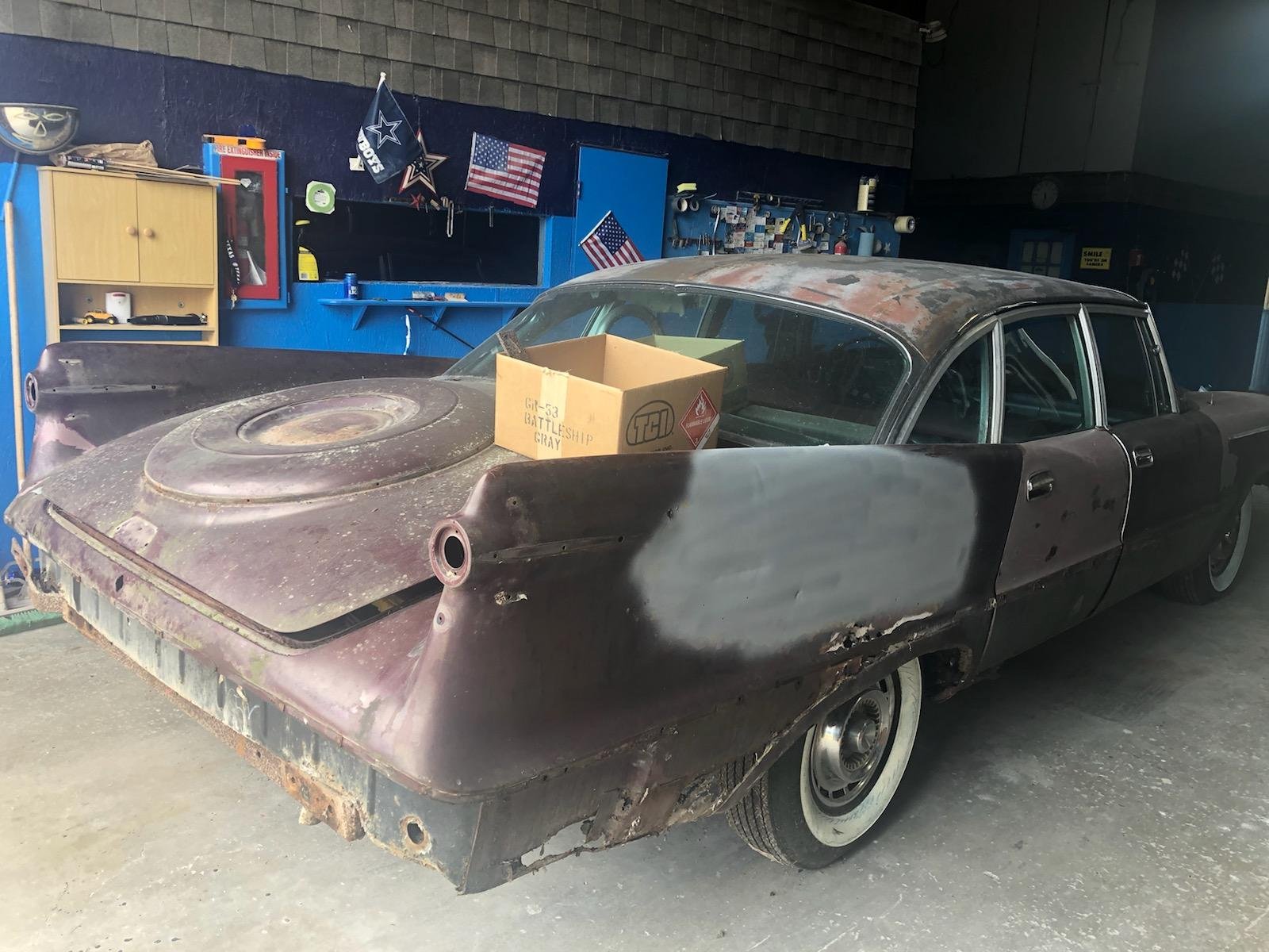

And "Restoration of Ruby" continues. More chrome to go to Mexico, in fact NOTHING is NOT being re- chromed. Body work is coming along just fine as well, should be able to start the engine soon as well.
