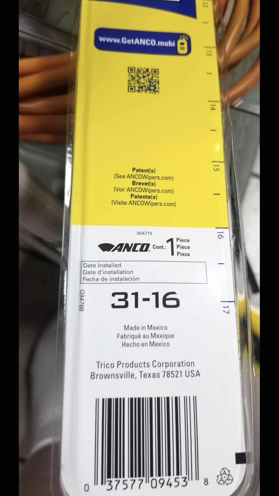

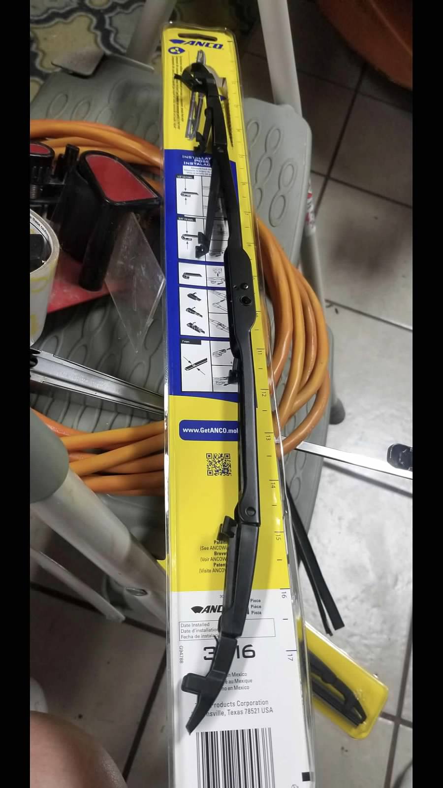

Hi, I have a set of anco wiper arms/blades on my 64’ imperial, they are the 18” “wing” style stainless. I need to replace the wiper blade refills and was thinking of using a set of refills from new wipers but they are narrower than the vintage anco style and afraid they won’t fit snug. Have any of you been through this or have any suggestions, know where to locate the vintage size

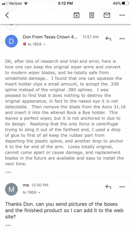

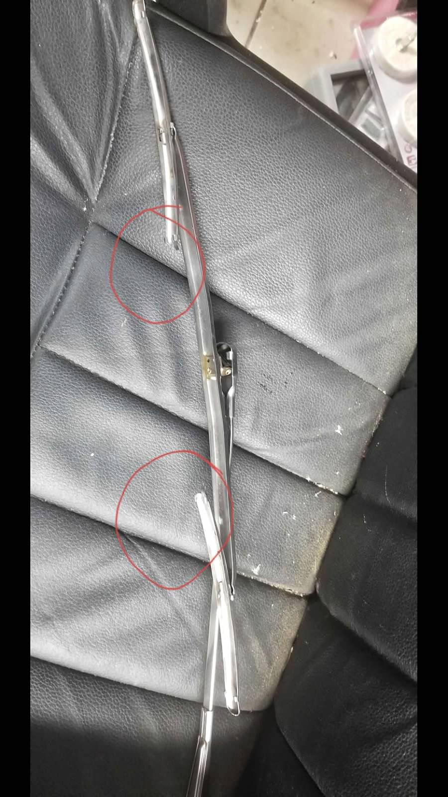

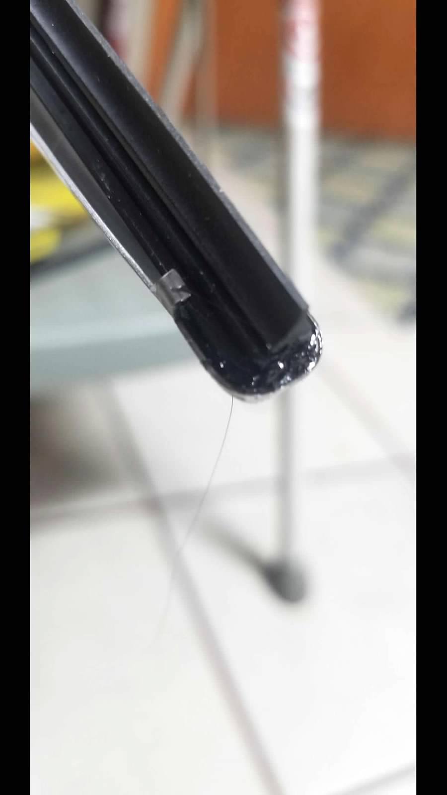

I sure have! For my 59 the arms are for a wider blade spline that is currently available. I did some careful measuring and found I can carefully squeeze the fingers on the arm slightly to grasp the narrow blades. Then remove the blades from the Anco arm and you are better than new! I will gather a post and photos and post later.
This link should get you all the data and instructions:

I copied your pictures from shutterfly and dropping them in here just in case... hope you don't mind, if so, please let me know.
Re: Anco original wiper blades
Thanks, that was a good thing ImperialAtom. I guess I should have cautioned, this is for 1959 models and of course a few others, I do not know exactly what years used the narrow spline blades. If you ignore this guidance, and install the narrow blades, durin the next rain storm you will lose your blade and then scratch your windshield with the arm. That tends to ruin your whole day
