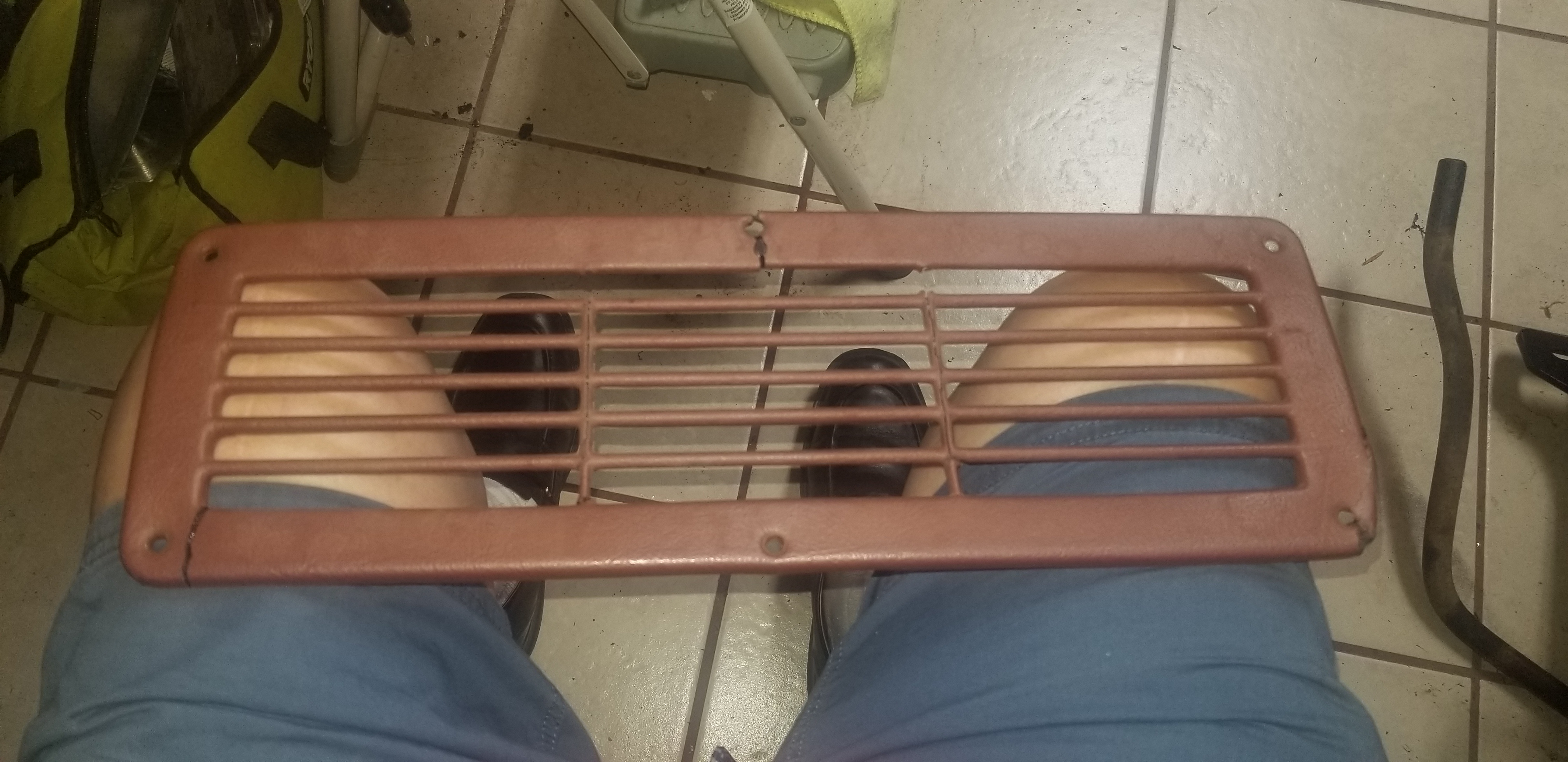

My rear air conditioner air intake grille baked in the sun for 61 years and is in rough shape. I have been gluing it back together and trying to restore it, but would love to replace it with something neater. Any suggestions?

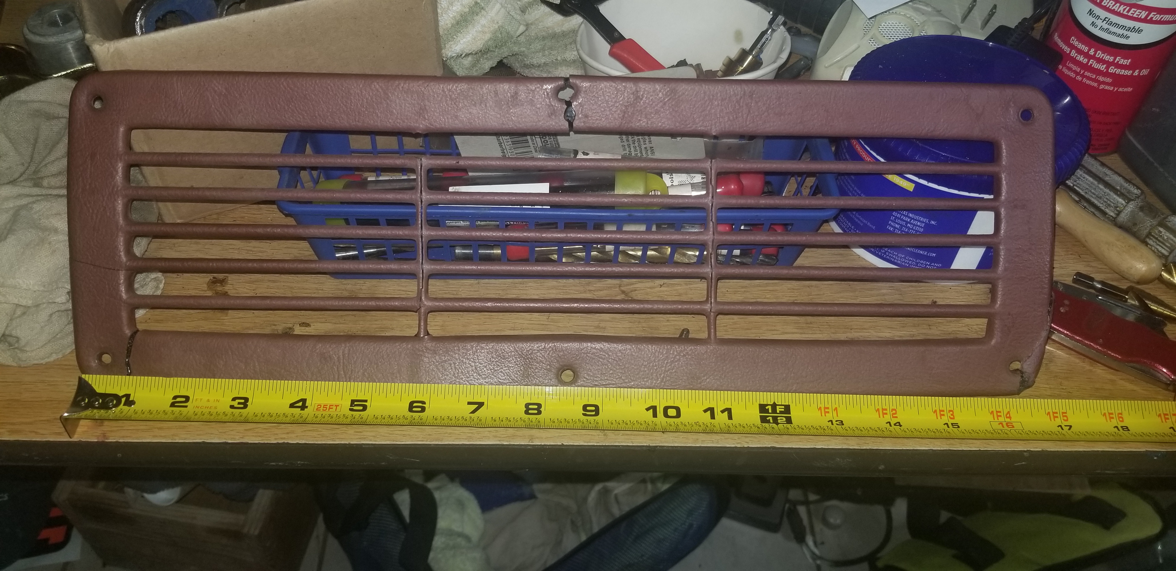

Before even trying, can you measure the longest width of that vent? That will at least tell me if it will even fit on my printer bed.
Re: 1959 Imperial parts
19.25 inch long

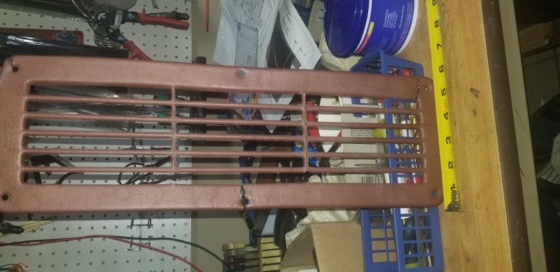

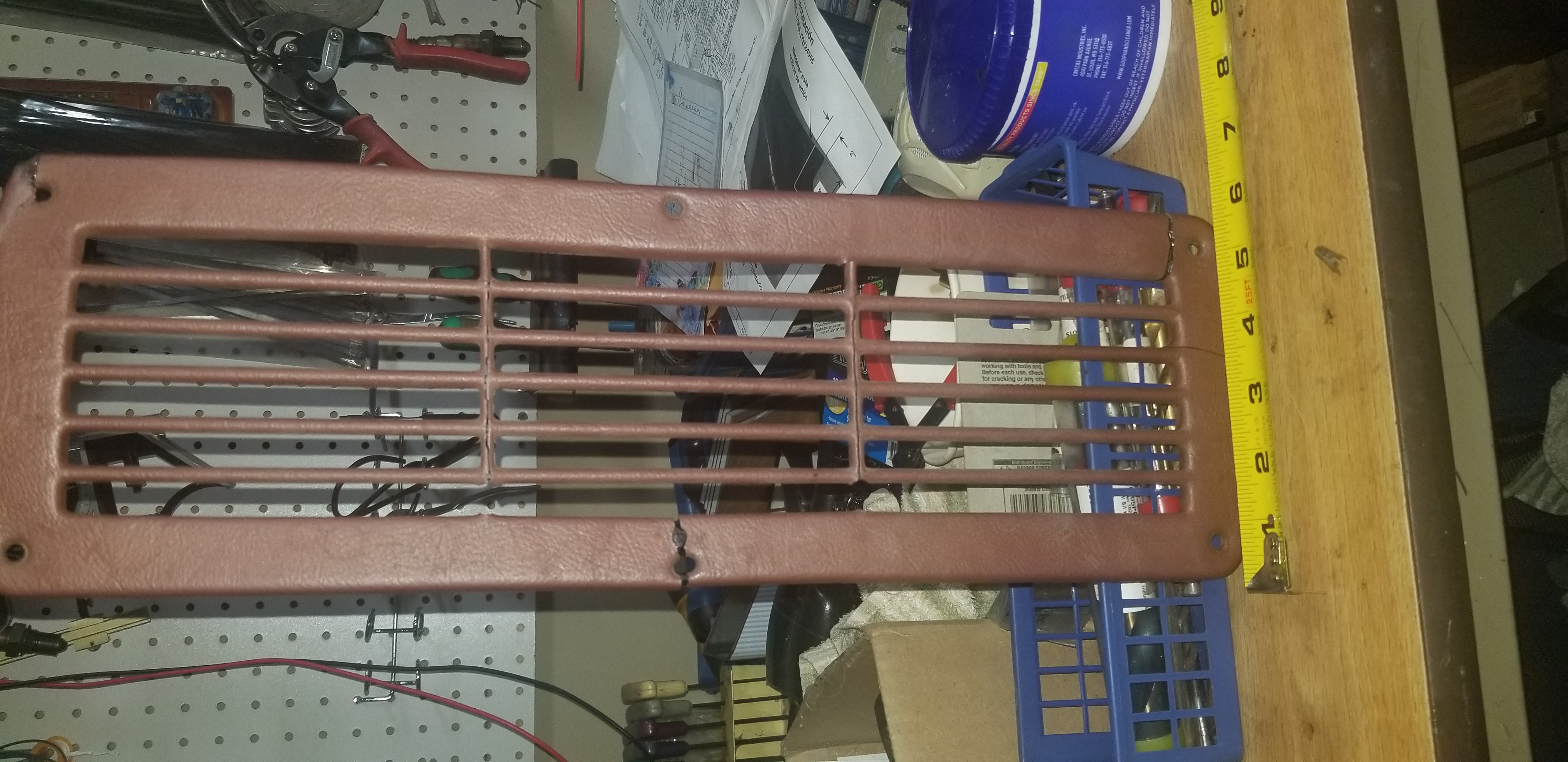

OK, here are a couple more photos. In sitting thinking about it if you made a print of HALF of it, it could be glued together with another half to make a whole one, easy to do. Also, the holes are somewhat picky on location, so lets say to ignore ALL holes and then drill them with precision. Whadda ya think? Now of course we need a couple hundred other owners to pitch in and one one too!
Also, the two center bars actually run from side to side, the two vacant places are lost items.
