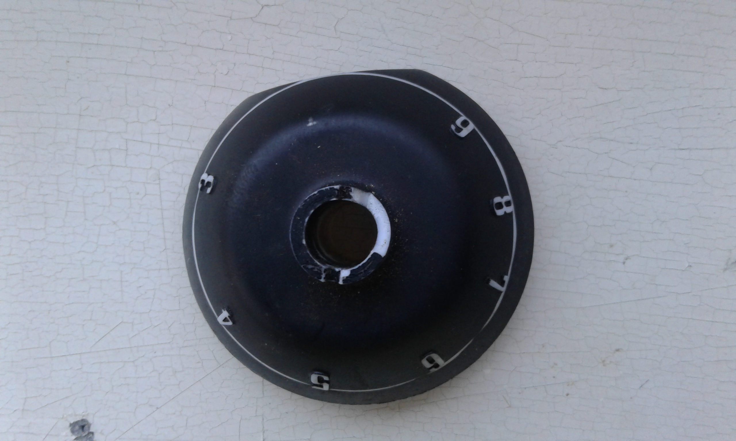

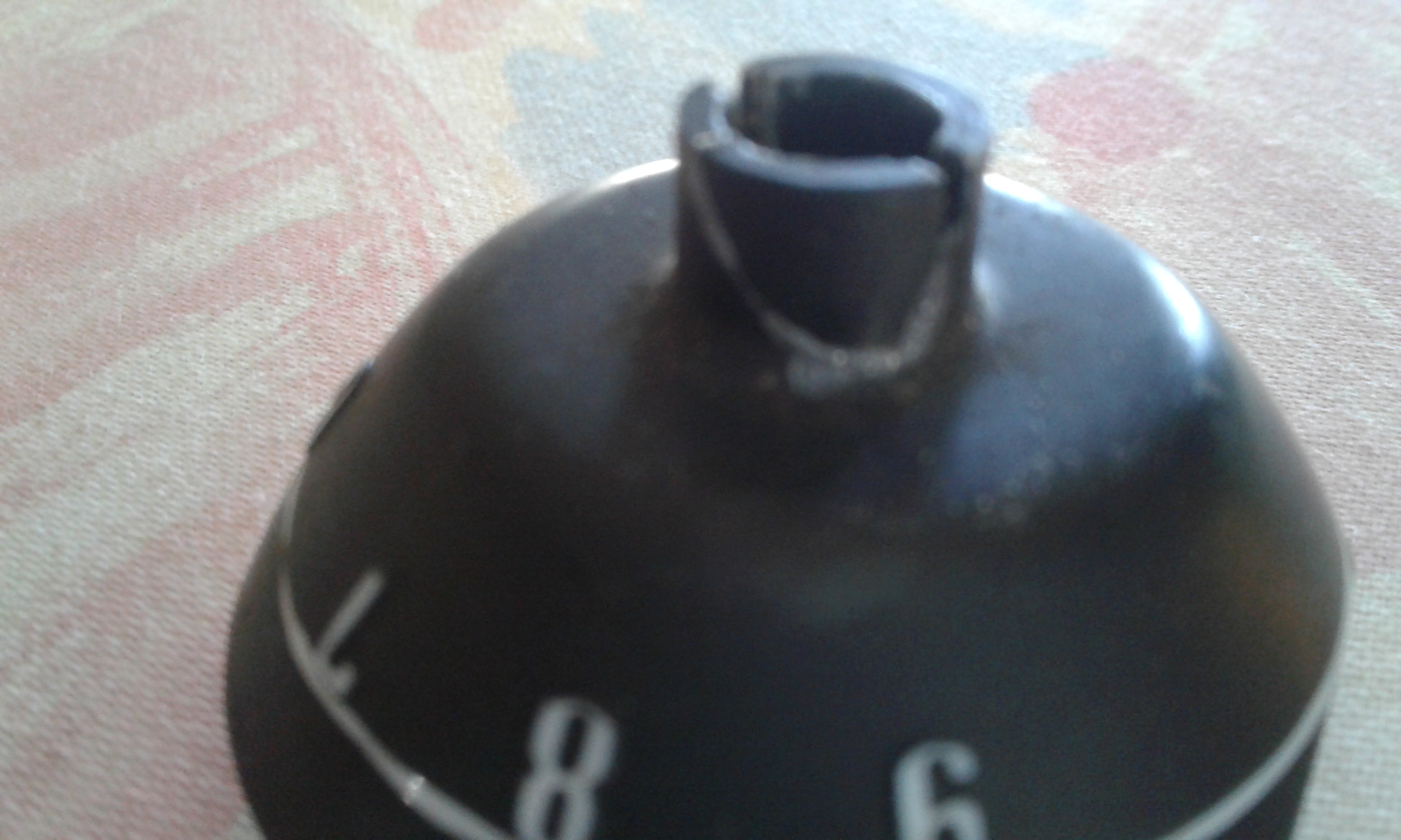

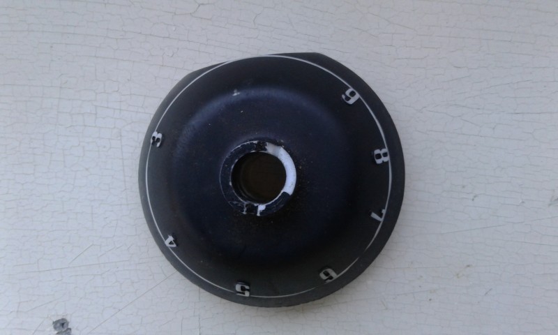

I was wondering if anyone know what type of plastic the indicator for the Autopilot is and what glue might work.
I have the piece that is missing and would like to glue it back together hopefully.
I would be interested in purchasing a replacement if the price is not outrageous.
Re: Autopilot indicator repair
I personally would use a little jbweld. Be careful and use just a little bit and I promise that little plastic piece will never come off again... at least not at the same spot.
I have used JBWeld but the gray stuff. I see they have one for plastic, you are suggesting that one?ImperialAtom wrote: Mon Jun 08, 2020 10:12 pm I personally would use a little jbweld. Be careful and use just a little bit and I promise that little plastic piece will never come off again... at least not at the same spot.![]()
If they have one for plastic then it might work even better. The plastic version may be designed to have a little flex to it to avoid breaking the plastic it's sticking to - don't know. I'm used to the typical gray stuff too, and never had a problem with it sticking to anything. Just remember to use a little, you shouldn't need much, and wipe away any excess that squirts out to avoid it showing. If there's any gray showing, just paint it black and you'll never see it.
Thank you. I'll keep everyone posted.
I use JB brand clear 5 minute epoxy on things like this.
didn't even know they made a clear version... that would be ideal for things like this.

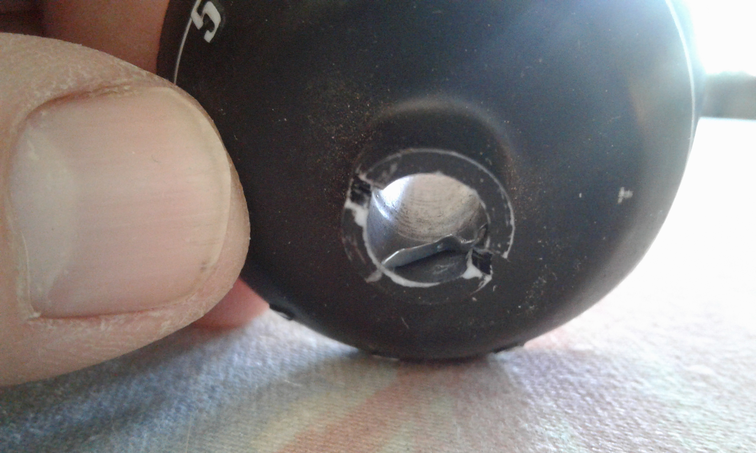

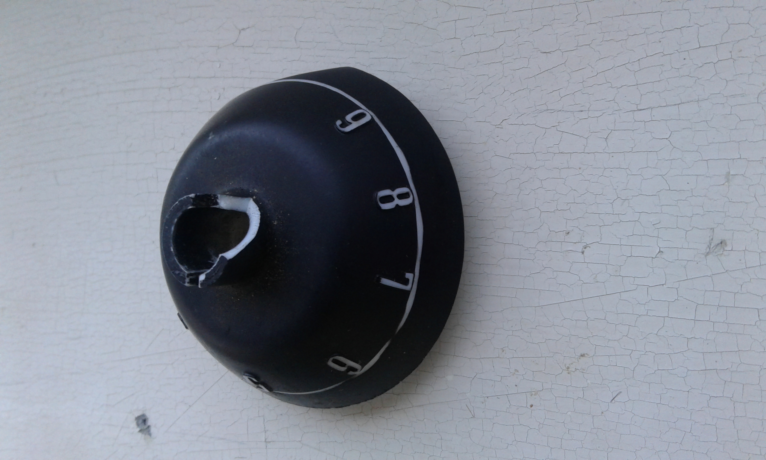

Just an update, got it repaired. I'm not painting it as it will not show.
Sorry for the bit of blurriness. I have it all filed down. It fits on fine. Now for the install. Still working on an allen wrench to fit the ring that drives this dial. I did learn via the service manual, that the way to reach it is with the allen screw at the top.
