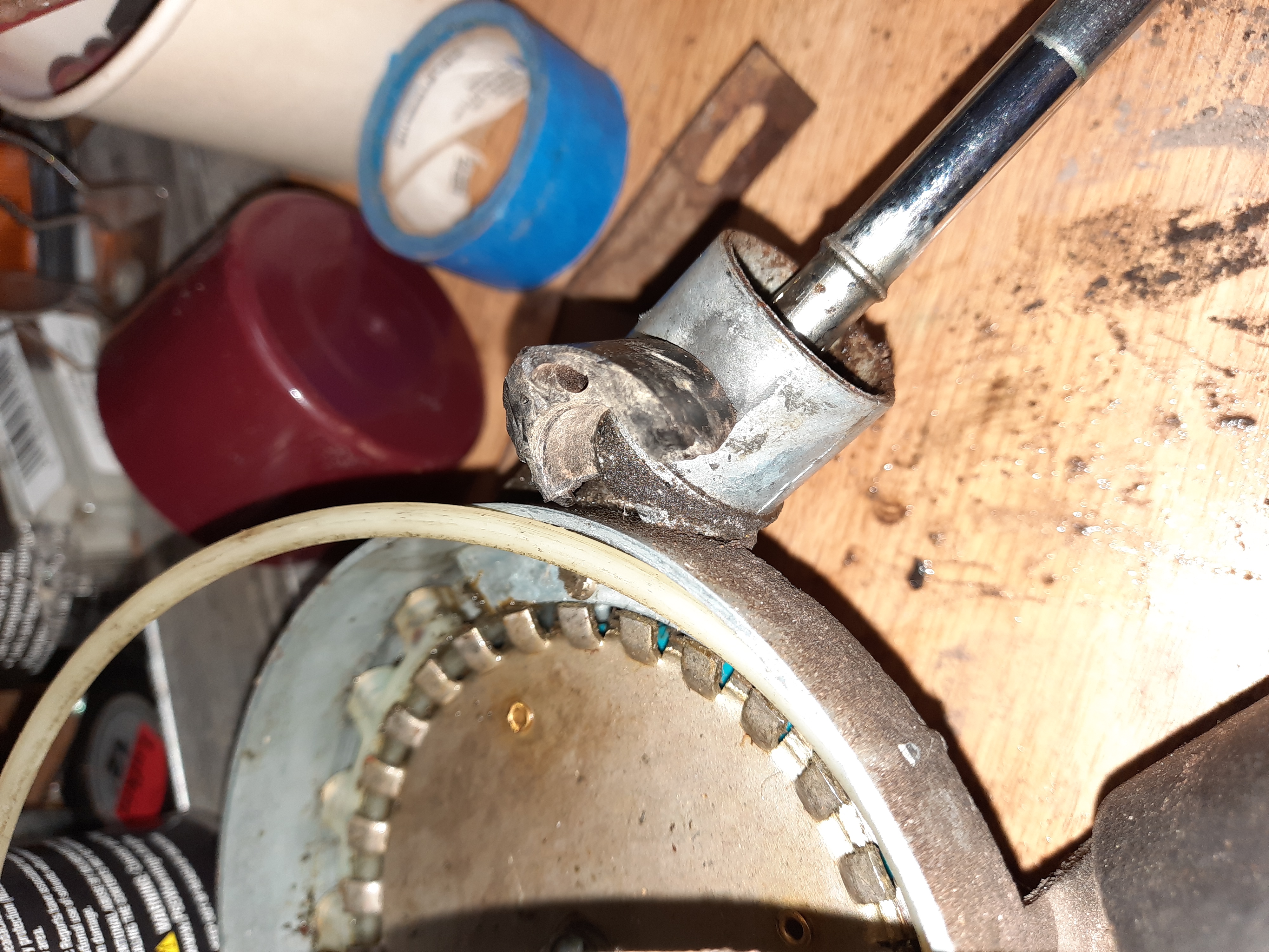

While apart for painting, I decided to overhaul my power antenna. I got it apart, all the important stuff is there and in find condition, but missing some easily replaced bushings I think. The problem i have is that I cannot find how it originally was made so that I can reproduce whatever is broken or missing.
Has anyone repaired theirs or even more desired is photos or drawing of what was there and how it worked. Surely somewhere in the world there is a parts diagram or photos of them? I am sure they used the same one for many years, and I am of the opinion that other cars used the same antenna.
Help!

There is parts of one bushing left, apparently it retained the initial section into the motor housing to keep it from coming out the top. It appears to be bakelite or some hard plastic stuff. I can easily turn one in my lathe if I only had a look at the complete original one. This photo shows part of it, part is still in the gearbox, and some of it is long gone.
