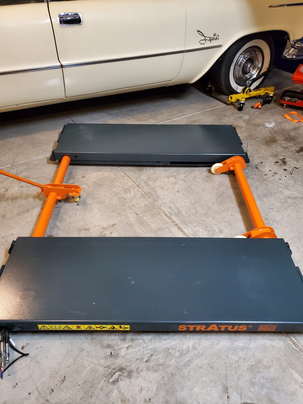

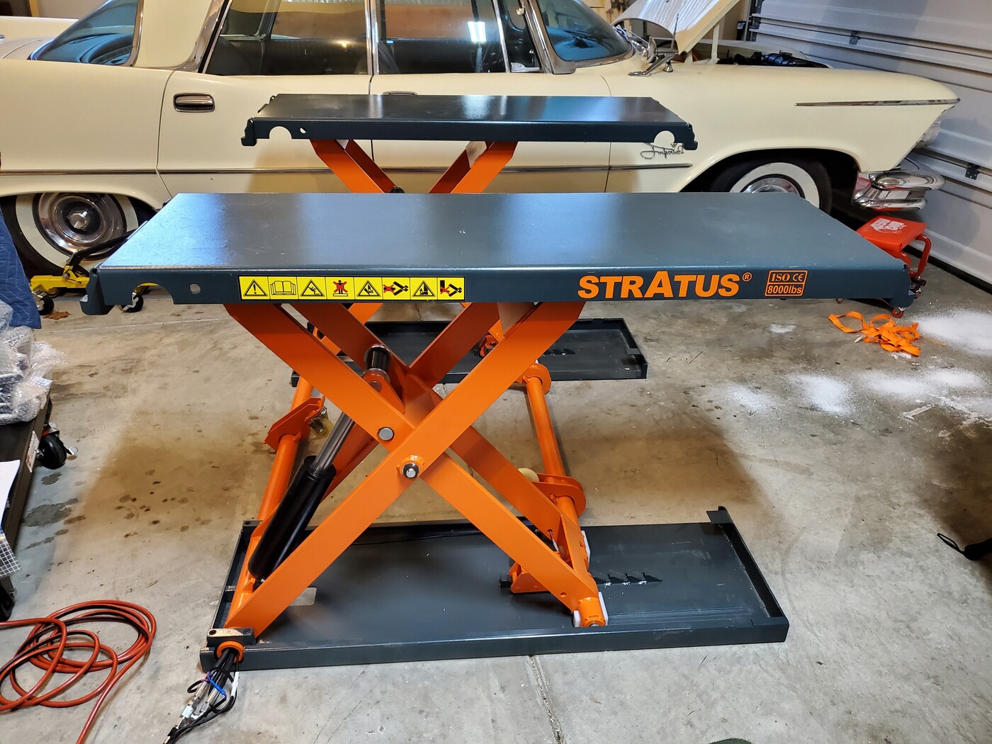

It's unpacked and working. Now just need to get the car turned around so I can slide it underneath and see how it does lifting the Imp.

Re: Garage Lift - Anyone installed one?
Looking good!
That really folds down tight too
I'd love to know how much on the underside is accessible with the car on this lift. The pads seem pretty wide but I bet it is very stable.
