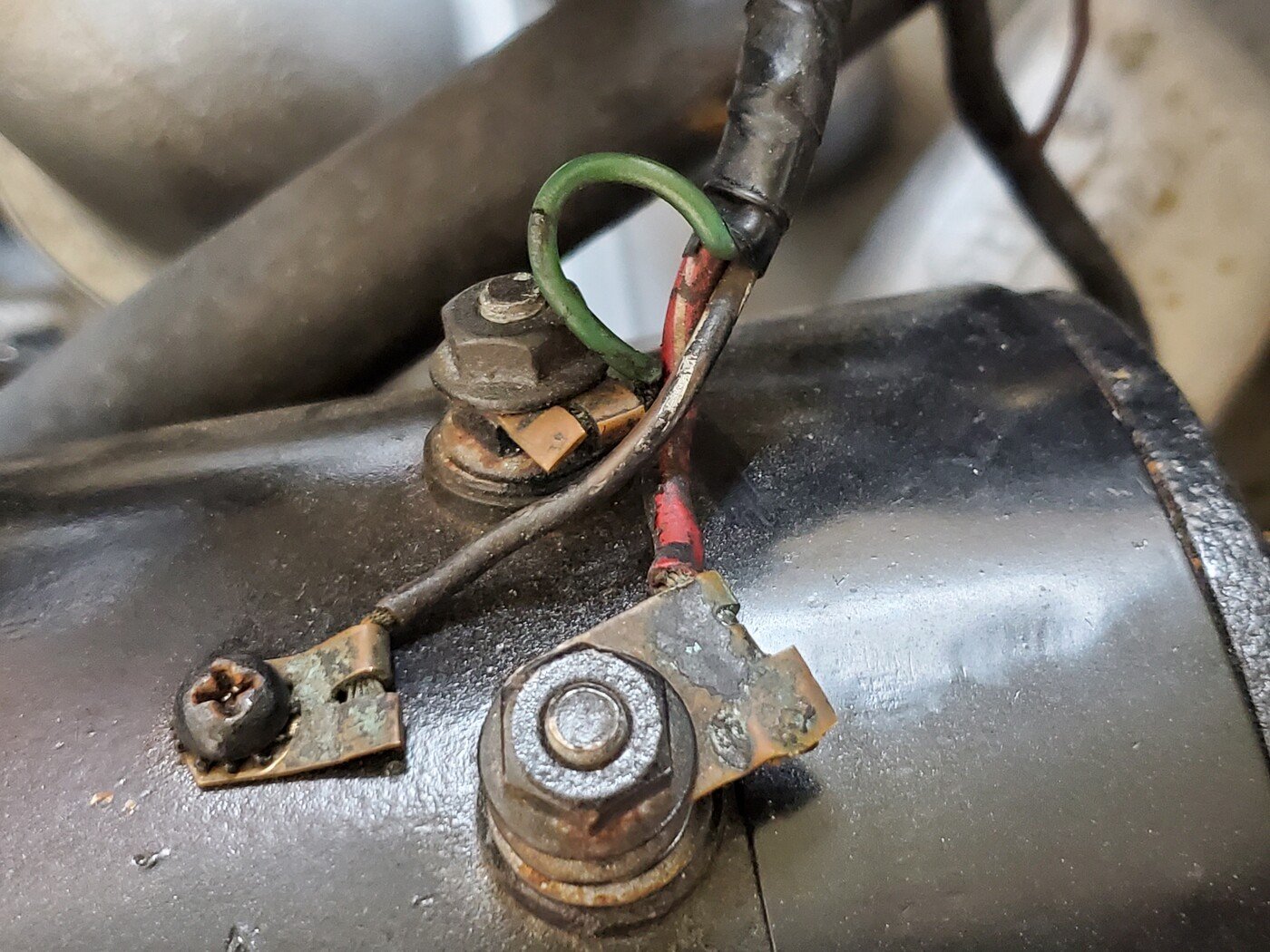

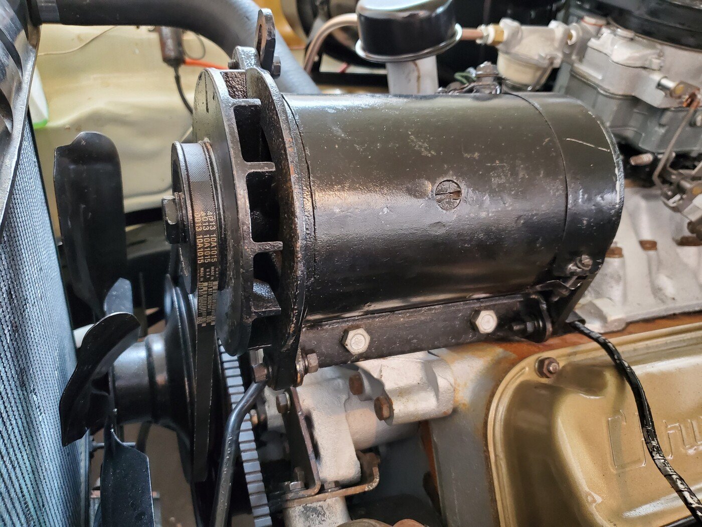

First thing to do is disconnect your battery. I have a quick disconnect, so if you don't have one of those, you may want to consider getting one, they do come in handy.

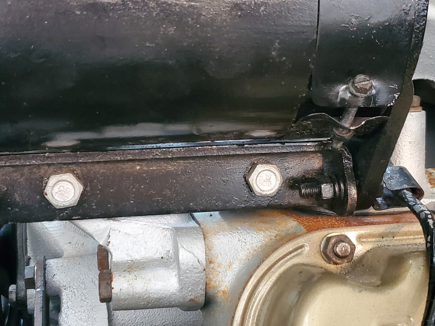

Next you'll want to unbolt the generator from your engine. When you loosen the top bolt, it will likely swivel, which is ok, this is how you adjust for the belt. Just slide it all the way down to it's lowest position and the belt should pop right off. You'll probably want to take a picture of the wires and where they go before you take them off. The only bolts you'll need to remove are the one holding the wires on, then the top bolt that holds the generator in place, and then two more bolts, one at either end of the generator that hold it to the mounting bracket and allow it to swivel. You do not need to remove that mounting bracket you can see in the last picture.

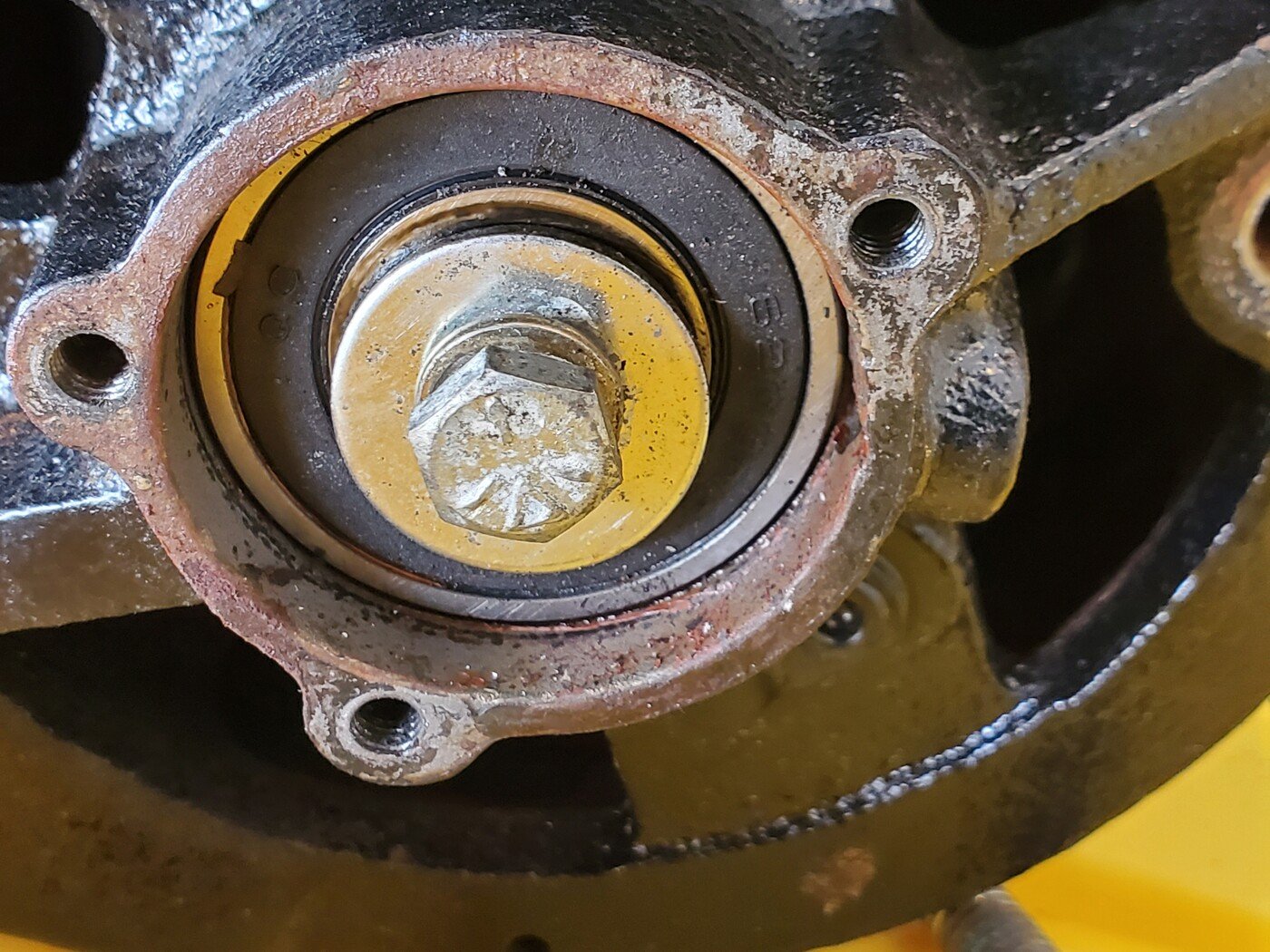

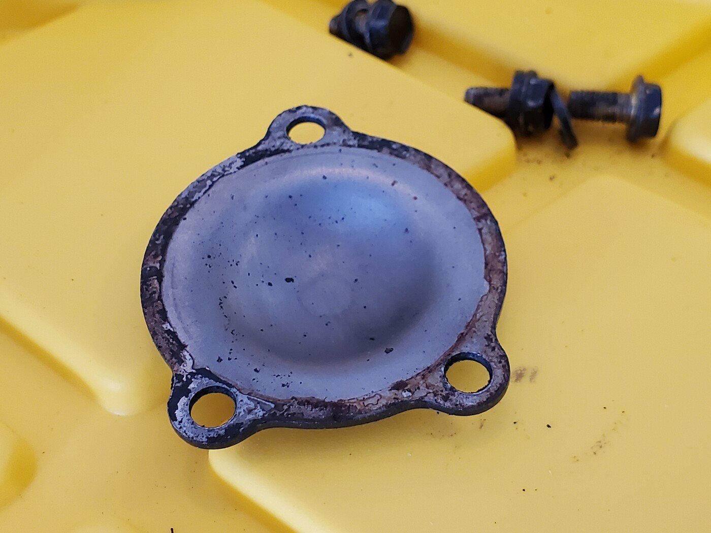

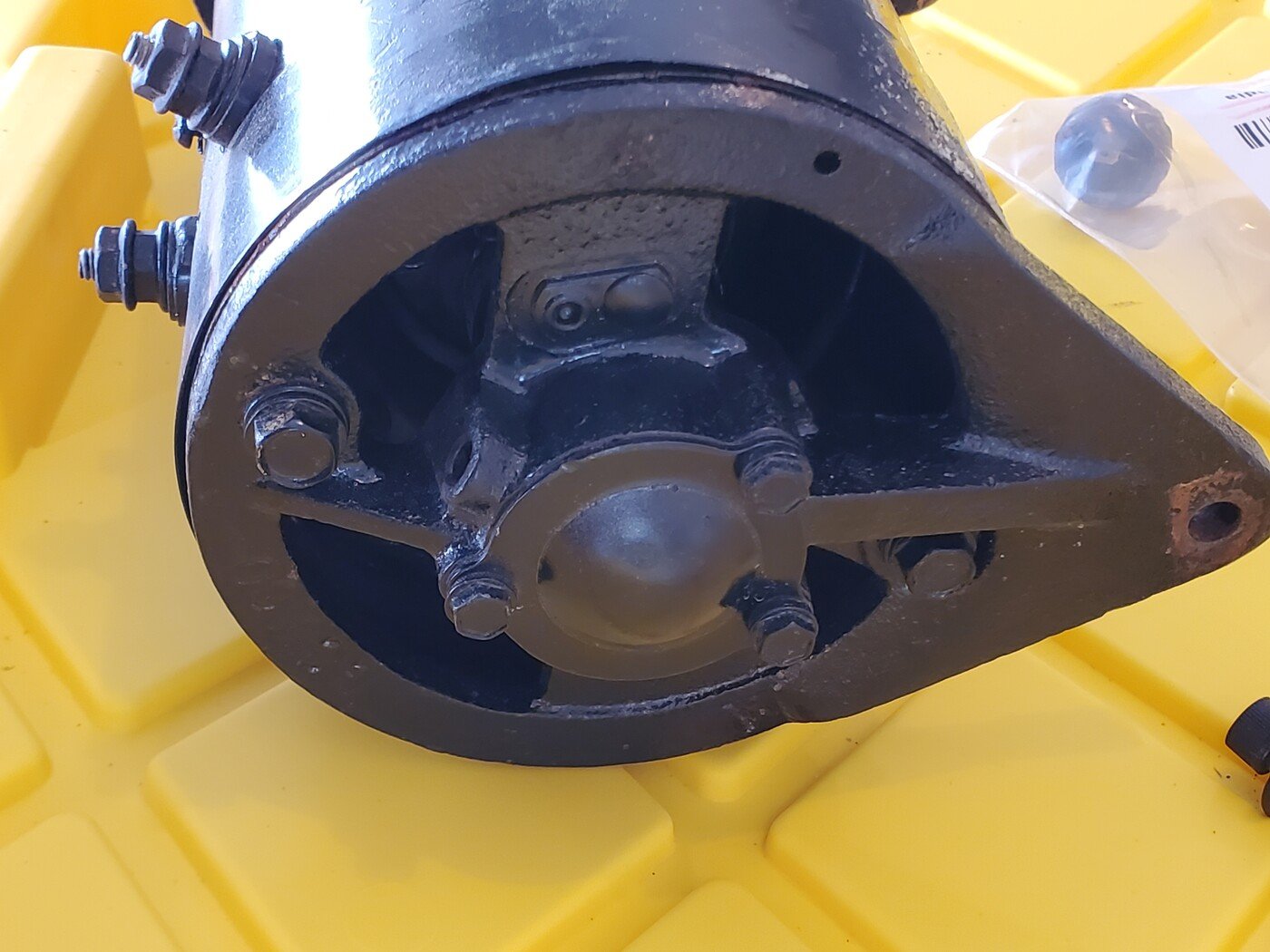

First thing I did was take the metal cap off of the back side of the generator. This allows you to gain access to a center bolt that is holding things in place. Next, there were two bold to remove near the edges of the back side. These were very long bolts that travelled the length of the generator.

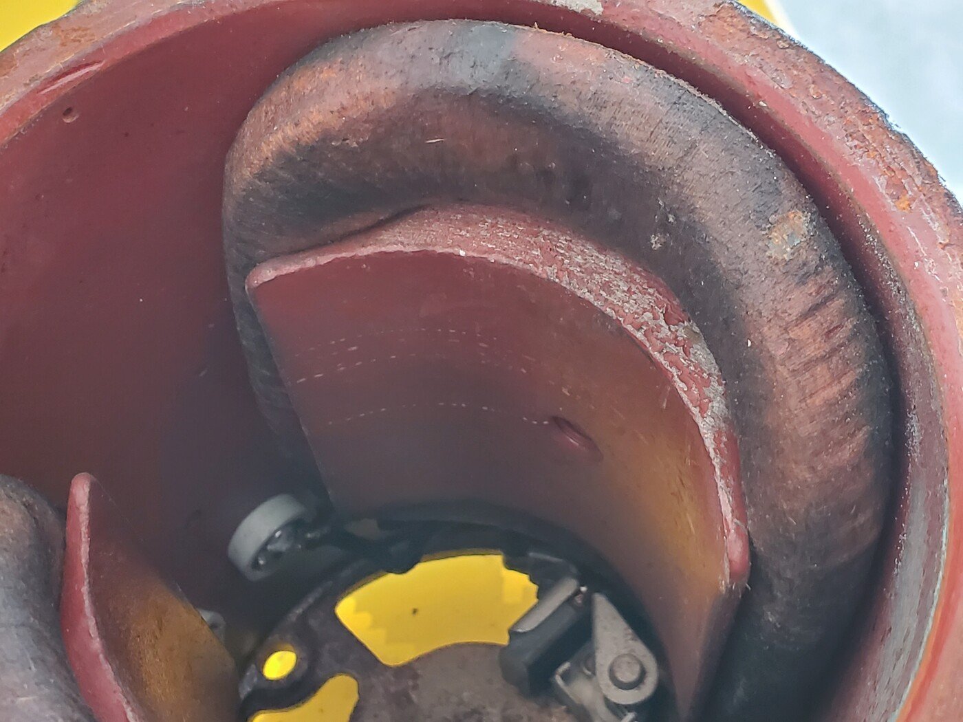

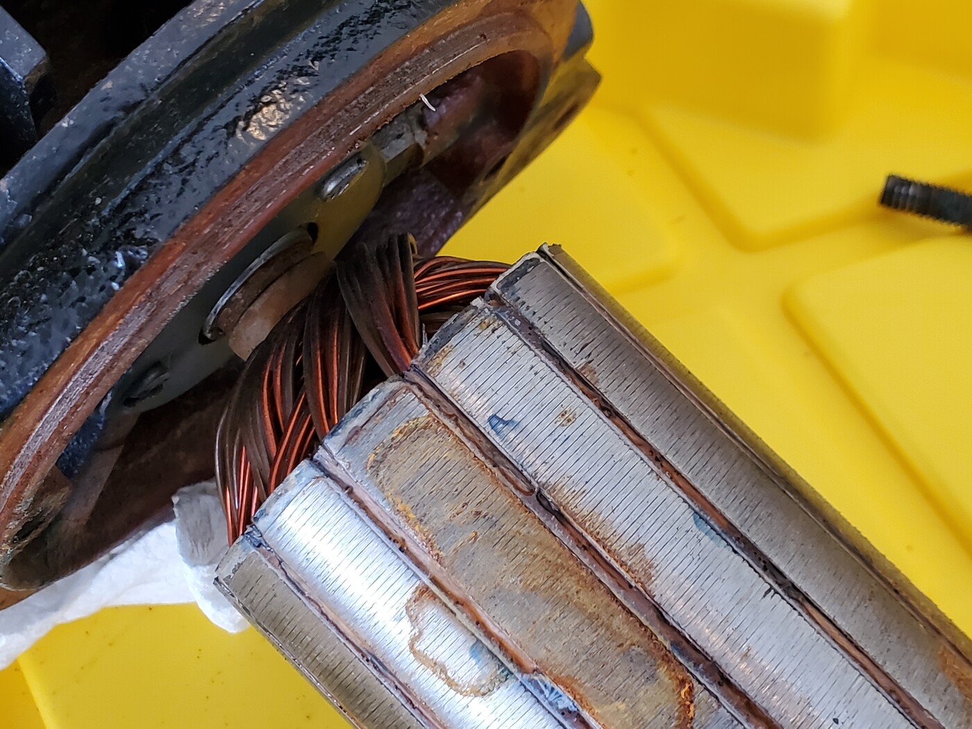

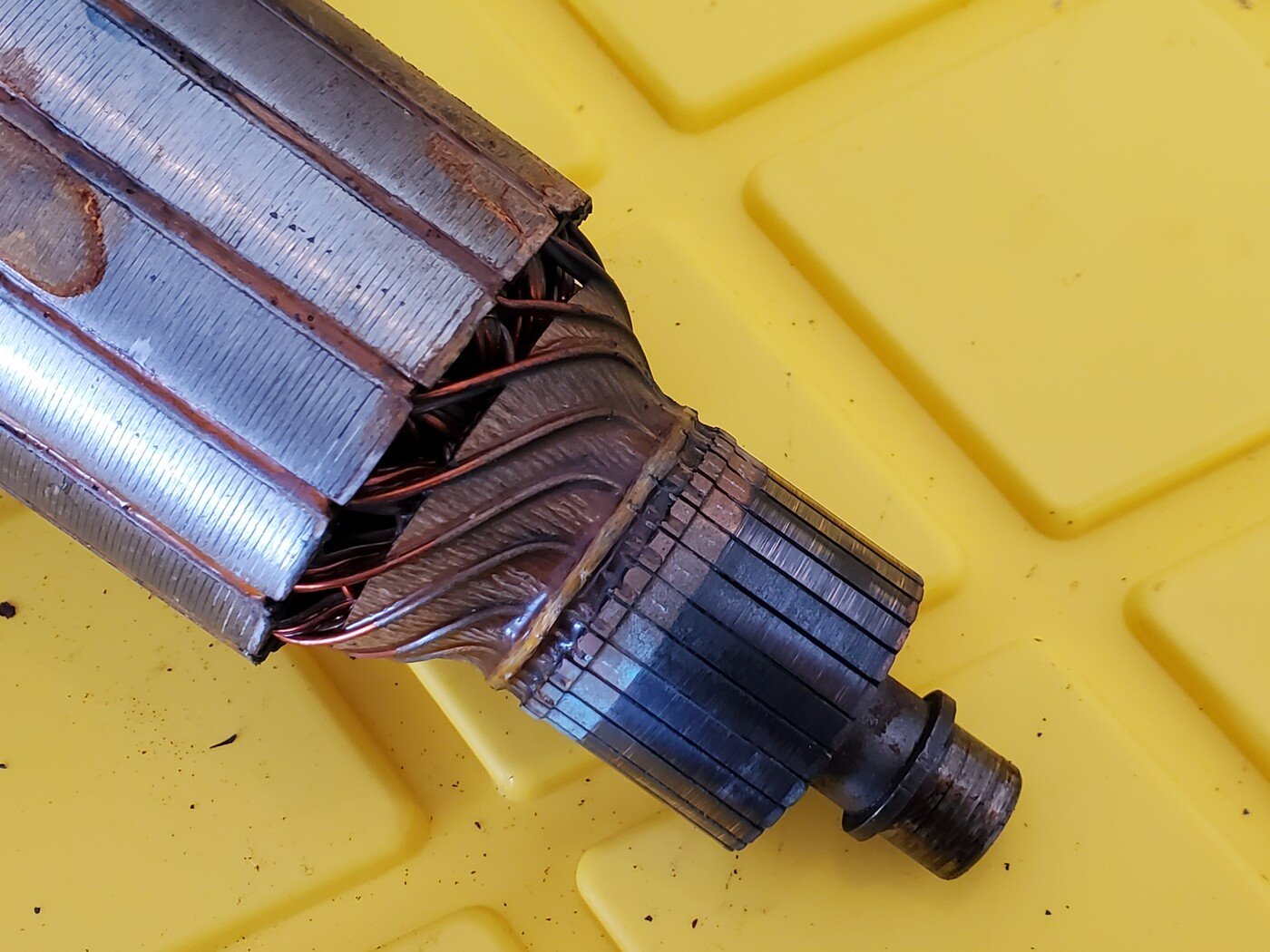

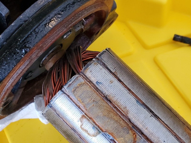

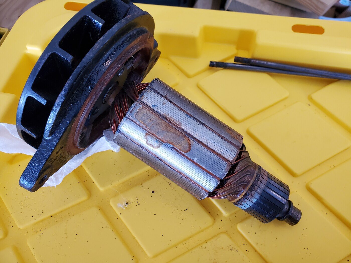

Now that the bolts are out of the way, you can slide the front side out. Mine was a little stuck, so I convinced by smacking it a few good times with a large screwdriver handle. Pull that entire front along with all the inner coils and such out and set those aside.
There was some rust on mine, so I cleaned that up.

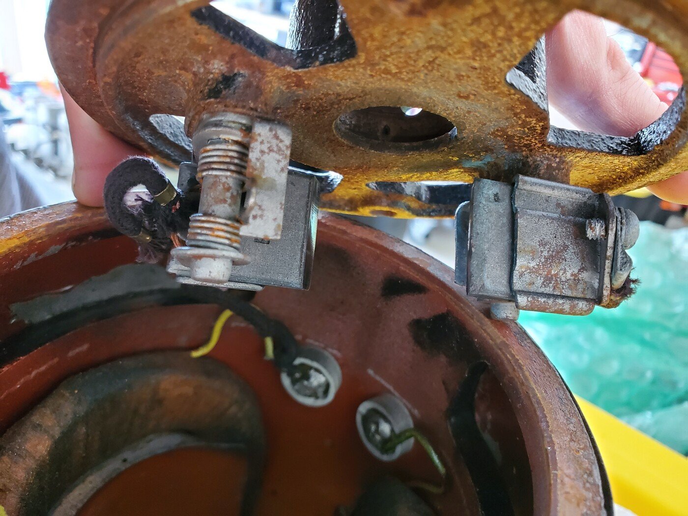

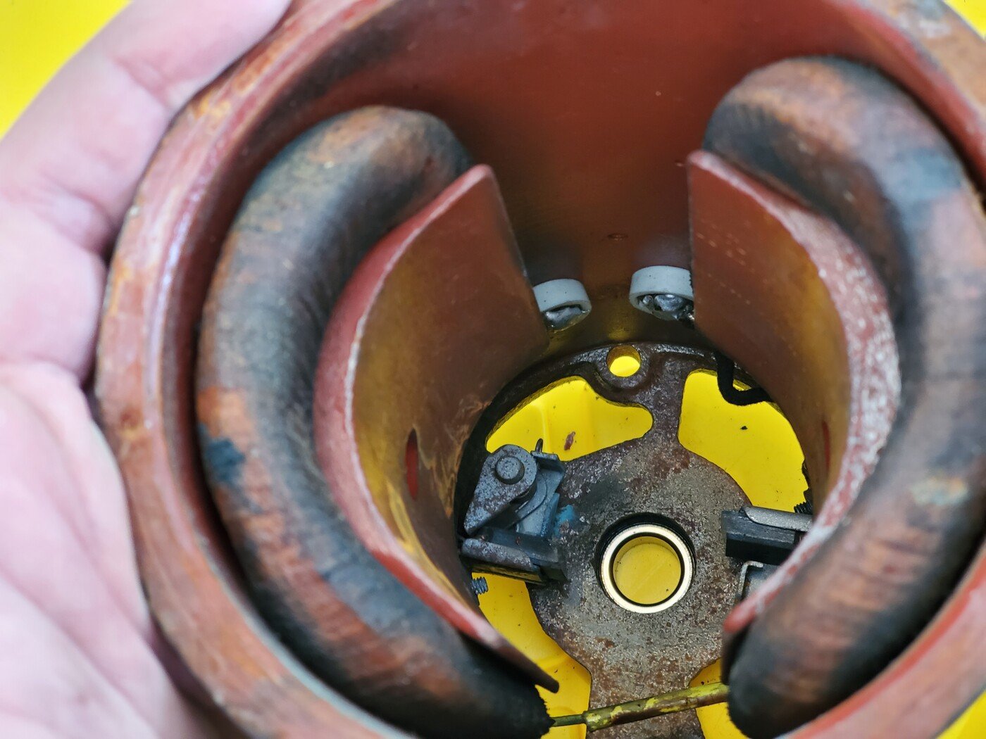

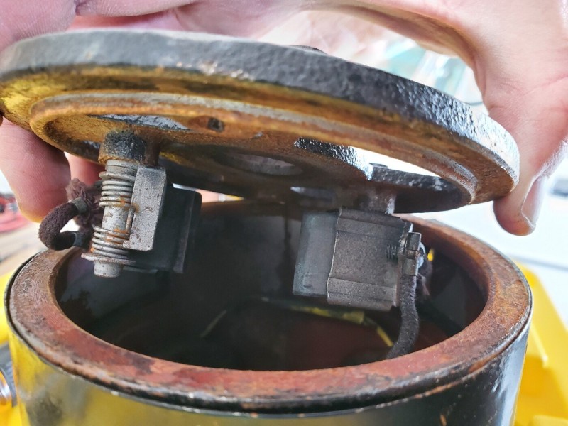

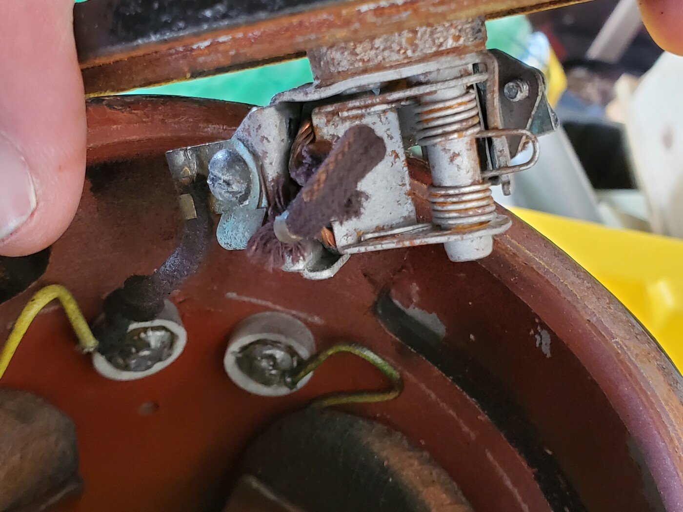

Then smack the back side cover if it's stuck and carefully lift it off of the center housing. It is attached to the brushes, so be careful. Simply use a screw driver to disconnect it and set that aside.
