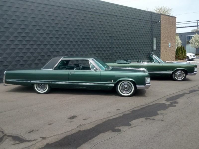

I owned the green coupe briefly last year(flipped it but miss it, it was stunning!)((don’t need 2 ‘67 coupes)).
I’m thinking of a similar size whitewall for my Impvertible. Trying to remember the brand.

1966 Imperials came from the factory with a triple-ring whitewalls. A wider ring was in between two thinner ones. I personally prefer the 1.625" whitewall like those on the green '67 coupe. My '64 has 1" whitewalls, which closely approximate what a 1964 came with.

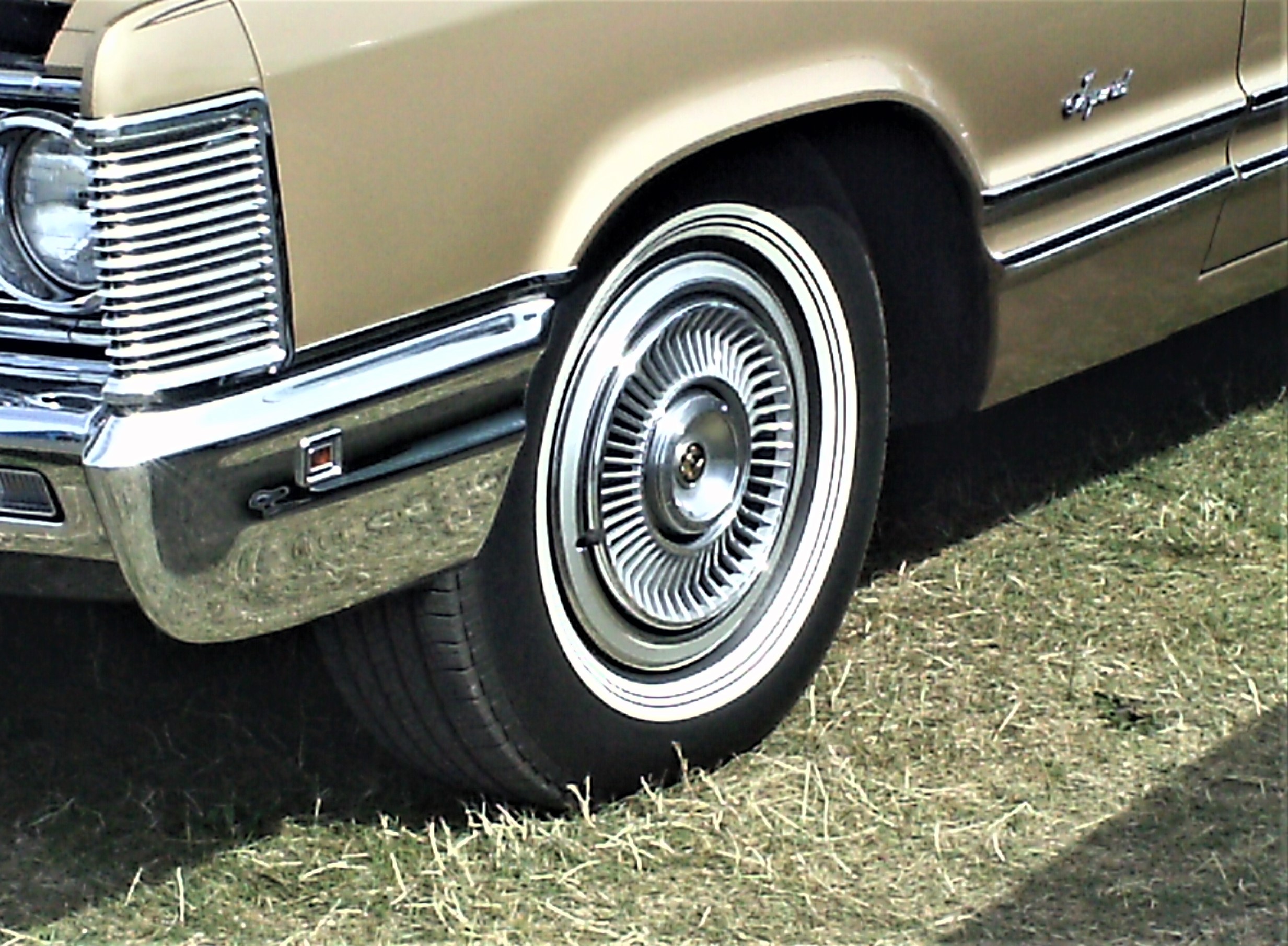

I took this picture (not my car) at Chryslers @ Carlisle a few years ago, This may be the Factory style that Crown64 mentions. I think Diamondback tires could make these .Coker probably bought them out by now.

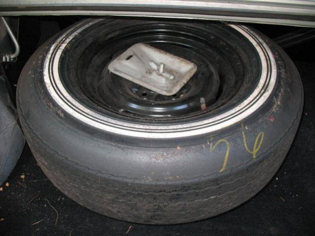

Re: Whitewalls
This is the original spare in my ‘67.
