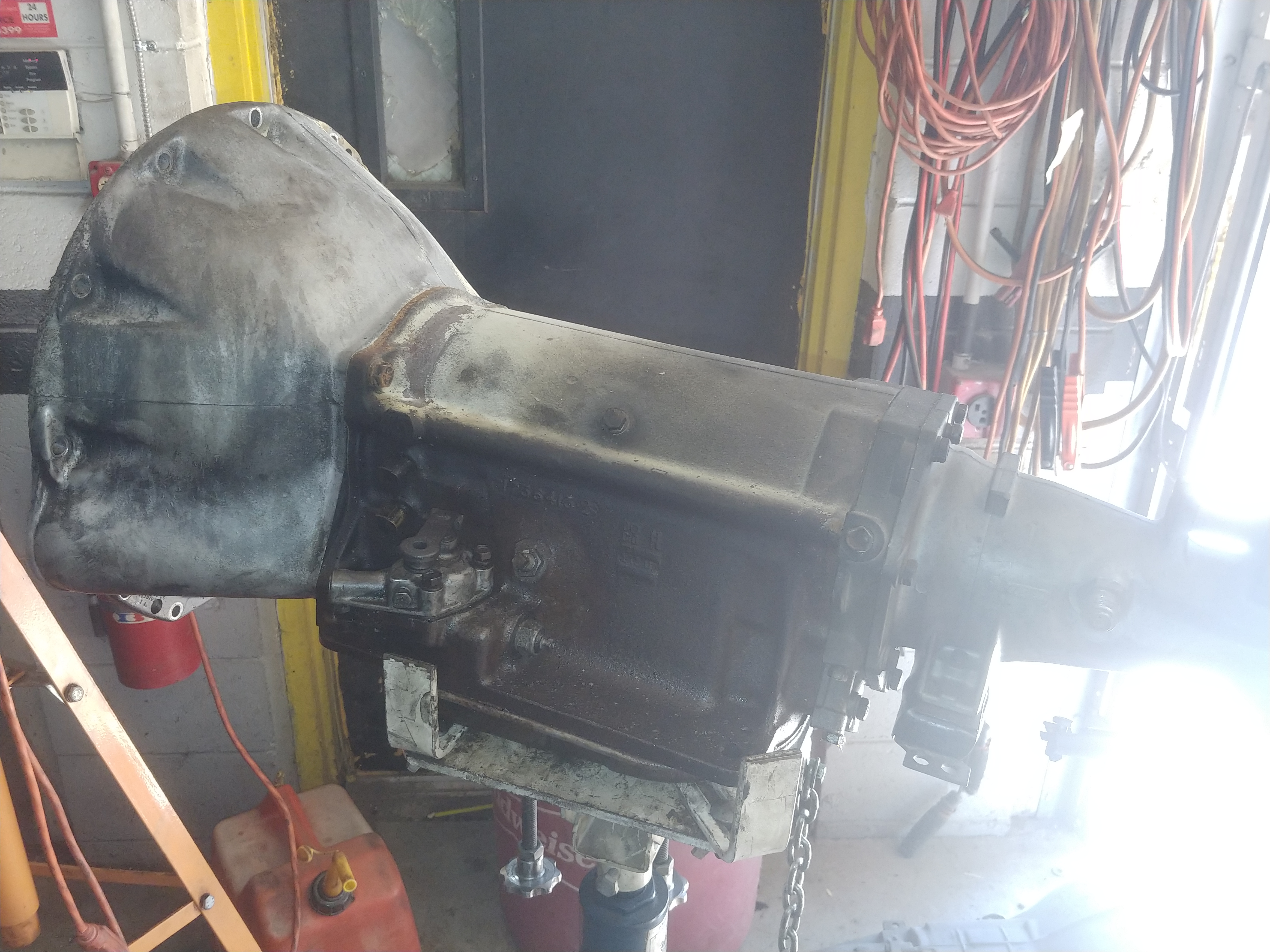

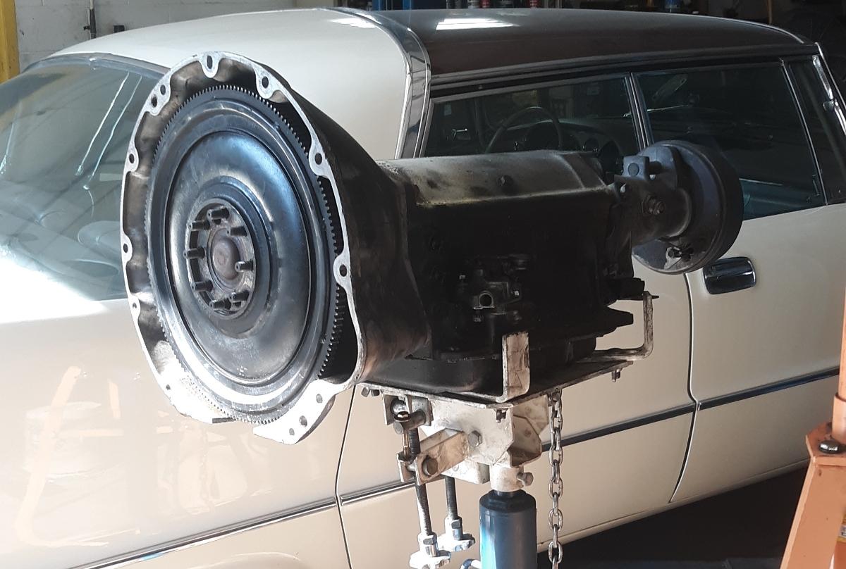

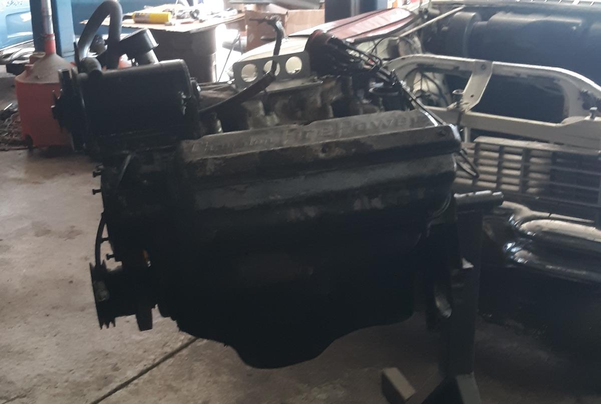

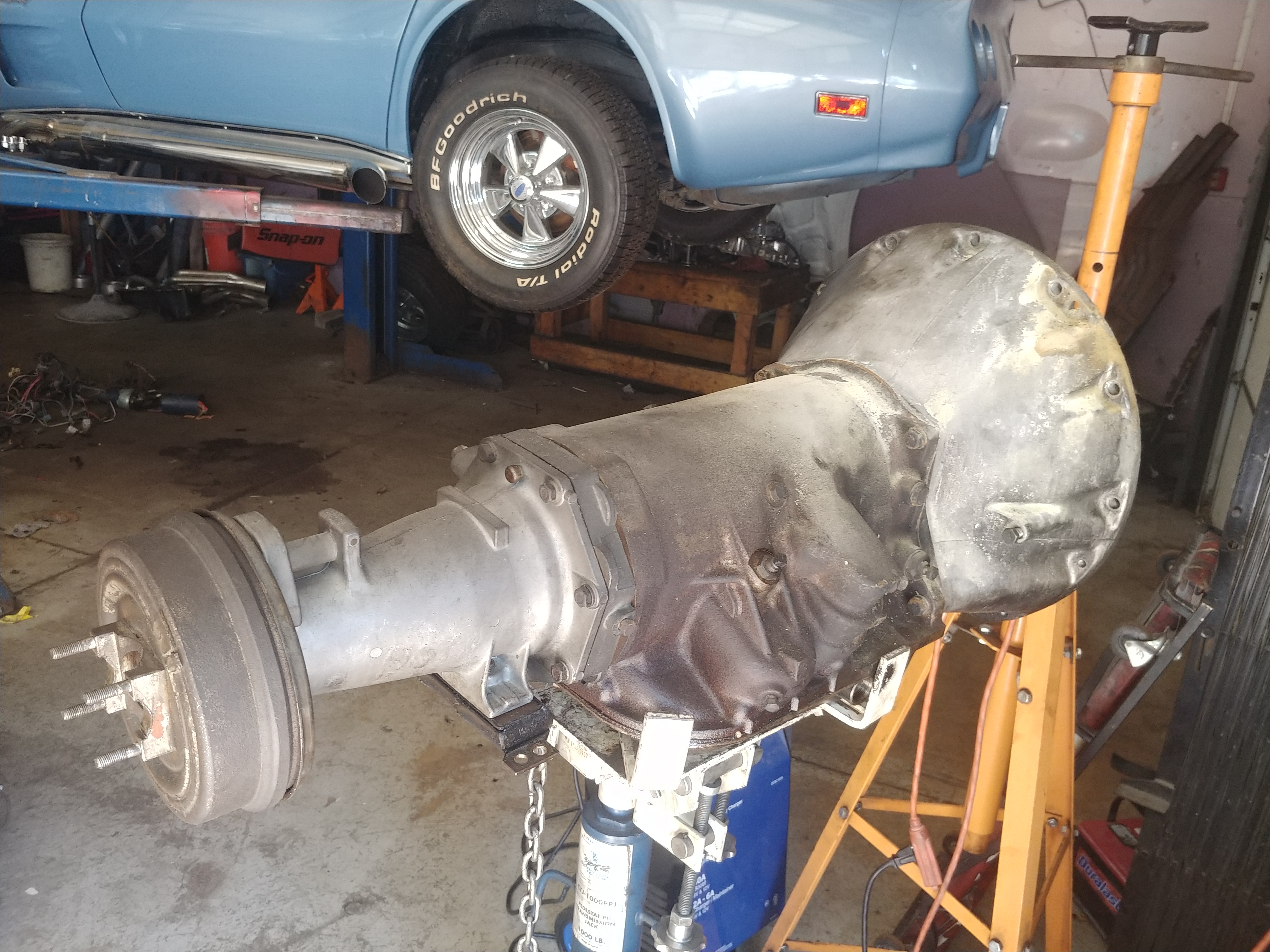

Had an engine fire last season and getting a shop to rebuild the engine. Never used them before, so I hope it goes well. Thought I'd share the pictures I have so far in case anyone was curious.

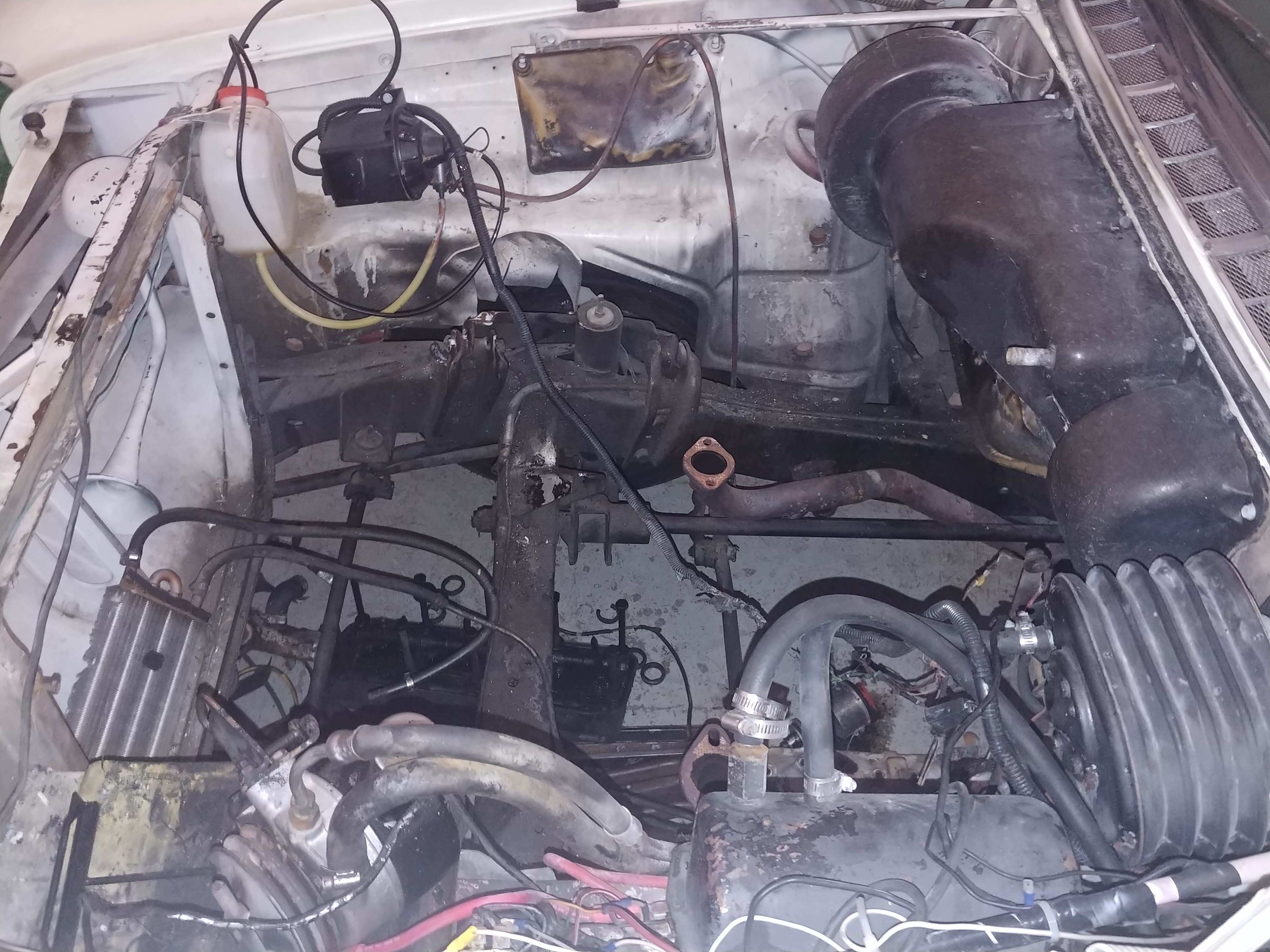

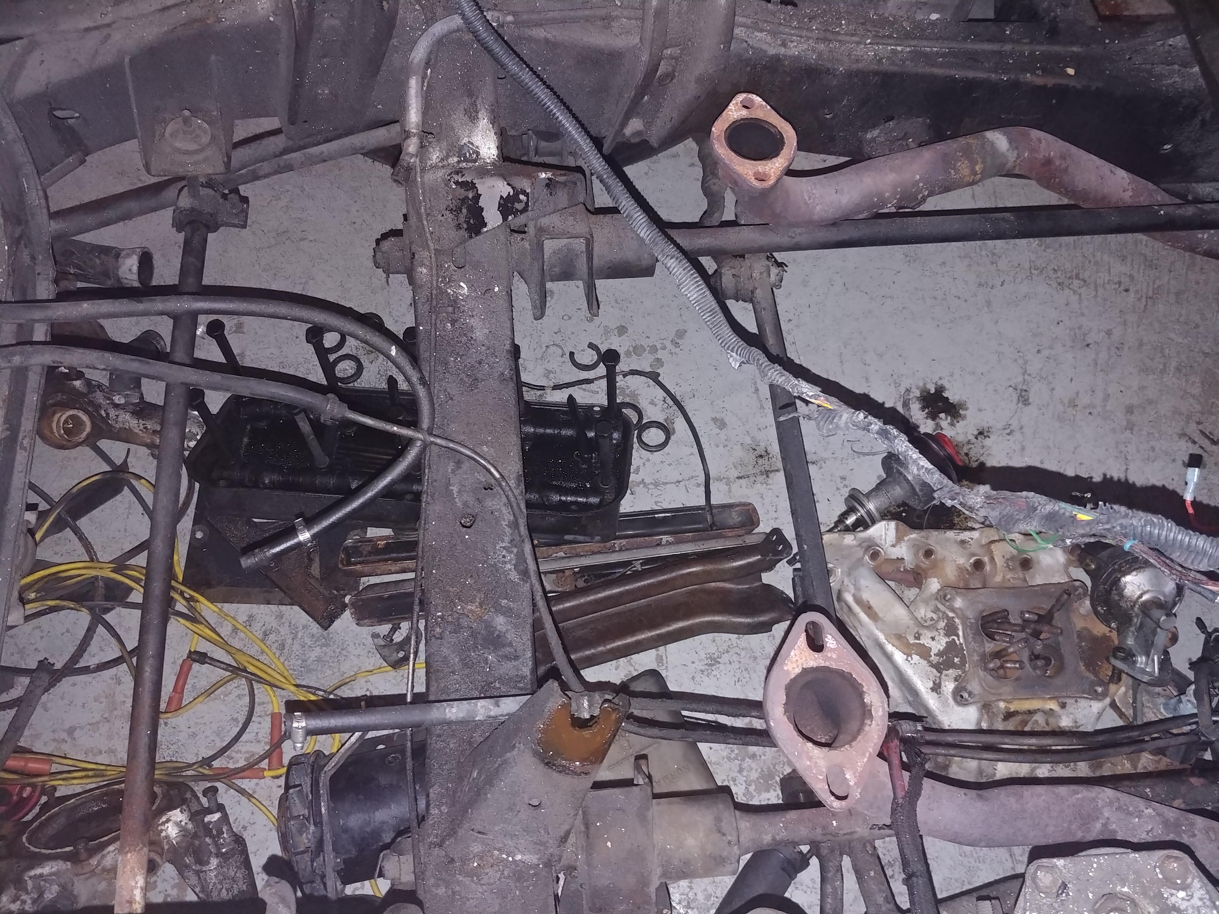

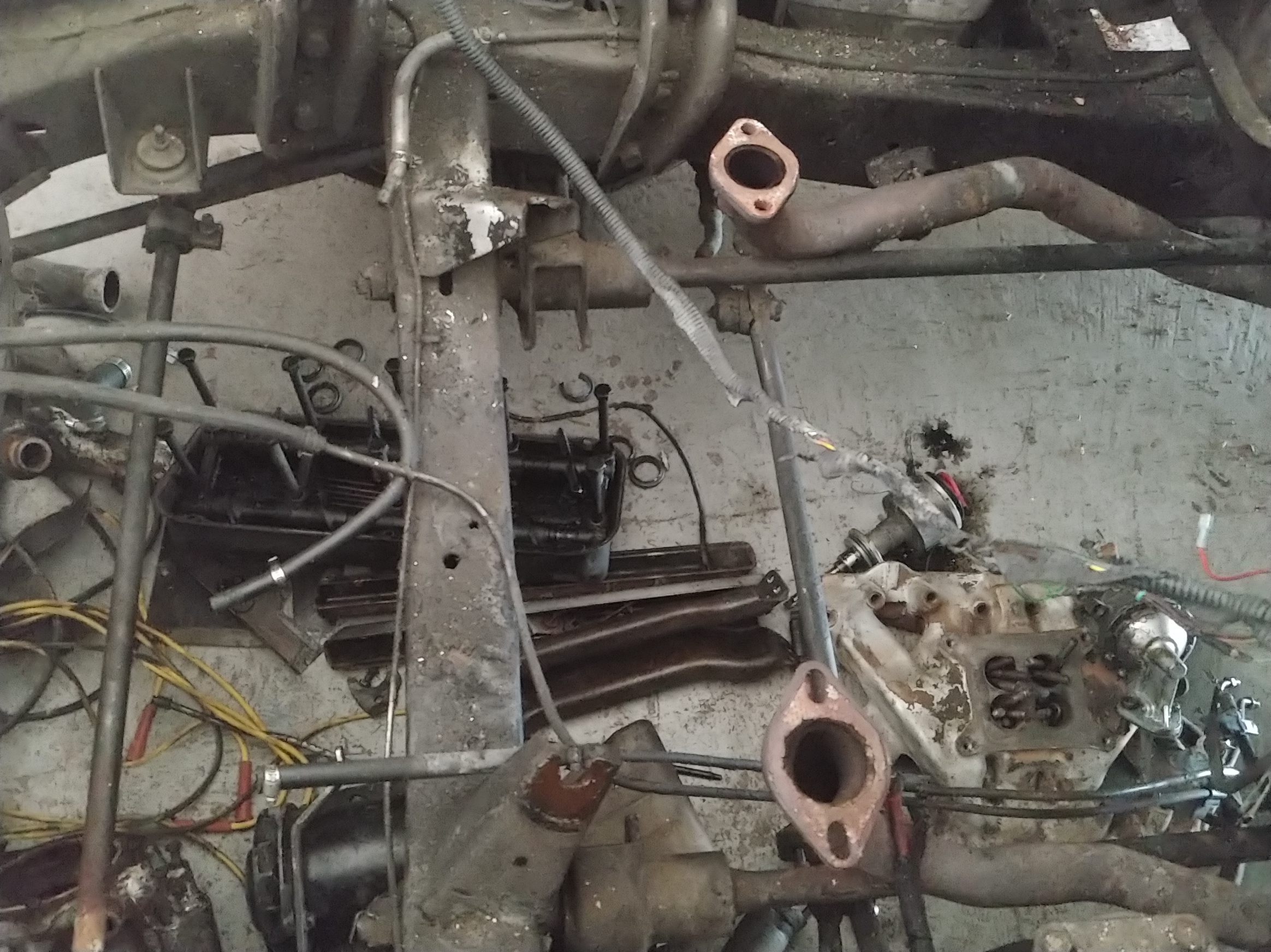

Some pics of the engine bay area...

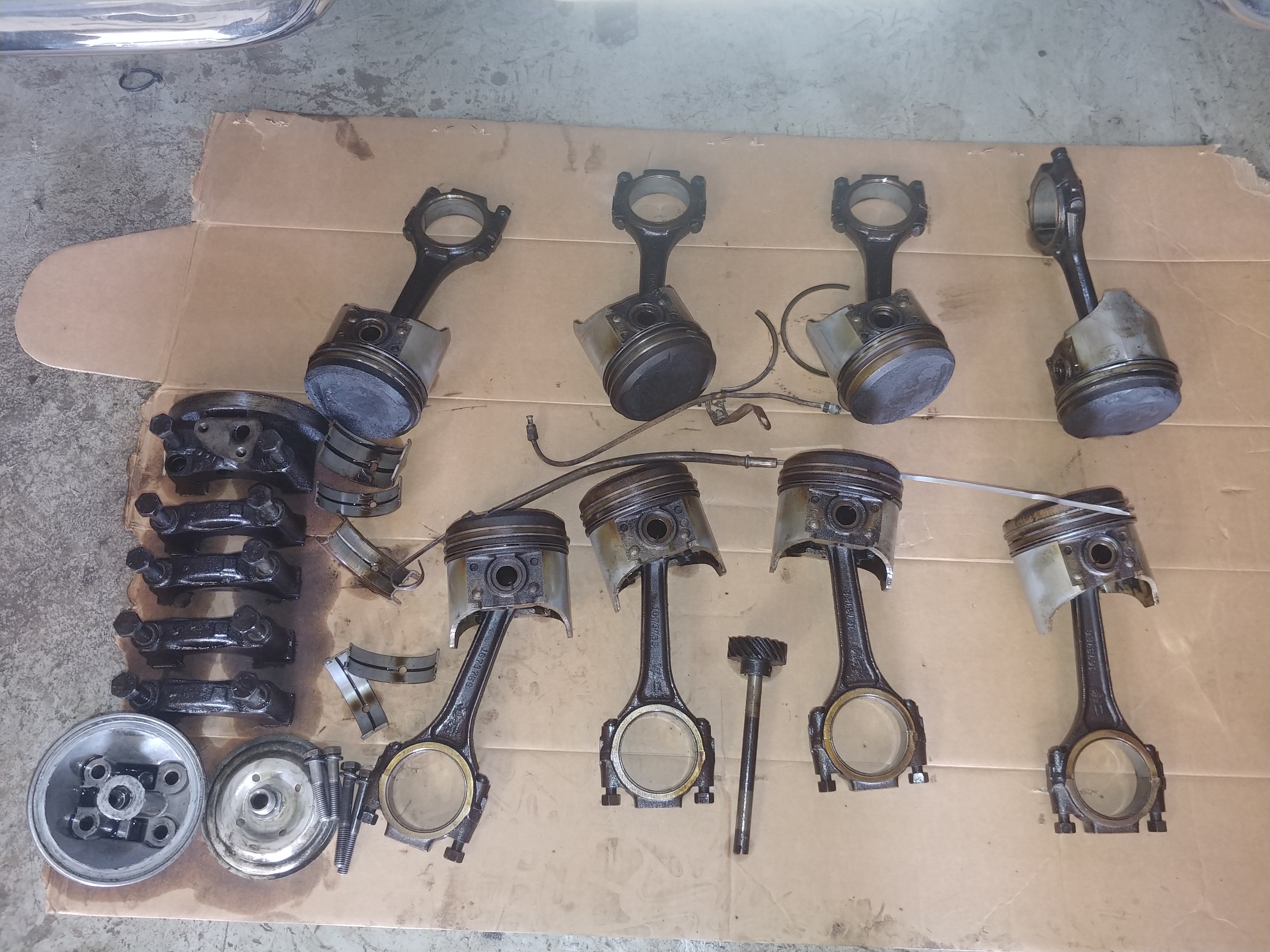

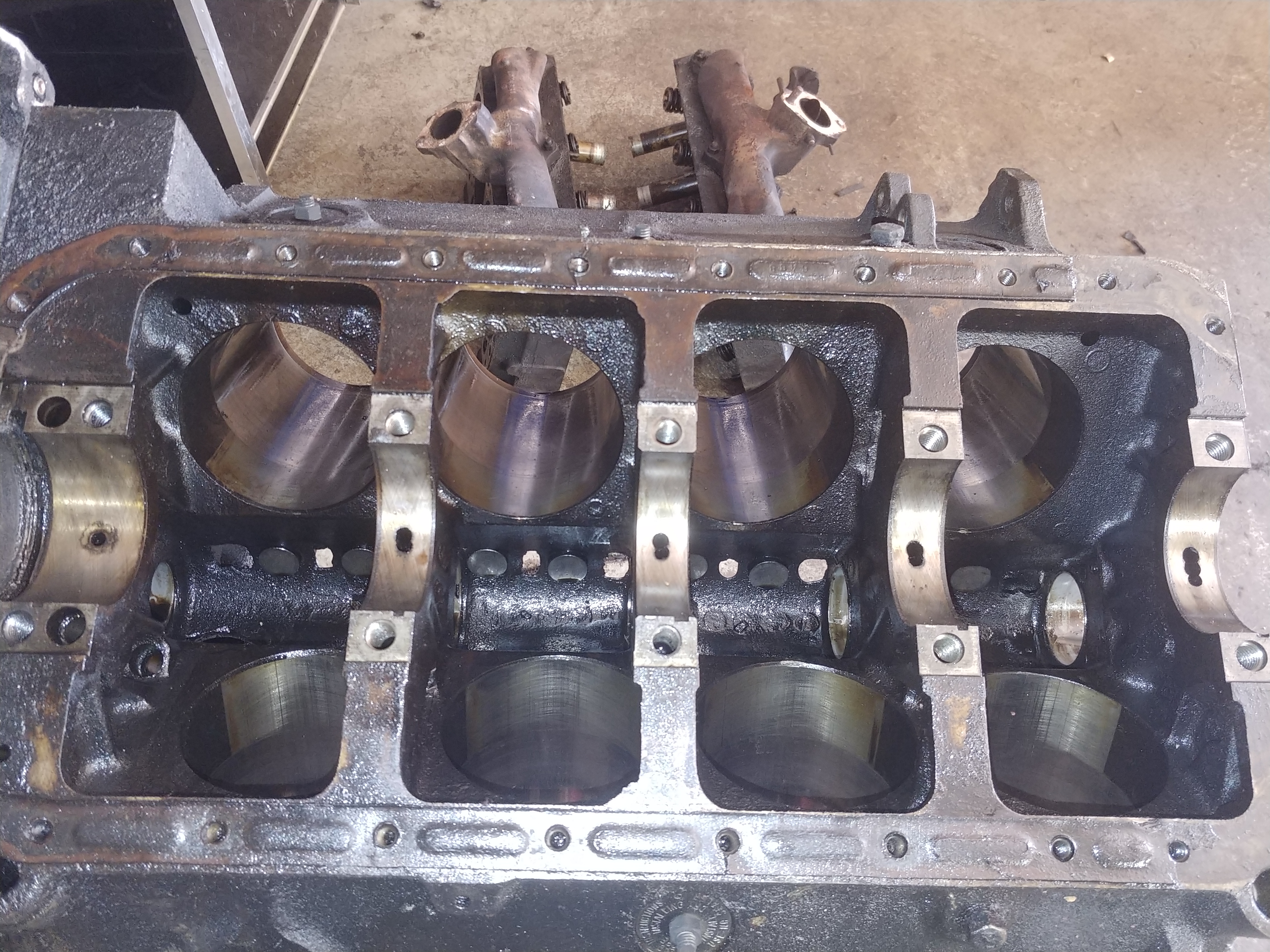

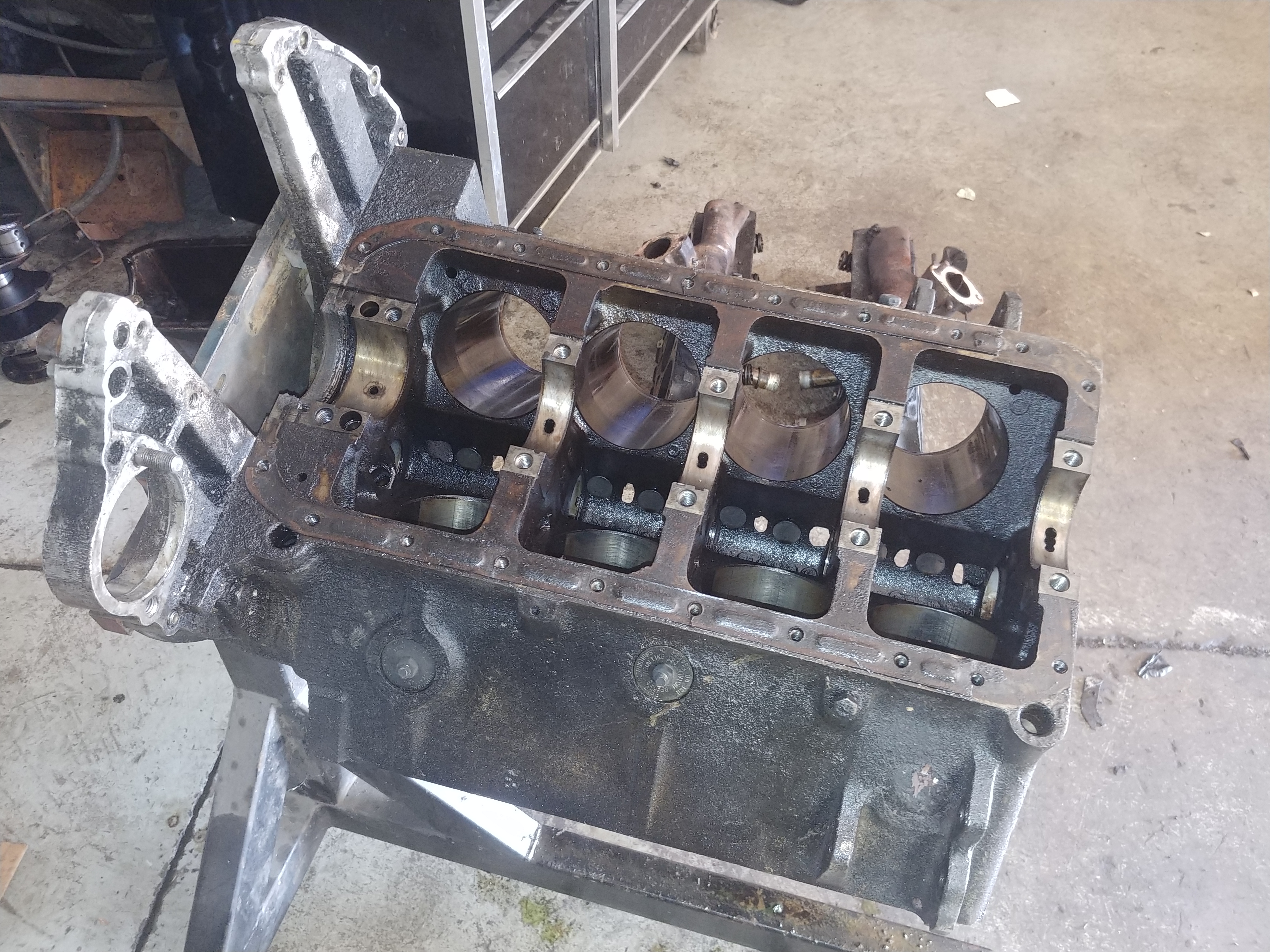

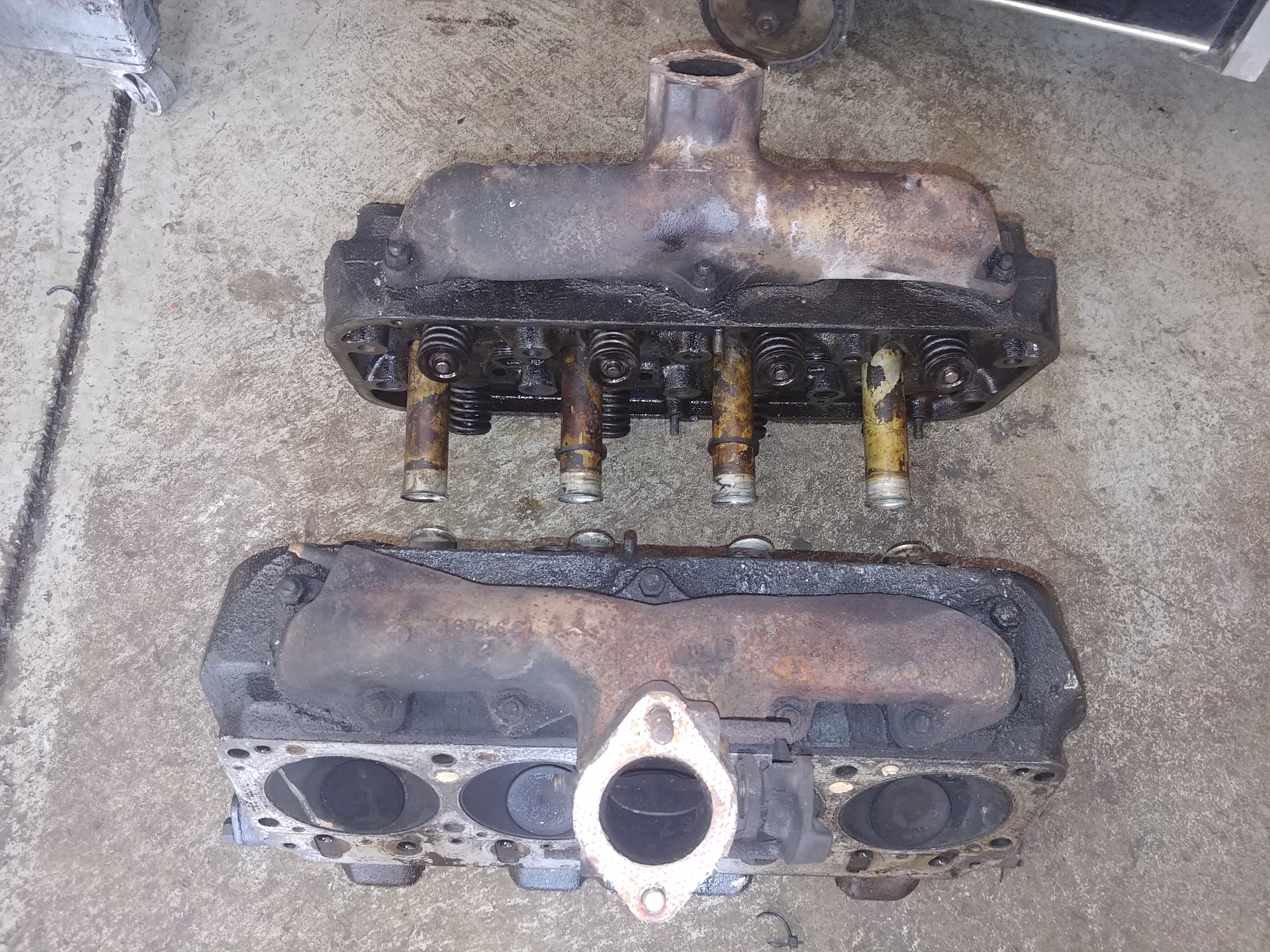

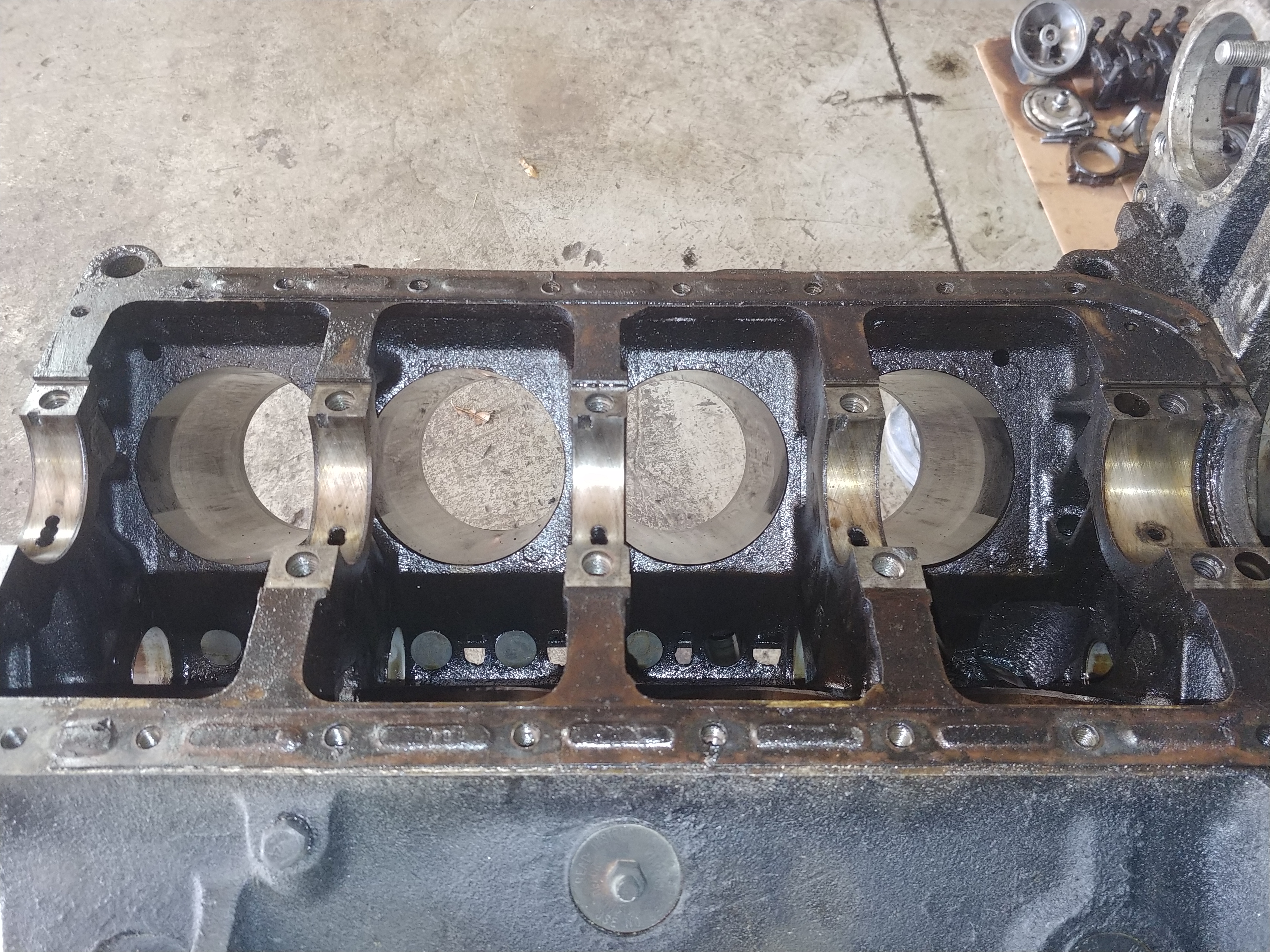

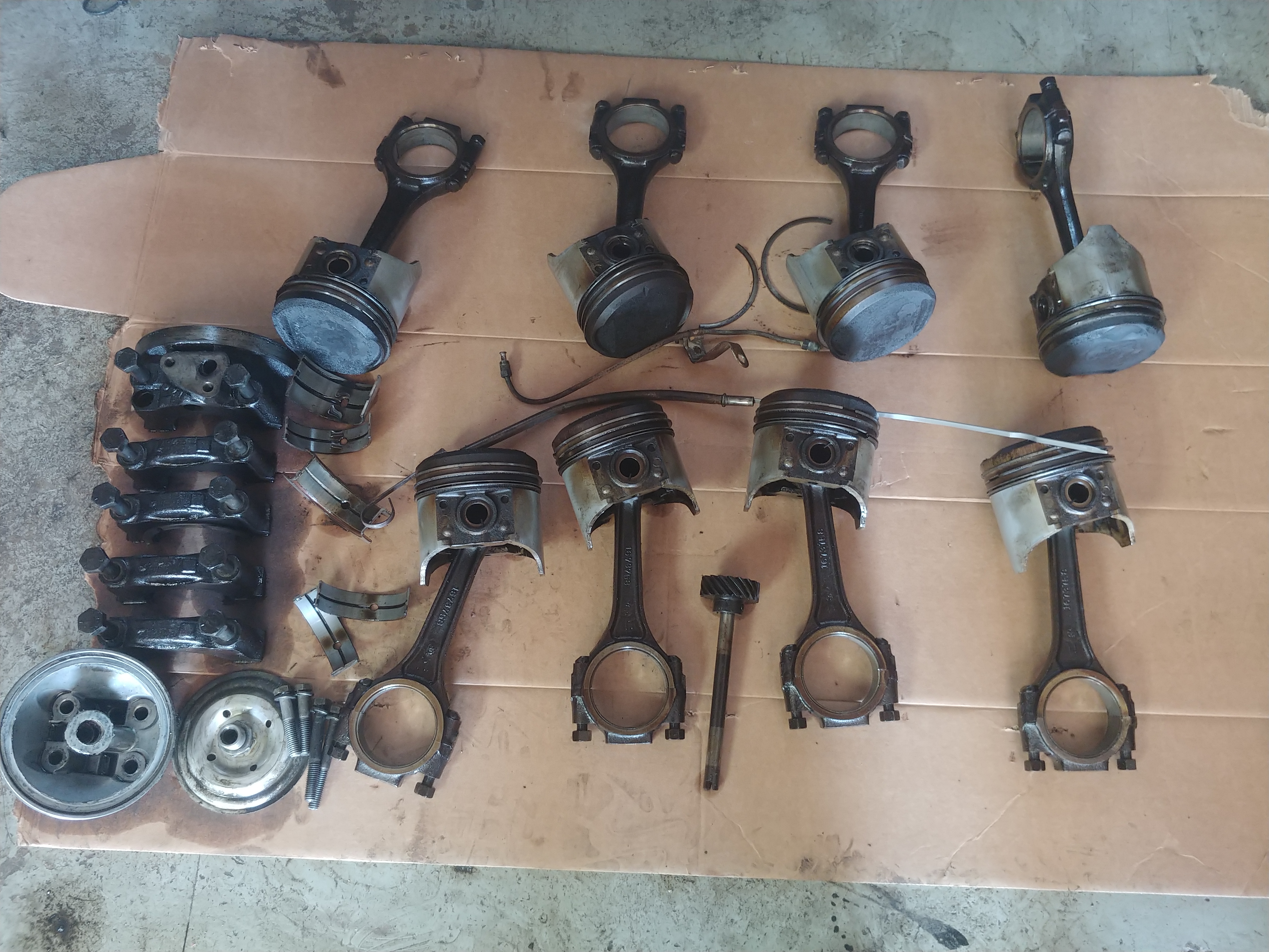

Some pictures of the engine tear down.

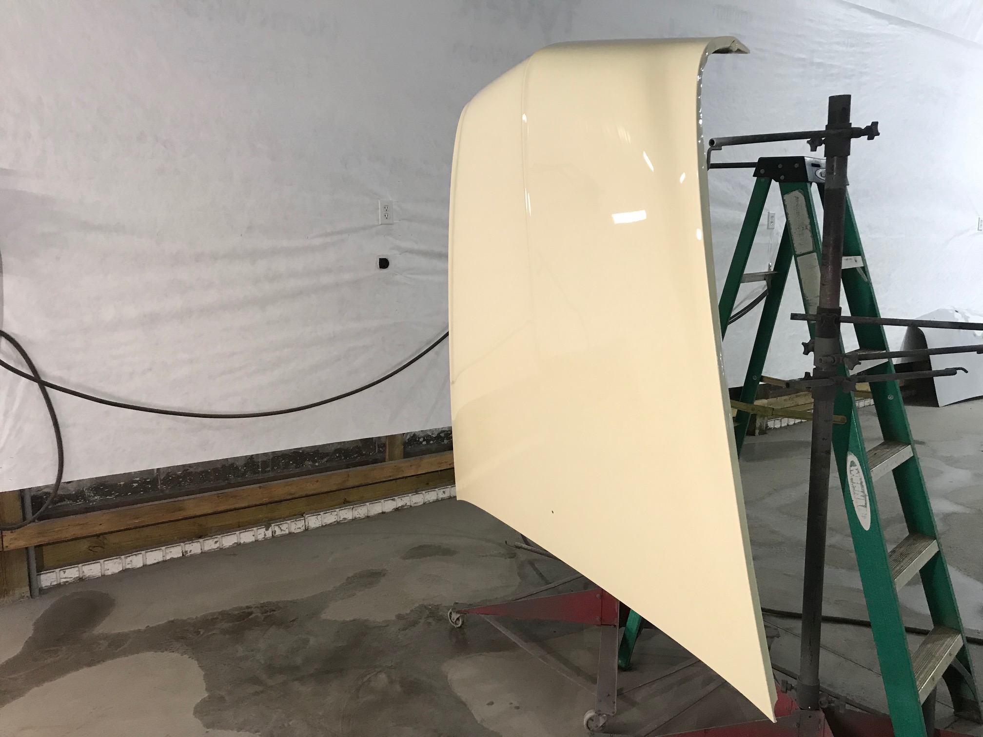

Hood repainted due to fire damage.

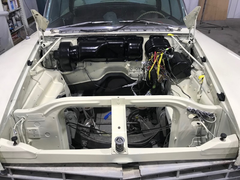

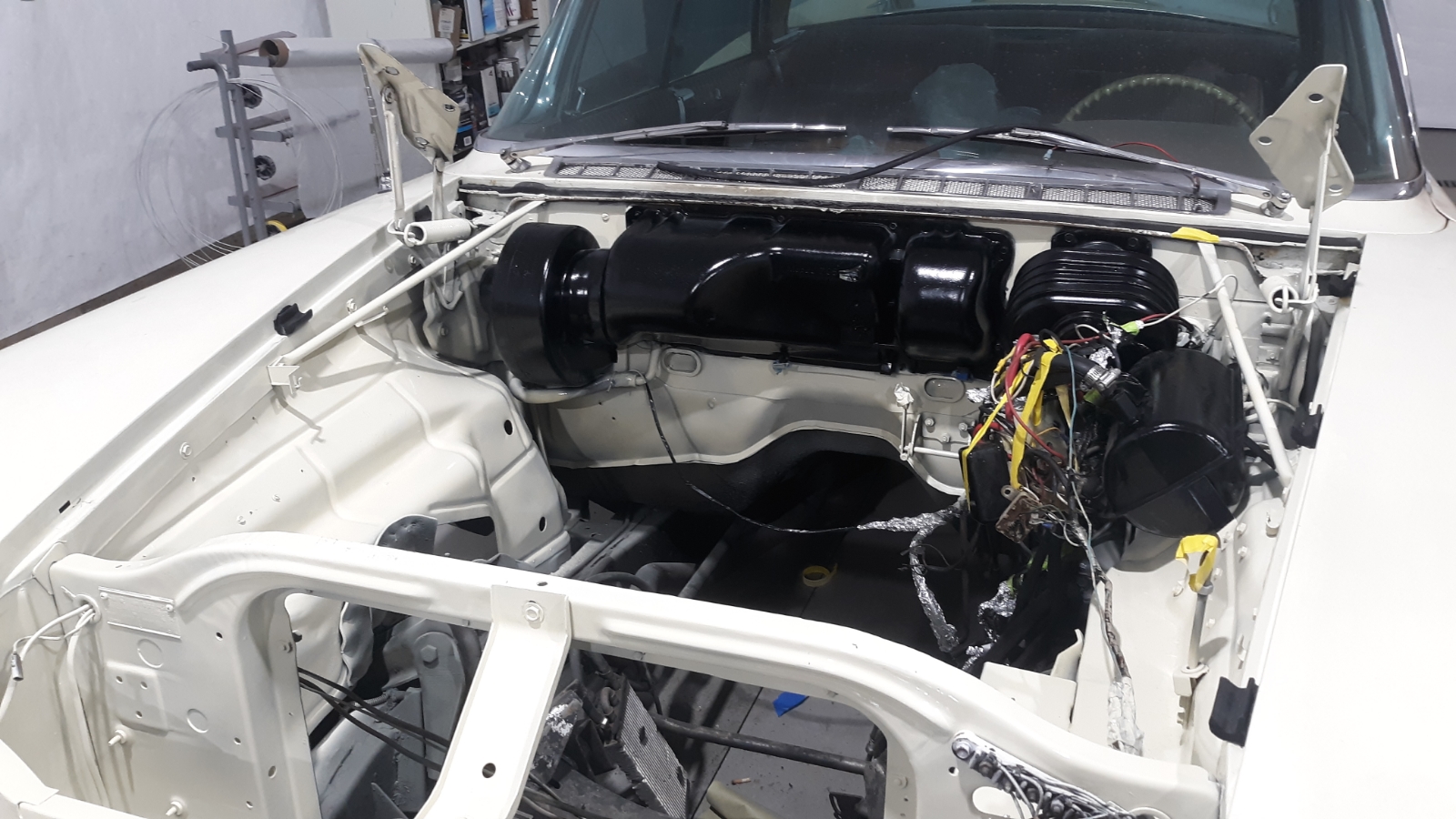

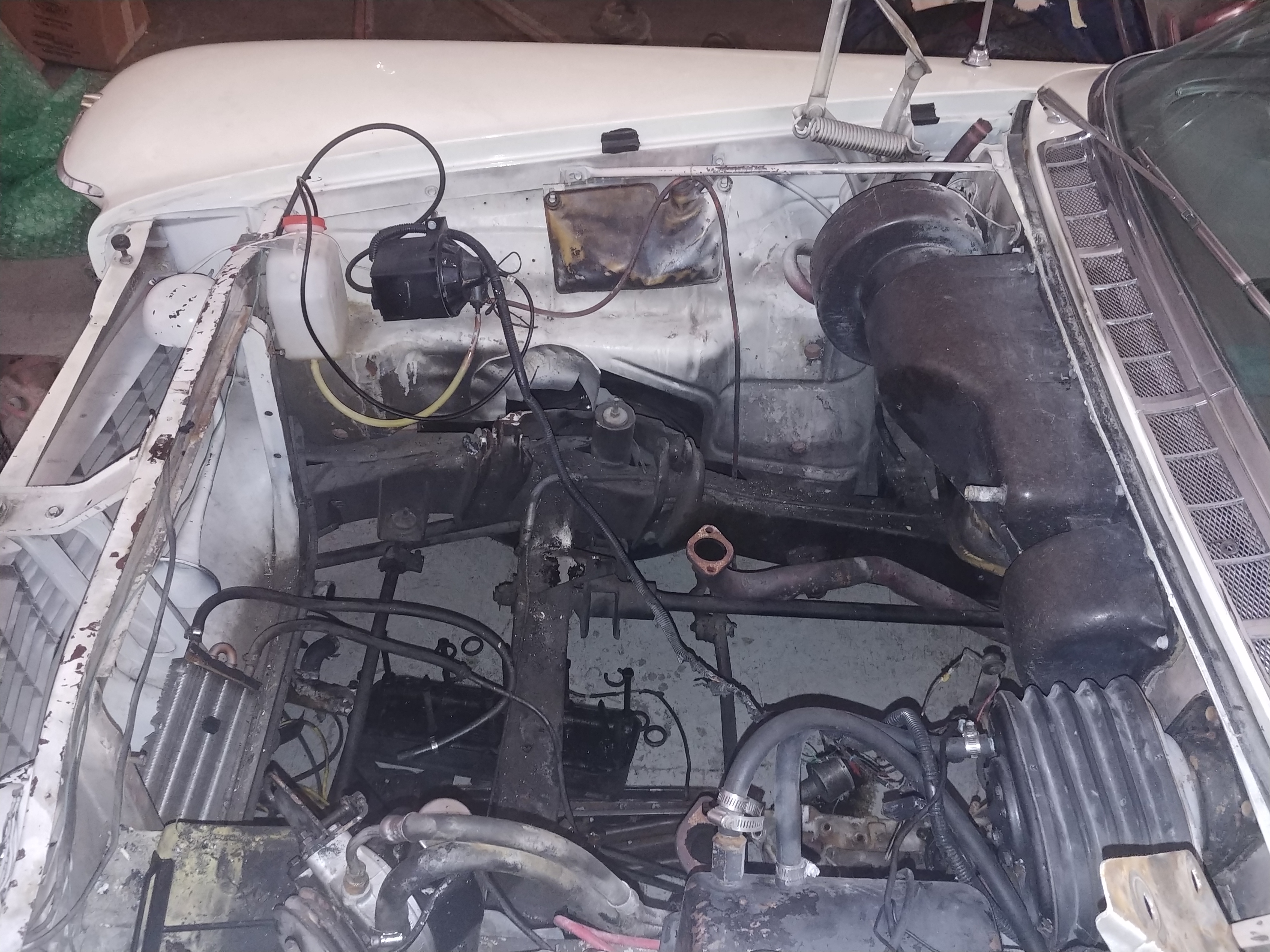

Painted engine bay...

Small update - the shop let me know that the pistons did not fit as they should and were just a little off on size. The guy said he never has cut corners before and isn't doing it now, so he shipped the pistons back, the manufacturer admitted they were not perfect and he got a whole new set delivered on Friday. Hoping the new set are perfect and we can get this wrapped up.
They finally got back to me on the cost of rebuilding the trans, and depending on how bad it is, it will be anywhere from 1000 to 1500. I do not know the going rate of these trans, but that seems reasonable to me, so I told them to go ahead as the trans was slipping and not kicking into 2nd gear when it should. As insurance will not cover the trans, that cost will be on me.

Chryslerdon
Joined: Sun Mar 08, 2020 7:09 pm
Re: 57 Engine Rebuild
Post by Chryslerdon »
Their first mistake was removing the transmission and torque converter together. The trans is removed from the bell housing, and the bell and torque converter are removed later. This is all spelled out in the service manual. The converter nose is not long enough to properly support it. I rebuild a lot of these and have seen many pumps and front components ruined by trying to install a trans that way. The price he quoted is reasonable, depending on parts. Pumps are very hard to come by, so you may have only one shot at this.
