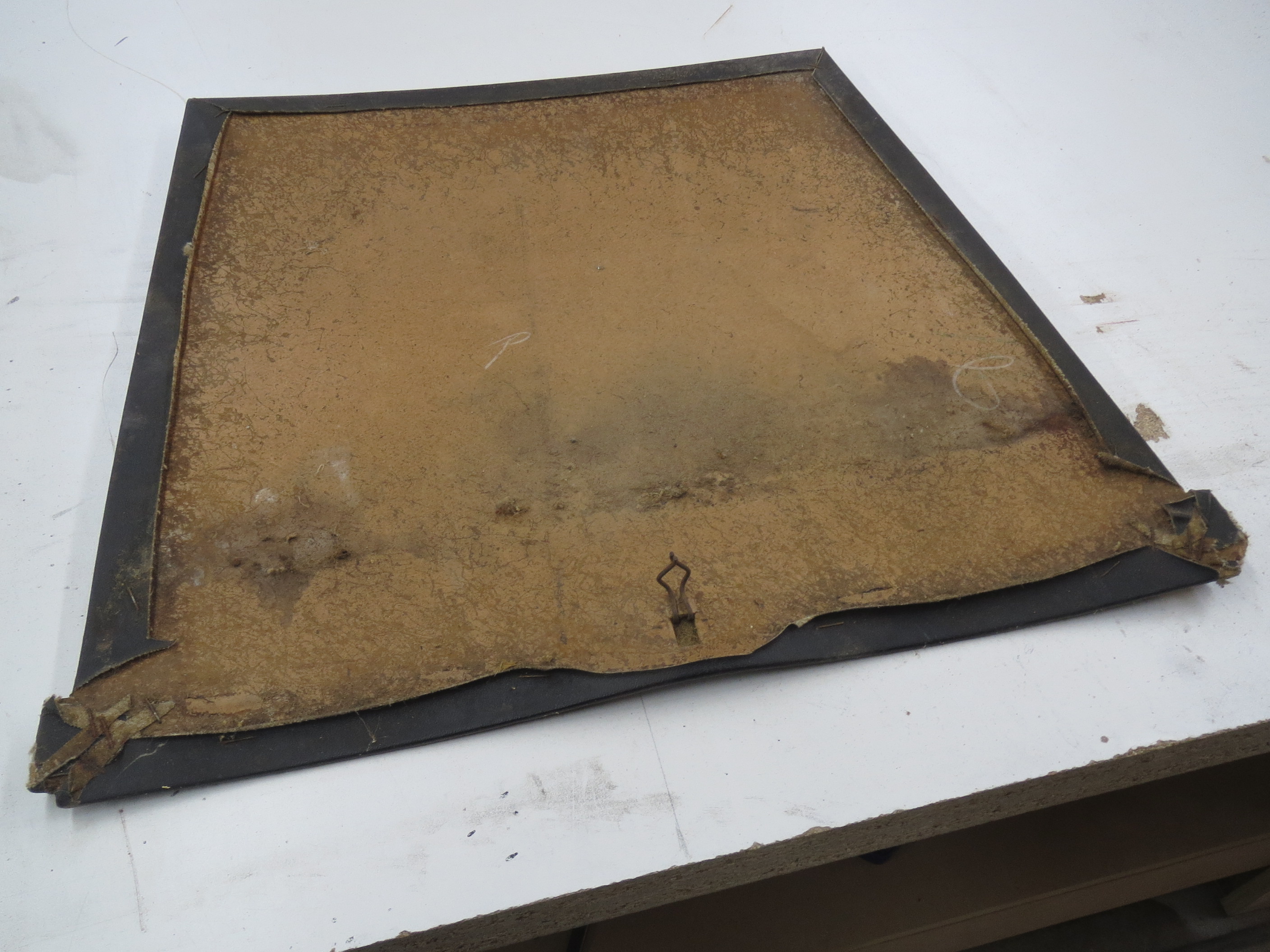

They slip under the chrome channel and tend to bunch up at the top, where it narrows. The bottom has a clip(s) to hold it on (if I remember correctly). Try to smooth out the top and get it to slip inside the channel completely, then it should be held in by either screws on the bottom or clips. Its been a while and my car is in the shop, so I'm a bit vague on the means of attachment-but sure about the problem of interference at the top. Good luck.

It’s all about the clip at the bottom.

That's one beautiful seat-back; no warping, no wear in the clip area, and the top edges have not been crimped. Perfect!
Re: Hard Back covers on 66 seats
Sometimes when they get recovered, They do not fit the same.

I guess; upholsterer may not have an idea of where fitment is critical.

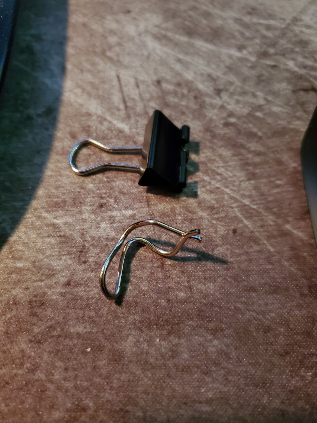

Matt - thanks for the picture. Finally got around to working on it after it has fallen off about 20 times.
I used a binder clip to create a new seat back clip. Taped it onto the back of the seat where the other one was missing. Seat back went right on and the newly rigged clip snapped in place. Not sure if my tape is going to hold, will let it go for a few days and see... if not I'll probably use some hefty duct tape or something.
Here's a picture of what I made. It's not perfect, and might need to add a few more bends to make it work properly, but the back of the seat is damaged some, so I don't think I'll be going without some form of tape involved.

I have a mason jar full of those clips. I’ll send you a few in the box with your literature.ImperialAtom wrote: Sun May 24, 2020 1:14 am Matt - thanks for the picture. Finally got around to working on it after it has fallen off about 20 times.
