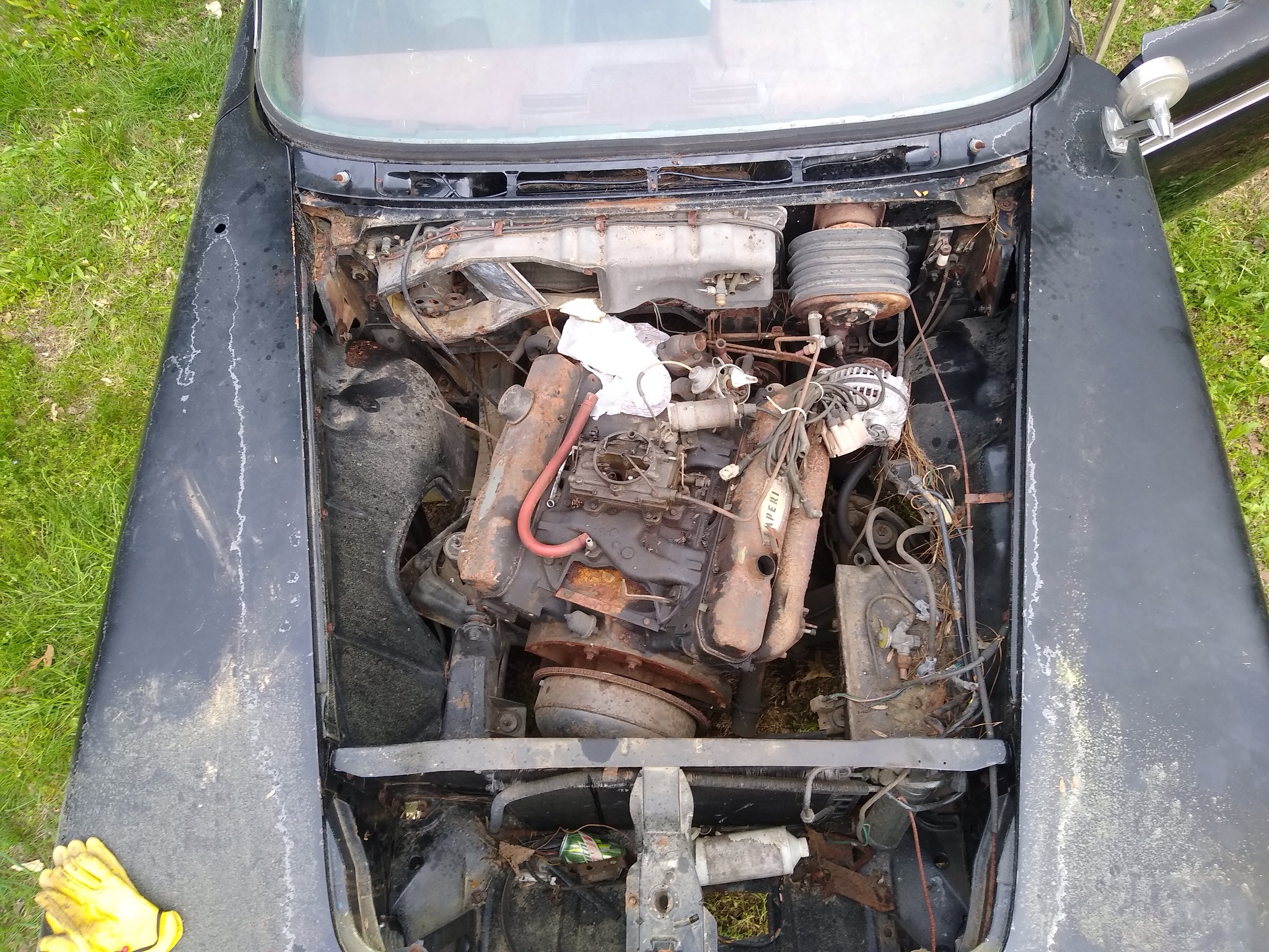

An overall inspection of the engine shows some potentially disappointing news. When I bought the car I discovered the engine was crudely thrown in the bay backwards and crooked. Unknown to me the engine has been sitting for an unknown amount of time with no spark plugs. There is oil in the engine and it doesn't seem to have any water so I'm hopeful in some respects and upset in others. Any other advice for freeing it up would be helpful.

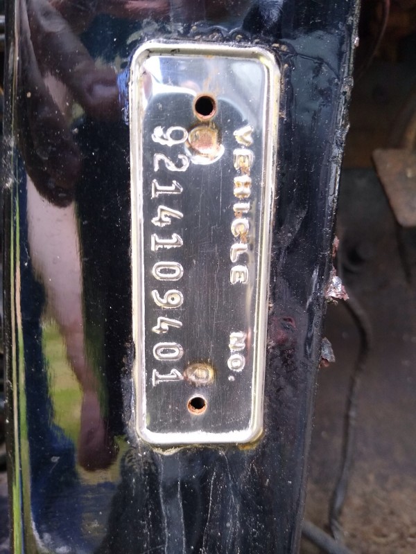

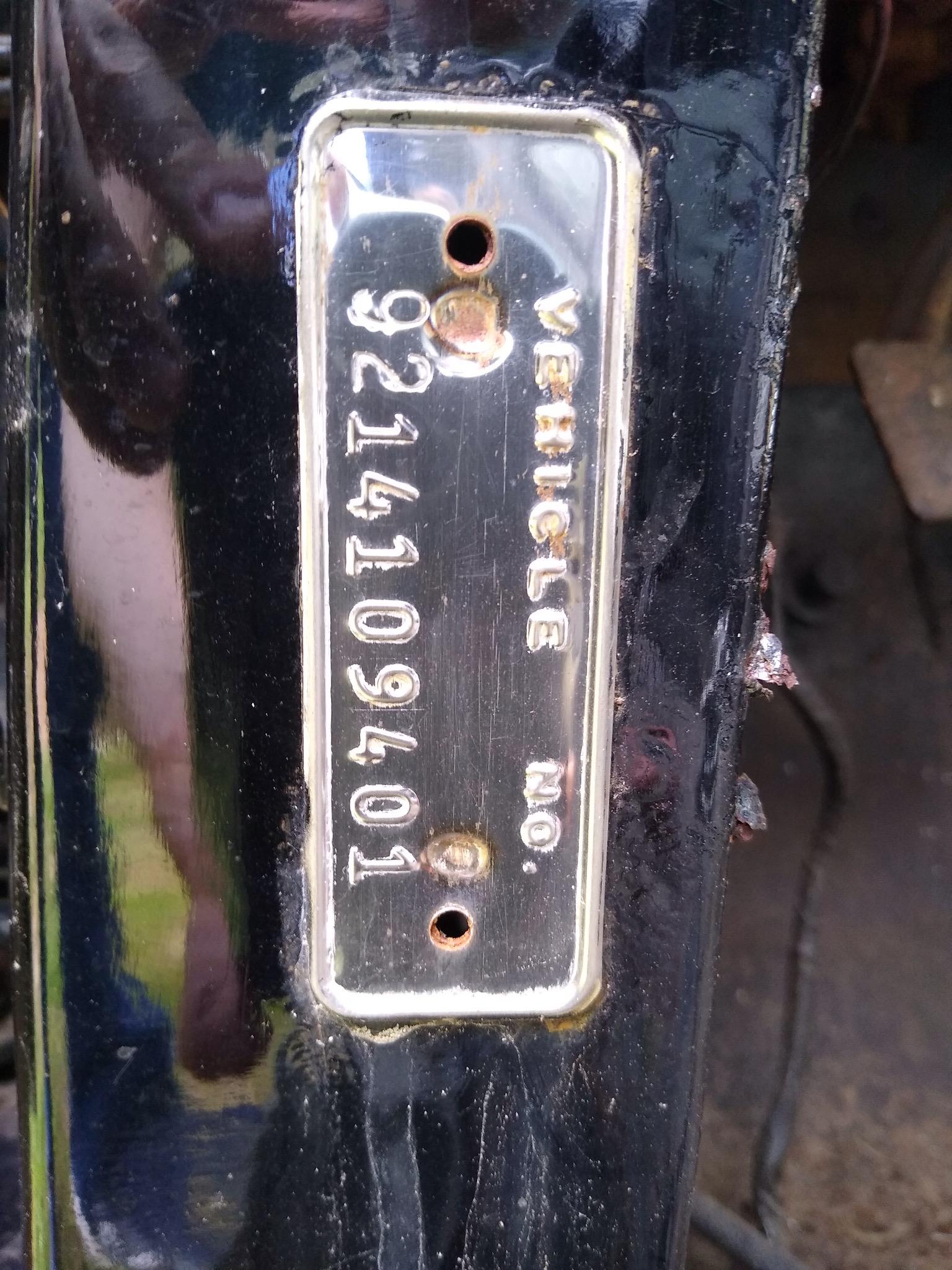

Here are some pictures! It's quite a mess as you can see. Also, can anyone decide my vin, I don't have a data tag so I was wondering if anyone could tell anything by this number.

The VIN doesn't have much data in it. Looks like yours is a 1961 Crown made in Warren Ave in Dearborn Michigan plant with assembly number 9401.
Here's the decode details for the 1960-1965 Imperial VINs:
Digit | Values | Meaning |
1 | 9,y | Make (9=Imperial (1960-1964), y=Imperial (1965) |
2 | 1,2,3,9 | Series (1=Custom, 2=Crown, 3=Lebaron, 9=Custom Crown (Ghia) |
3 | 0-5 | Model year (Last digit of the year) |
4 | 4,3 | Assembly Plant (4=Warren Ave, Dearborn Michigan, 3=Jefferson Ave, Detroit Michigan) |
5-10 | 100001 and up | Sequential build number for the car staring at 100001 and going up (100001 is the first car produced for the year) |

Just so you know the engine is in backwards ! LOL

61Imperial - What I think would be impressive is if you could somehow get that car running with a backward engine.
Now THAT would be a car worth showing off!
