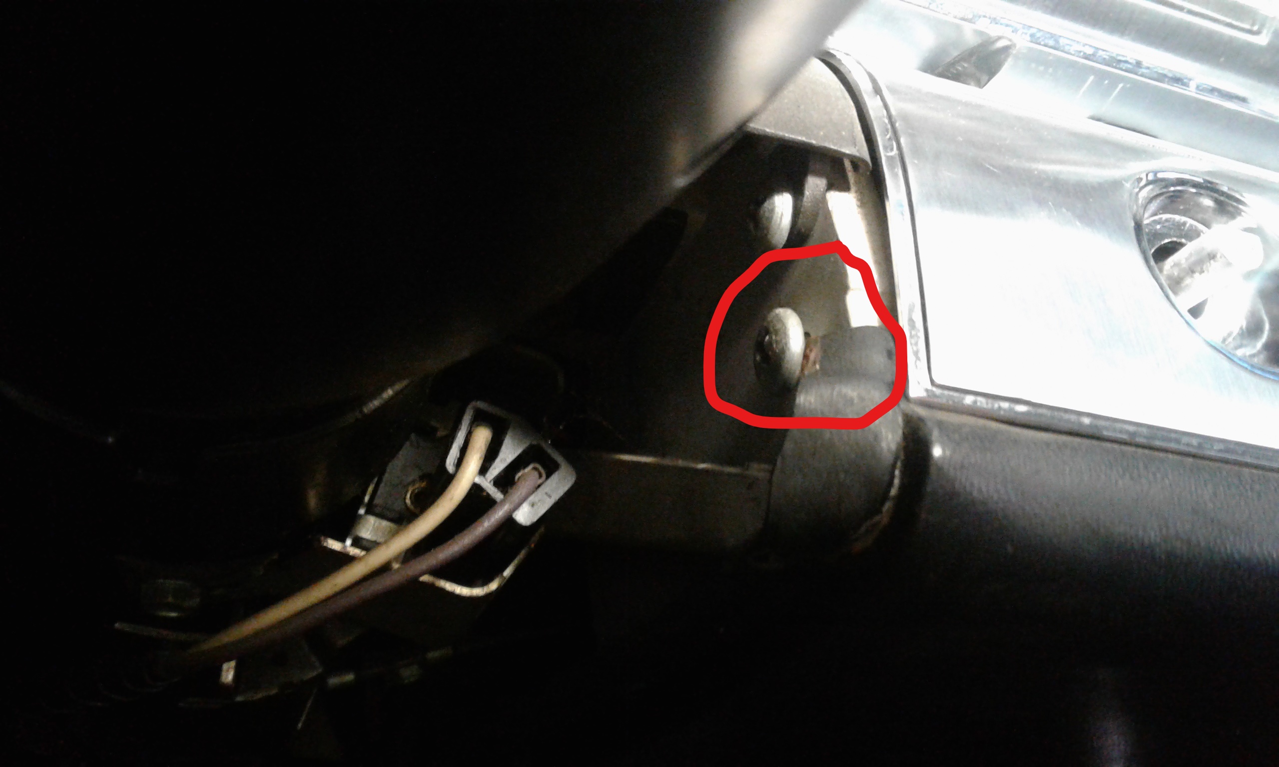

Under steering column panel
This panel needs to be removed to reach a screw that holds the panel of the switches in place as seen in the next picture.
Side screw
Side screw
The side screw sits in the hole of the front switch panel.

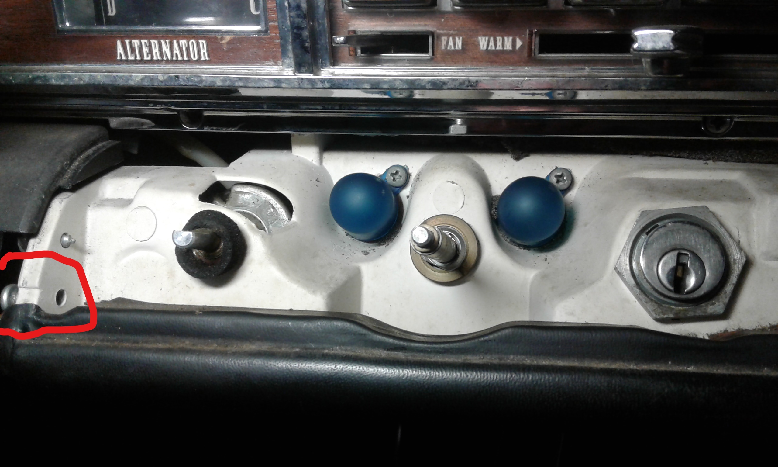

Here is the dash without the panel and knobs in place. You can see where that side screw comes through to hold the front panel.
